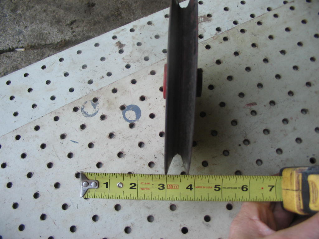

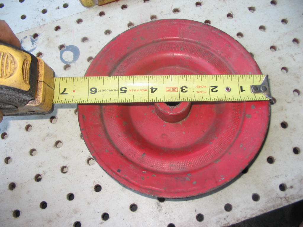

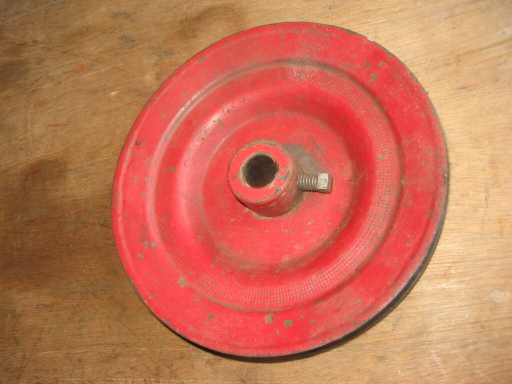

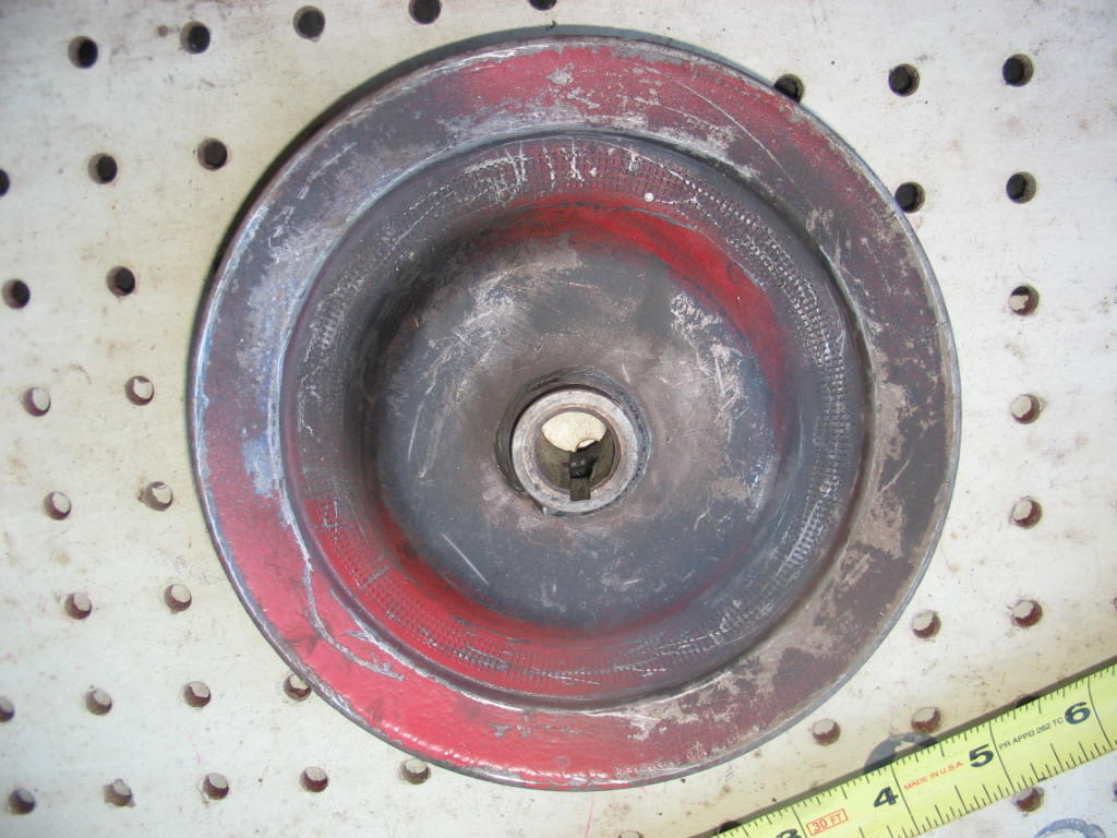

daveoman1966 3,788 #1 Posted June 16, 2022 Need a little help here. I know this is Toro/Wheelhorse trans input pulley, but can't figger out the part # or what trans it fits. It is about 6-1/4" diameter with a 5/8" bore. Belt is likely 5/8" width. Any help on this??? Share this post Link to post Share on other sites
Lee1977 6,989 #2 Posted June 17, 2022 I think it's a 106165 fits 8 speeds with 1" axle 312-8 , 1988 , 1989, 1990 models. Looks just like the one on my 312-8. That's my guess they had a different number for 1987 and 1991 models. Share this post Link to post Share on other sites
Lee1977 6,989 #3 Posted June 17, 2022 Also 310-8 same years 308-8 1988 and GT1600. Share this post Link to post Share on other sites
