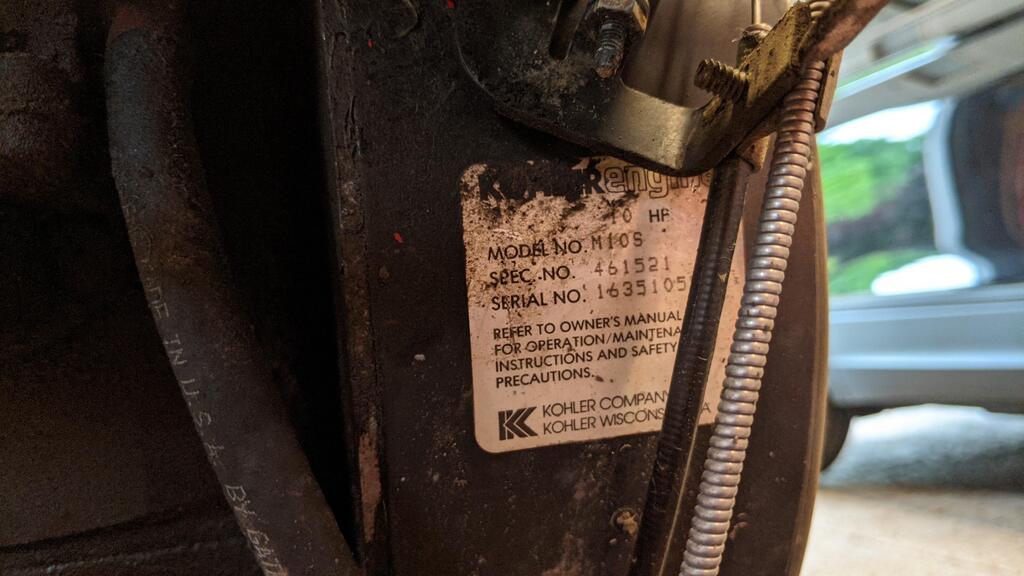

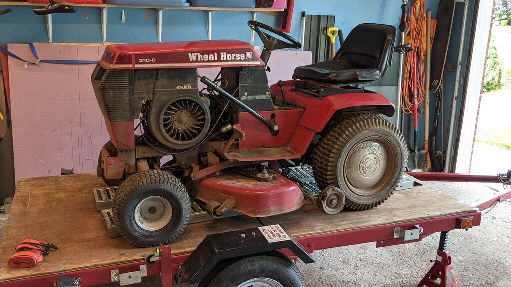

BigDaddyO 11 #1 Posted June 14, 2022 Hello, I just picked up a non-working Wheelhorse 310-8 from I think 1986. I've never used a riding lawnmower and got it as a project to tinker with. It was $200 and has a new carb, rebuilt starter, new battery, new front wheels, new mower blades. After cleaning out the fuel tank, replacing the cracked fuel line and put in a new clear fuel filter I got it to start today but it's running REALLY rich so i've got some carb tinkering to do. I'm going to have some more questions about this but I guess I'll keep those for the main forum. Mike oh, here are some Pic's 7 2 Share this post Link to post Share on other sites

gwest_ca-(File Mod) 11,206 #4 Posted June 14, 2022 Welcome to Red Square The M10S-461521 was used 1987-1991. 1990 and 1991 had black background hood decals Kohler made the engine in 1986 so most likely a 1987 model 21-10K804 3 1 Share this post Link to post Share on other sites
