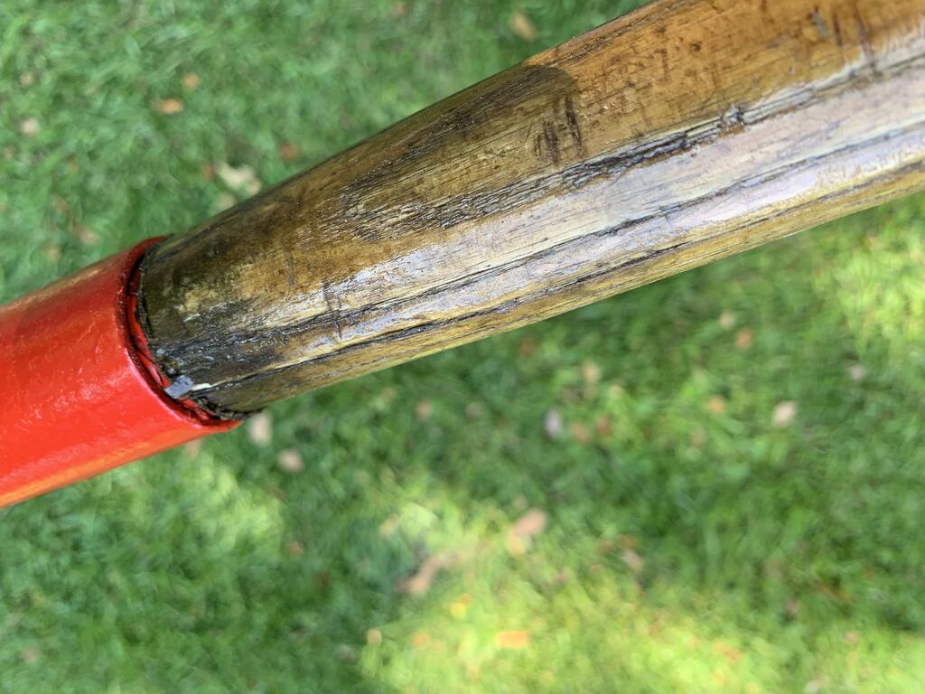

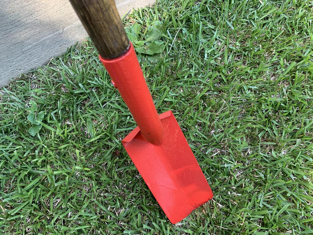

Horse Newbie 7,194 #9 Posted June 13, 2022 (edited) 1 hour ago, cschannuth said: We keep all of our tools inside and that probably helps as well. I think keeping the tools inside and dry is the biggest factor. After I use any earth altering tool, I clean/ wash it and hang it up inside to dry… Here is a example of a ditch spade that I restored… Edited June 13, 2022 by Horse Newbie 4 1 Share this post Link to post Share on other sites
