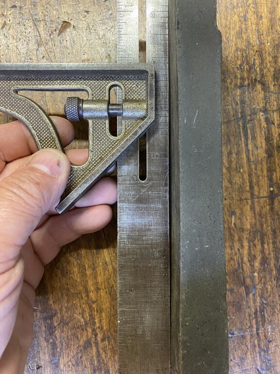

First they should always have some type of enclosure to keep them from hitting other things and getting chipped or broken. Dust collecting on them is also not a good thing. Caked up dust will clog them preventing them from cutting. Most stones are rectangular in shape but some will be round. A whetstone is a precision tool and a reference for the tools it sharpens specially chisels and plane blades. It must be absolutely flat and straight both across and throughout its length. Corners must be sharp and free of chips .

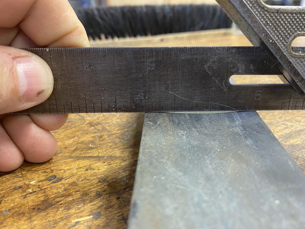

 Undoubtedly many of you have come across or own stones that are hollowed out along its length  from wear. This is prevalent with man made stones which are always softer. Such a stone will actually ruin a chisel or plane blade by creating a rounded edge and worst ruining the back of a chisel which is the most important part if it. Said stone needs to be flattened out by grinding it on a flat steel or glass plate using compounds or some specialized sandpapers. That condition can actually  be avoided by concentrating substantial more time on edges of stone while using it rather than in the middle of it. There are specific techniques while using them to maintain them flat. I will speak about that later.

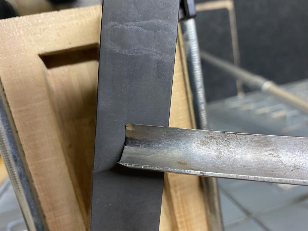

 When sharpening narrow tools such as a 1/4” chisel for example there is always the possibility of rocking the tool and gouging the stone. Narrow tools like that can and should be done on the edge of stone if possible. That is where the 1” thick stone comes in real handy. Also when doing a carving gouge which will be rocked side to side it is best to use edge of stone.

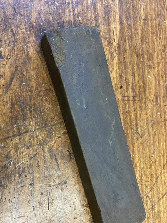

 Edges of stones are important. They should be sharp and crisp without nicks or chips. There are a few tools suck as 45 degrees parting tools and corner chisels that have to be honed riding with one wing off stone . A sharp edge will permit honing it right up to the very corner of tool.

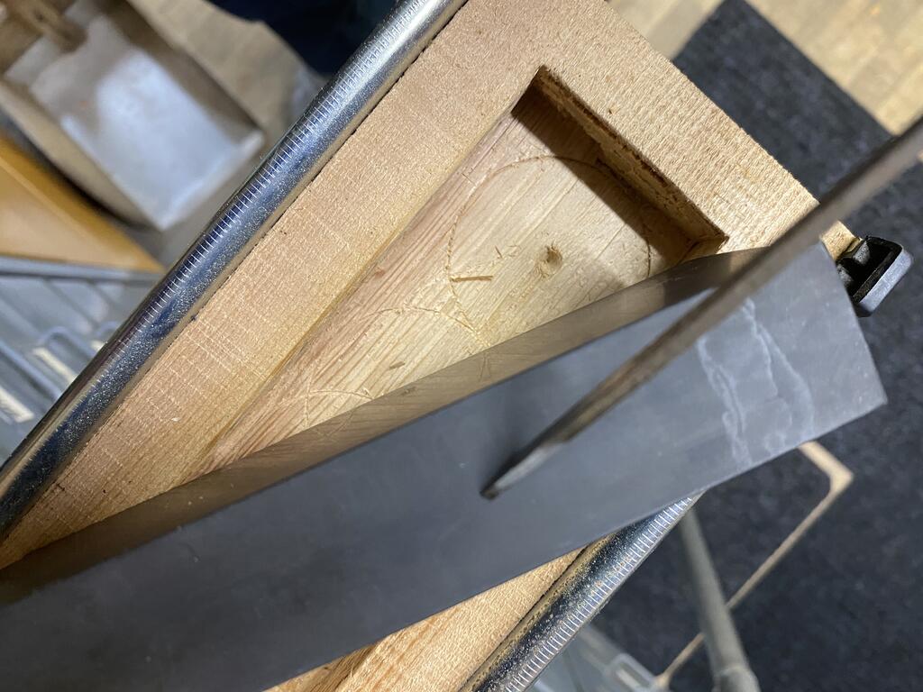

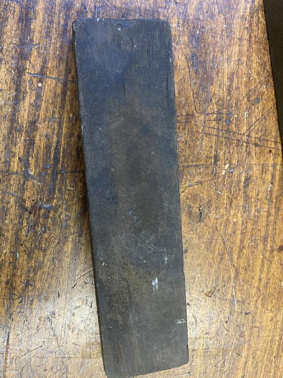

  Stone cupped in both directions.

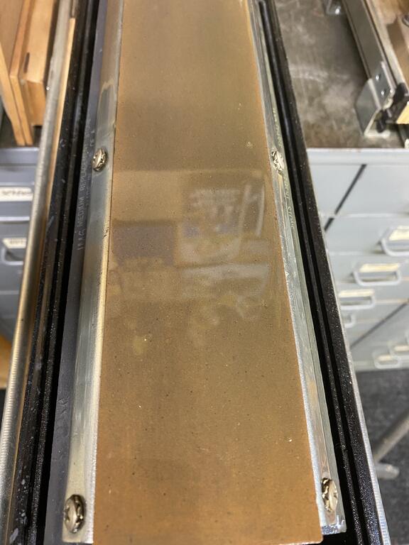

 Clogged-stone from dust and letting lubricant dry on it.

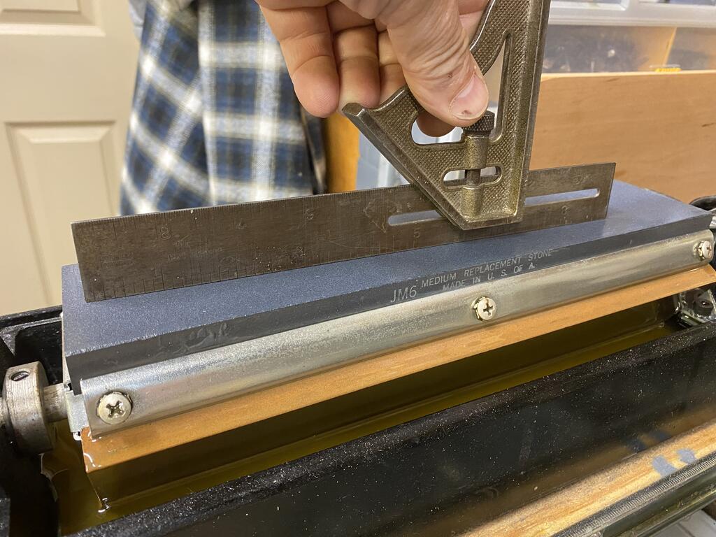

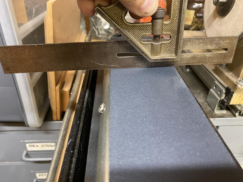

 Examples of properly used, maintained, and stored stones. The “newest” ones have now been used for over 25 years and used several times per week.
Important to keep them wet while in use and not just a little wet.

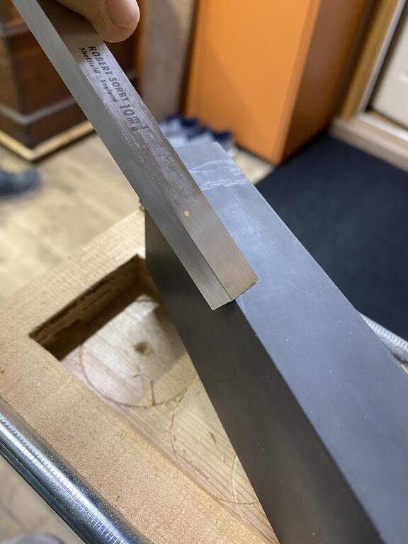

 Narrow tools or tools that are rocked while honing best done on edges

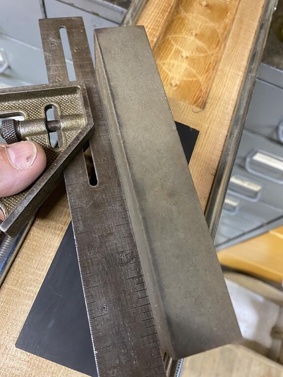

Importance of flawless edges
