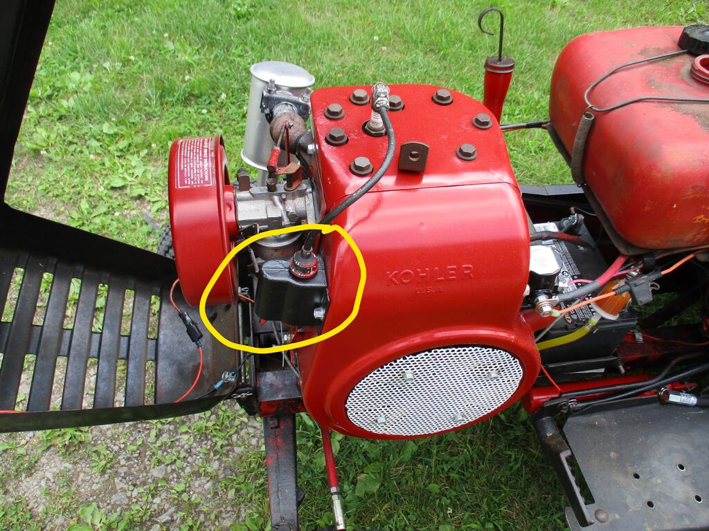

I got the tractor from a guy on Craigslist pick it up it ran good but it started to back fire and skip I got a new carb and went to find the model number couldn't find it then I see a tag on engine pulled it off the guy before me had painted every thing so much paint couldn't find nothing all I can see on tag is 301-s and a number across from that number is E0029795 and below that is 47340C that's all information I have he told me it could be a 1970 or 72  and that picture of that coil is the one thank you for feed back I just confused of what it is I guess I should have not purchased it o well thank you again  Roy / gireg

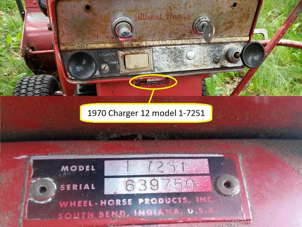

Example of the tractor ID plate. Do you have one for positive ID? If so post the numbers.
