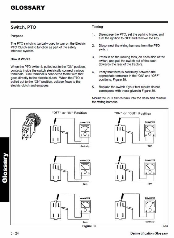

gwest_ca-(File Mod) 11,247 #36 Posted June 15, 2022 Do not know if this is for the 5xi switch part number 95-7489. It is in one of the Demystification Guides but not identified. 1 1 Share this post Link to post Share on other sites
eibbed 63 #37 Posted June 18, 2022 Gentlemen, I have awesome news. My 520xi is up and running!! I finally had a day where it didn't feel like 110 outside. We had a cool front move in for today and tomorrow. 85 degrees. I'll take it!! I received the new PTO switch. Plugged it in and it did not work. I rechecked all the connections to the PTO clutch and VOILA, I found one connection I apparently overlooked. Snapped it back together and it was a Thank You Jesus moment!! The new PTO switch does works so I will put it aside in case I ever need one. I was able to cut my lawn today and it was ready. Hooray!! I have a wonderful neighbor who is seventy and has cancer and he helped me. (He loves to cut grass and he has a John Deere. But I don't hold this against him. LOL!!) I am truly blessed to have wonderful neighbors. And I feel I have found wonderful friendships on this forum. Thank you to everyone for all of your advise and schematic diagrams. I appreciate each and everyone of you. And I feel David is thanking you too! HAPPY FATHERS DAY to all of you!! Debbie 2 Share this post Link to post Share on other sites
