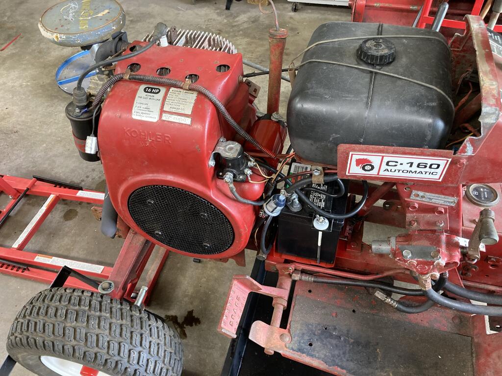

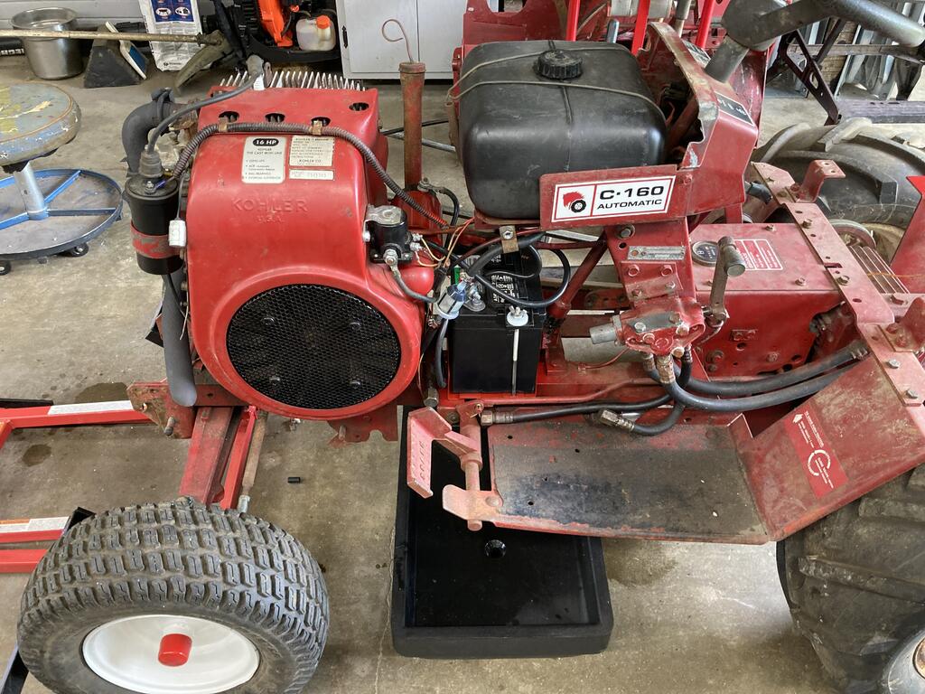

Blasterdad 3,039 #26 Posted July 22, 2022 (edited) Just got her engine all back together today & started her up. One shot of gas in the carb & she fired up instantly & idled like a purring kitten. Took her for a test drive around the yard to warm her up & run her. Transmission is strong & smooth, so far a very happy Horse. Brought her back in the shop & changed her oil, about to go for another ride. I'm going to hate letting this one go.... Edited July 22, 2022 by Blasterdad 5 Share this post Link to post Share on other sites
Moparfanforever 874 #27 Posted July 22, 2022 Kohler 16HP , Hydrostat , Hydraulic Lift , doesn't get any better !!! Looks good!! 1 1 Share this post Link to post Share on other sites
c-series don 9,445 #28 Posted July 23, 2022 Does the hour meter work? 1 Share this post Link to post Share on other sites
Blasterdad 3,039 #29 Posted July 23, 2022 14 minutes ago, c-series don said: Does the hour meter work? It does now, I hooked it back up when I checked out all the wiring & hydro controls. I have no idea if this tractor only has 40 hours on it but it sure runs like it does! Owner said it had been rebuilt, but either way it runs like new. Like I said, gonna have seperation anxiety seeing this one go to her new home, Lol. 2 Share this post Link to post Share on other sites

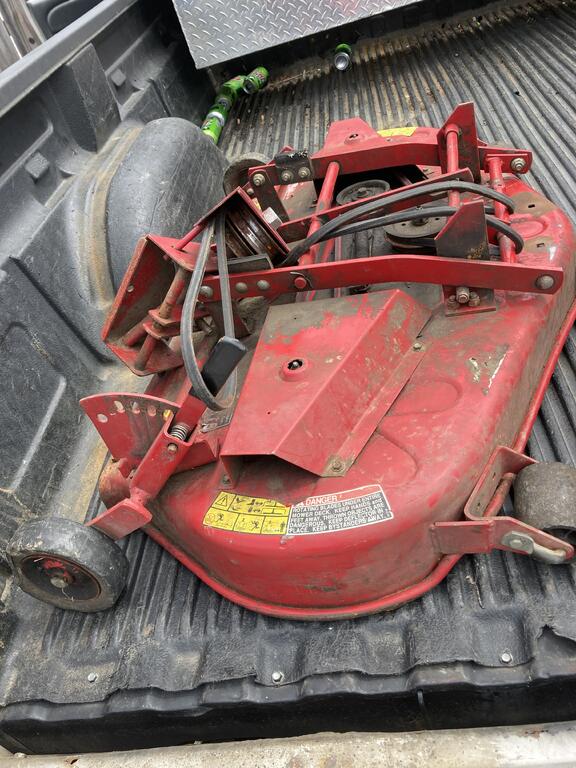

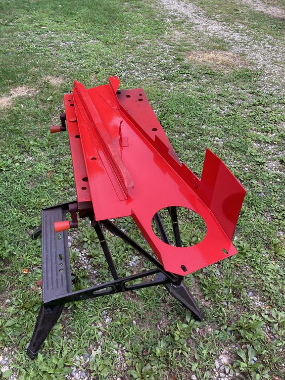

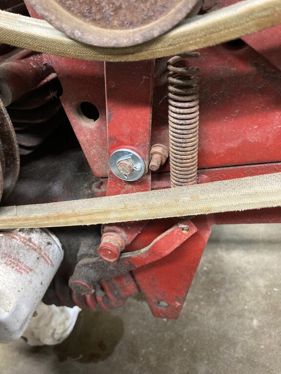

Blasterdad 3,039 #31 Posted July 25, 2022 I got slowed down this morning in a good way, made a short trip & picked up this beauty. 1995-96 42" Rear Discharge deck, great shape, hardly been used, just dirty. I've had my eye out for one for a while & finally got lucky. Last on the list is a 60" & I'll have every size deck made. I did manage to get a little done on the C-160, tightened up the parking brake lever with a new cotter pin & washer, (old one was easy to get out, it fell apart when I touched it, Lol). Primed & painted the belt cover, will let harden a few days while I replace axle & stub shaft seals. 4 Share this post Link to post Share on other sites
ineedanother 1,411 #32 Posted July 25, 2022 Nice find on the deck and the belt guard looks like it's in great shape too! 1 1 Share this post Link to post Share on other sites

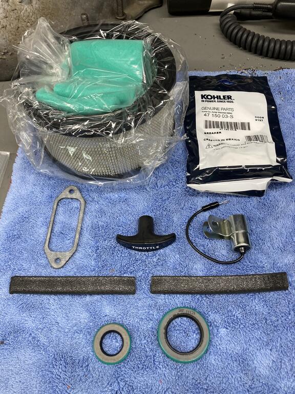

Blasterdad 3,039 #33 Posted August 16, 2022 Getting closer, down to the details. They say money can't buy happiness.... Then how do you explain NEW PARTS !!! ( & ice cream ). 3 1 3 Share this post Link to post Share on other sites
Handy Don 13,340 #34 Posted August 17, 2022 16 hours ago, Blasterdad said: NEW PARTS YES! 1 Share this post Link to post Share on other sites

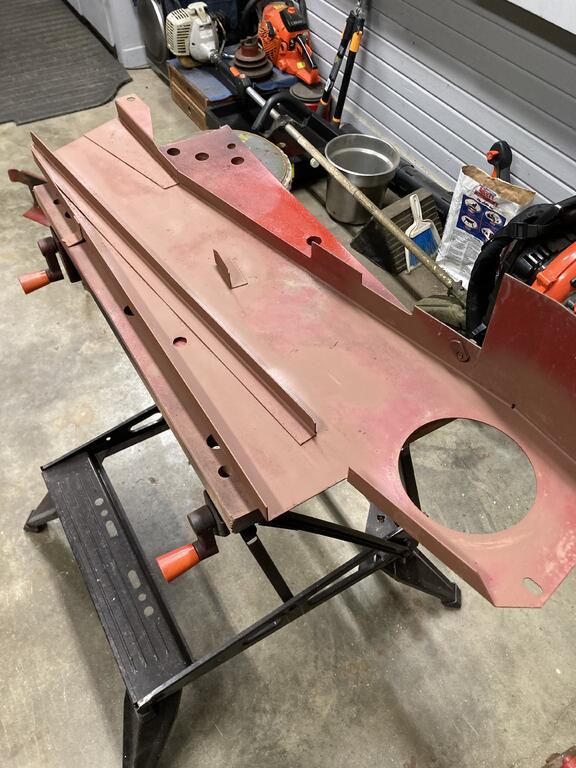

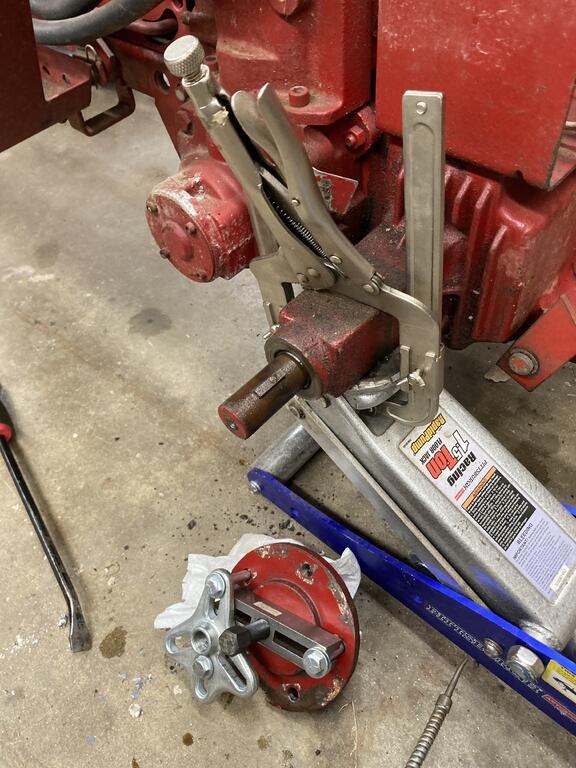

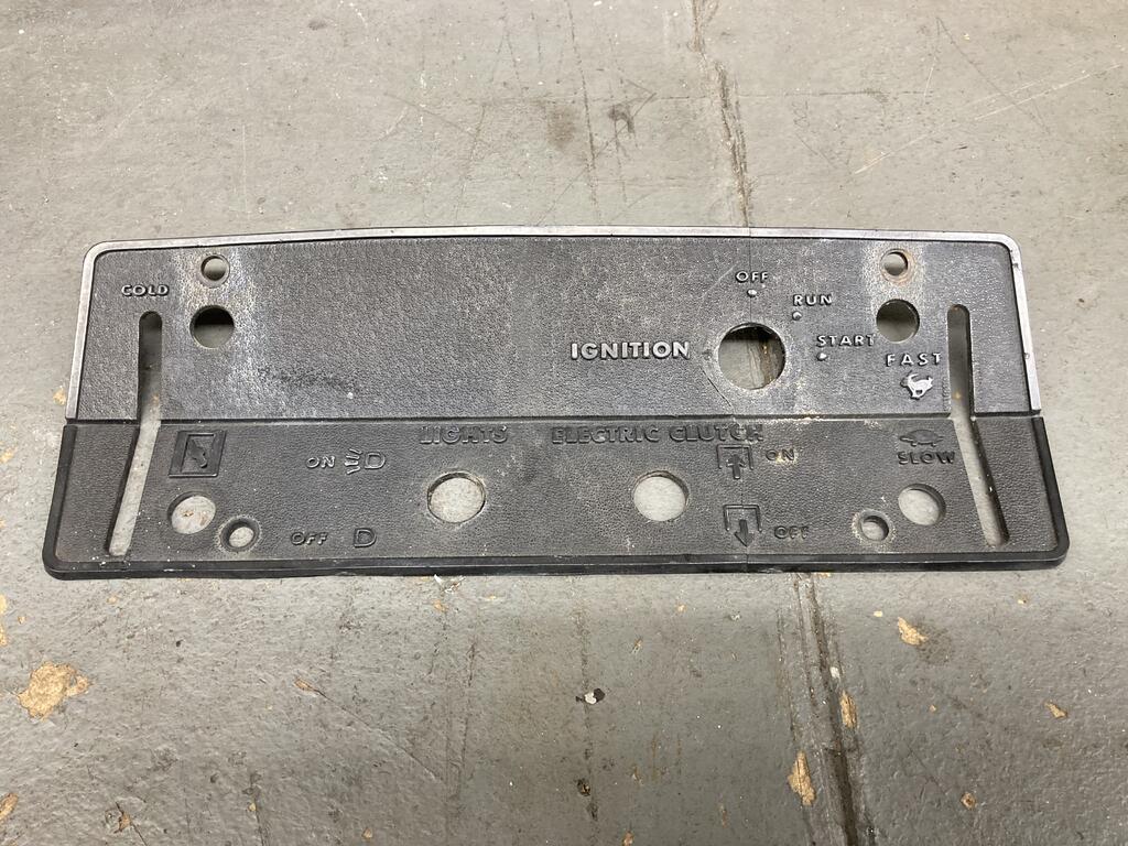

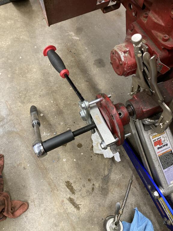

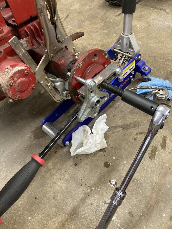

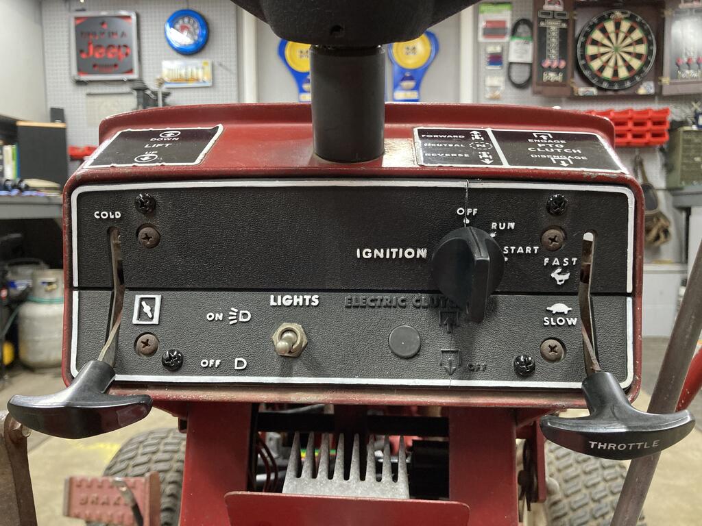

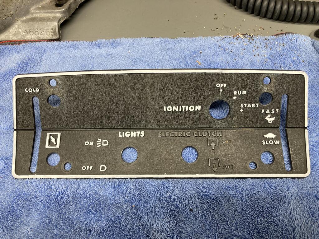

Blasterdad 3,039 #35 Posted August 19, 2022 Pulled rear hub to today to change the seal, I've NEVER had one fight me this hard... It didn't win. After cooling off & a trp to the hardware store for new screws I put the dash plate back on. It was cracked & I repaired it from the back, then I had my Mother paint it for me, you're never too old to ask Mom for help. Thanks Mom! ( I told her she didn't have to do the electric clutch because it doesn't have one ) 5 2 Share this post Link to post Share on other sites
ebinmaine 70,789 #36 Posted August 20, 2022 23 hours ago, Blasterdad said: NEVER had one fight me this hard I had one took two WEEKS of tightening with the impact wrench, heat, cool, penetrating oil, repeat.. Not sure if it makes you feel any better... 🤪 Share this post Link to post Share on other sites
Blasterdad 3,039 #37 Posted August 21, 2022 4 hours ago, ebinmaine said: Not sure if it makes you feel any better... 🤪 Actually it does, two weeks... WOW 1 Share this post Link to post Share on other sites
ebinmaine 70,789 #38 Posted August 21, 2022 8 hours ago, Blasterdad said: Actually it does, two weeks... WOW Sometimes patience is key. That... And having extra parts. It wasn't a transmission I needed to have done right then. It had time to soak and re-soak. Share this post Link to post Share on other sites
Blasterdad 3,039 #39 Posted August 21, 2022 6 minutes ago, ebinmaine said: Sometimes patience is key. I agree, but in my mind this hub had given me the middle finger & told me to go urinate up a rope. When inanimate objects talk back to me it's on & poppin'. I was patient with the SpeedEx though, it took about 2 weeks to free up the steering column, but that was understandable, poor girl had sat outside in the rain for years. More of a "Help Me" conversation... 1 Share this post Link to post Share on other sites
ebinmaine 70,789 #40 Posted August 21, 2022 26 minutes ago, Blasterdad said: in my mind this hub had given me the middle finger & told me to go urinate up a rope. When inanimate objects talk back to me it's on & poppin'. I've definitely been there. I was told many years ago that in order to succeed in life we must be more intelligent than the object we are trying to conquer. Hence... I am regularly defeated by cardboard. 1 1 1 Share this post Link to post Share on other sites
Blasterdad 3,039 #41 Posted August 21, 2022 2 minutes ago, ebinmaine said: I am regularly defeated by cardboard. Humility is another trait that helps us succeed in life! Great reply, love it! 1 Share this post Link to post Share on other sites

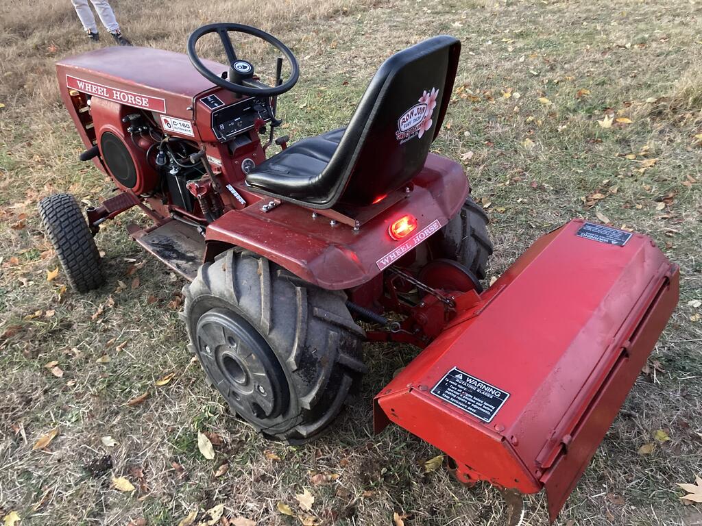

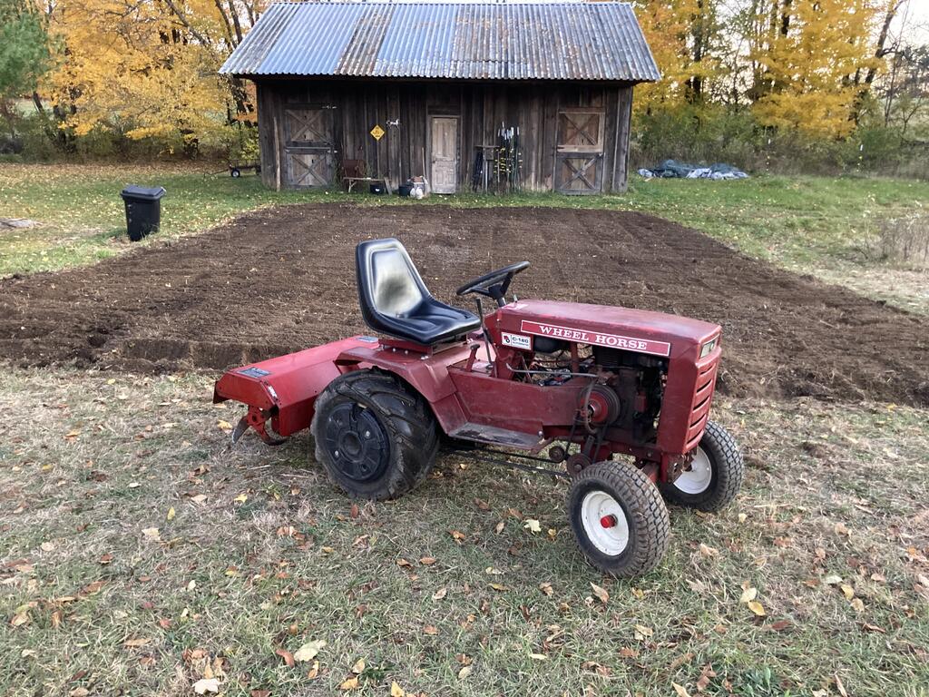

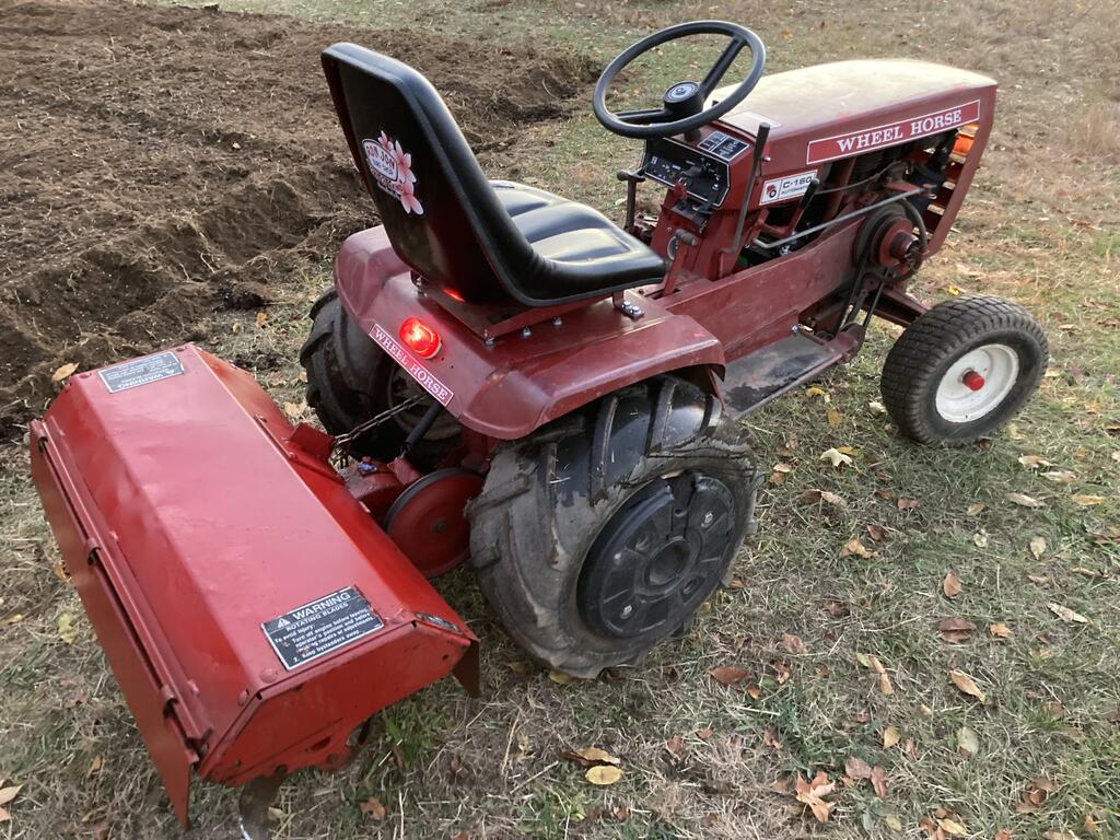

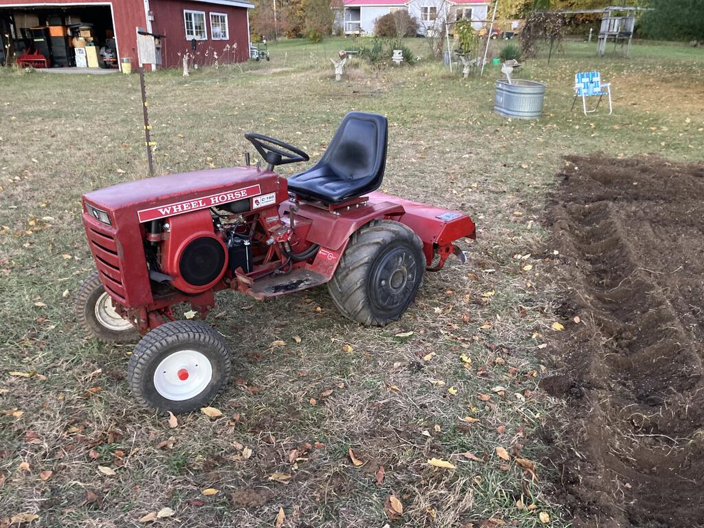

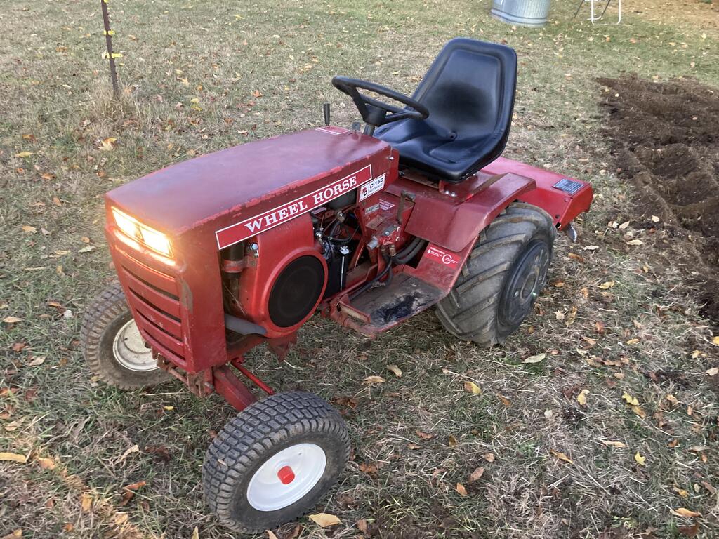

Blasterdad 3,039 #43 Posted October 23, 2022 Done & delivered to her happy new owner. She got to kick up her heels in the garden today, didn't even break a sweat, runs & tills like new! 2 12 Share this post Link to post Share on other sites
ebinmaine 70,789 #44 Posted October 23, 2022 NIIIIICE!! 1 Share this post Link to post Share on other sites
peter lena 9,092 #45 Posted October 23, 2022 @Blasterdad not only nice , but the crisp / bright lights indicate a good ground , like the patina retaining look , maybe a lubricant rub down ? been experimenting with cnc 2-26 electrical aerosol as well as mineral oil on my paint , both safely retain paint , even did my CENTRAL AC , unit outside , spray it down , let it soak , clean cloth rub down , looks very good for 35+ years old , pete Share this post Link to post Share on other sites
Blasterdad 3,039 #46 Posted October 23, 2022 8 minutes ago, peter lena said: not only nice , but the crisp / bright lights indicate a good ground , like the patina retaining look Thank you, headlight bezel grounded directly to frame. I wanted her to retain her patina too, rubbed her down with WD. 1 Share this post Link to post Share on other sites
peter lena 9,092 #47 Posted October 23, 2022 @Blasterdad , typically that frame grounding is corroded or painted over , since adding a ground cable to my battery ground cable bolt point and then to engine / frame corner , that has eliminated electrical issues . keep it sparky , pete Share this post Link to post Share on other sites
