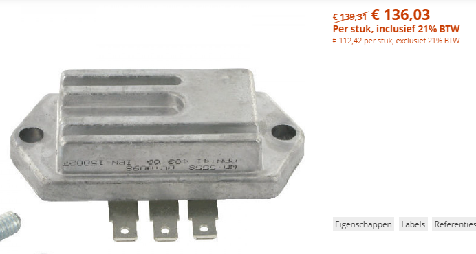

Maxwell-8 4,366 #1 Posted June 7, 2022 (edited) I have this Kohler M16. sweet runner, right on 160psi of compression. It makes AC, but doesn't make DC. That means a bad voltage regulator no? Which one do I need? And can it be my cheapest source asks 150$ for one? Is there pure gold inside them? Edited June 7, 2022 by Maxwell-8 Share this post Link to post Share on other sites

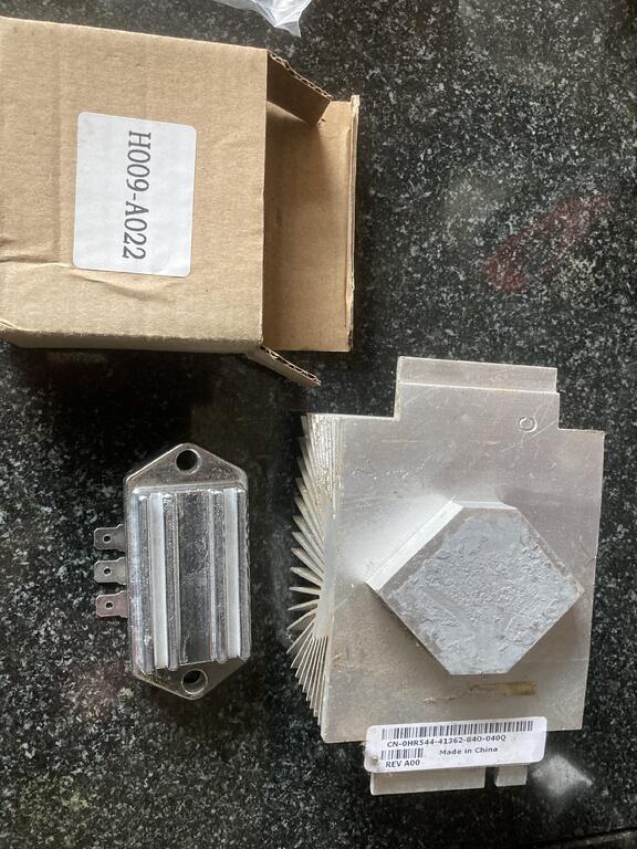

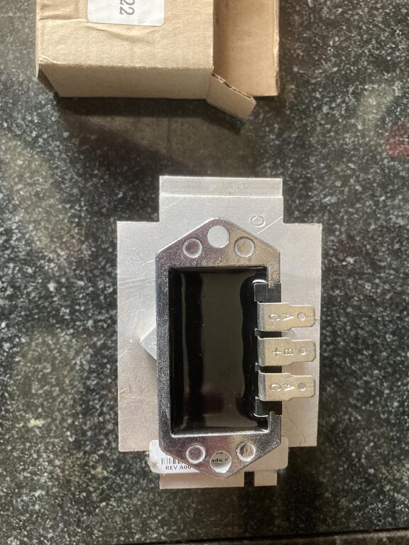

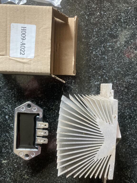

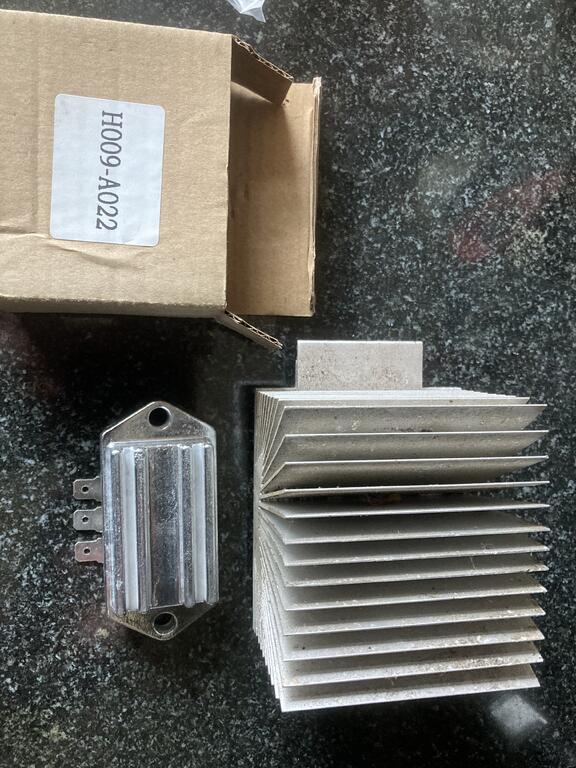

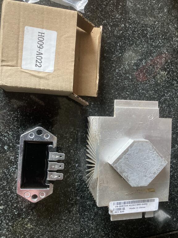

ranger 1,783 #5 Posted June 8, 2022 (edited) I bought one of the ‘cheepo’ ones off ‘the bay’, for my Raider 10. I am going to mill the fins down and a computer cpu heat sink, clamping the two together using the regulator mounting holes, + thermal grease between. This because these reg’s are meant to be in a forced airflow. Only costs a few £’s, so not much lost if it doesn’t work. (Pics to follow). Doug. pics as promised. Edited June 8, 2022 by ranger 3 Share this post Link to post Share on other sites
