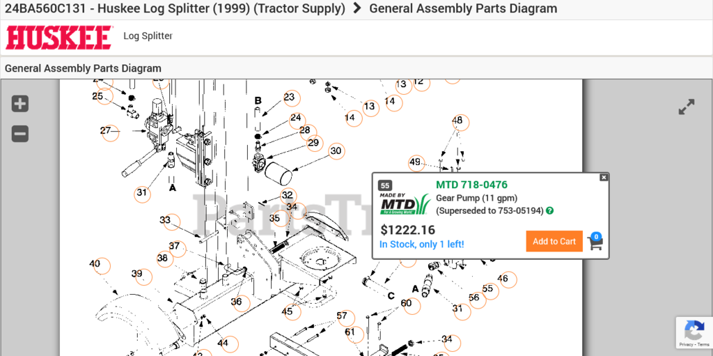

Pullstart 64,533 #4 Posted June 6, 2022 $1226 for a pump alone!?!?!? I’d customize it to fit something else. 1 Share this post Link to post Share on other sites
elcamino/wheelhorse 9,360 #5 Posted June 6, 2022 Every manual I have found is for a horizontal shaft engine . I checked that $1,226.00 and it is for a horizontal shaft engine.. The log spliter my son has is a vertical/horizontal unit if that makes any difference. I think if I could find the specs on the pump that is on the unit , I could find a pump to purchase. Not paying $1,226 for a pump. Share this post Link to post Share on other sites
