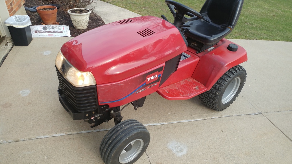

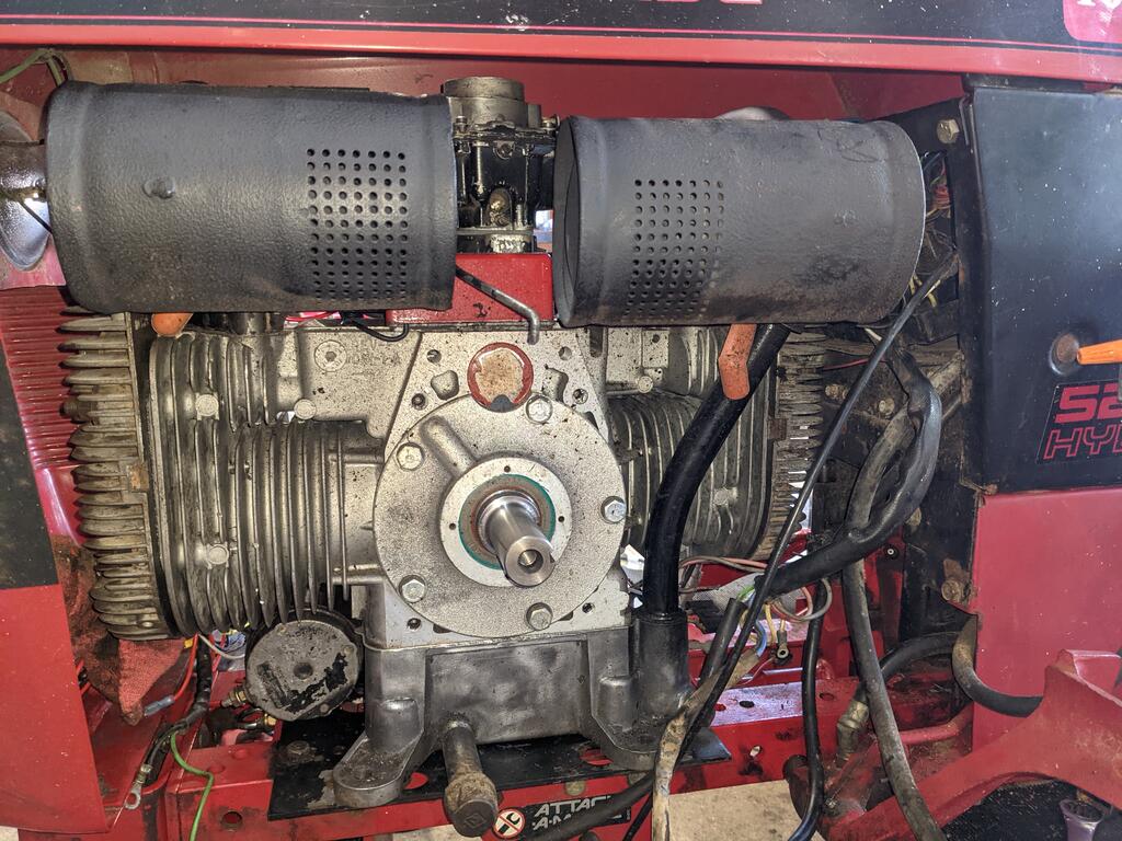

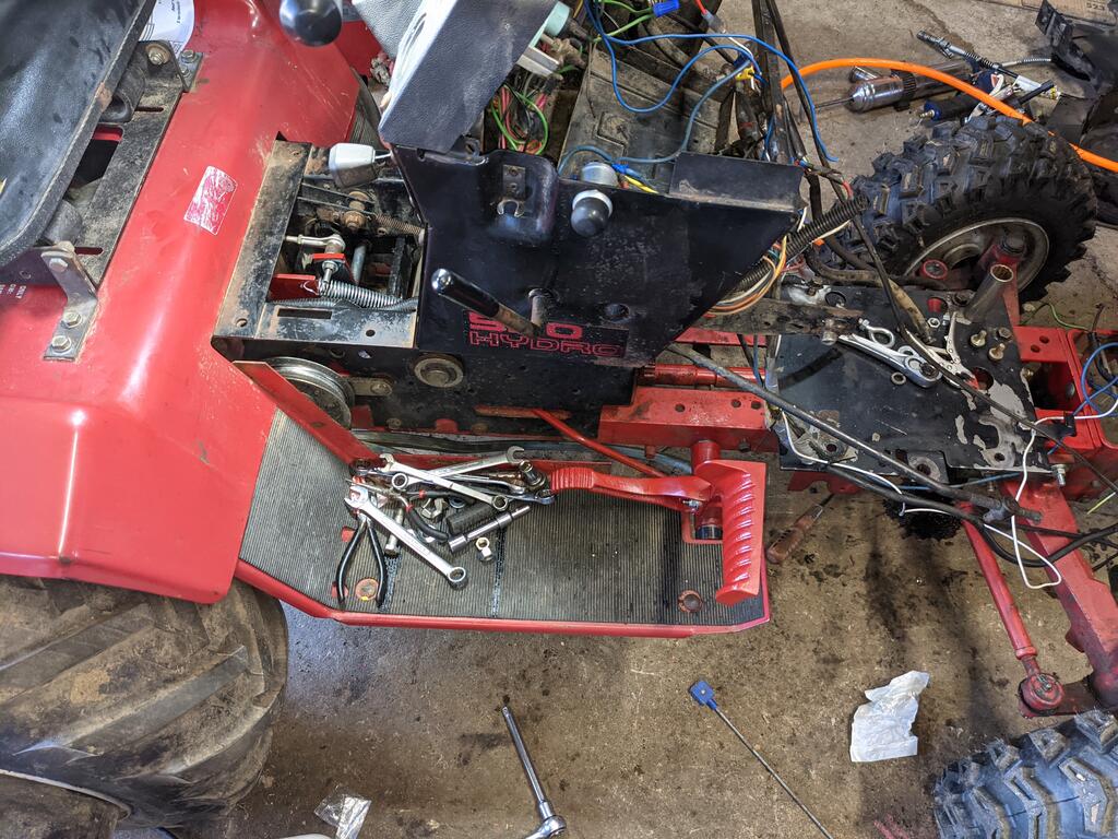

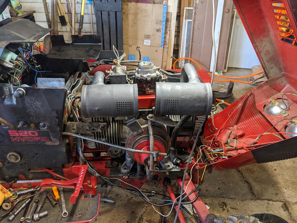

TJ5208 1,824 #26 Posted June 8, 2022 13 minutes ago, Snoopy11 said: @kpinnc... 520-H with a 23hp Vanguard That 520 is 1 Share this post Link to post Share on other sites

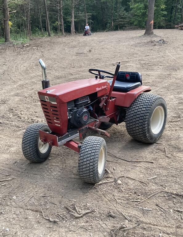

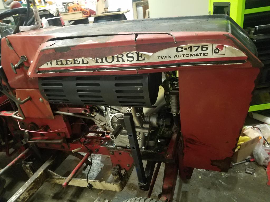

Snoopy11 5,717 #27 Posted June 8, 2022 @SamH.... C-175 with Predator 22 HP On 11/23/2018 at 8:58 PM, SamH said: On 11/24/2018 at 7:35 PM, SamH said: 2 Share this post Link to post Share on other sites

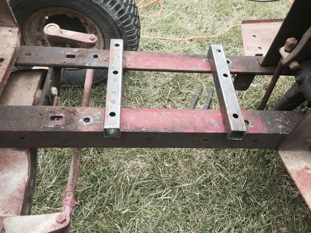

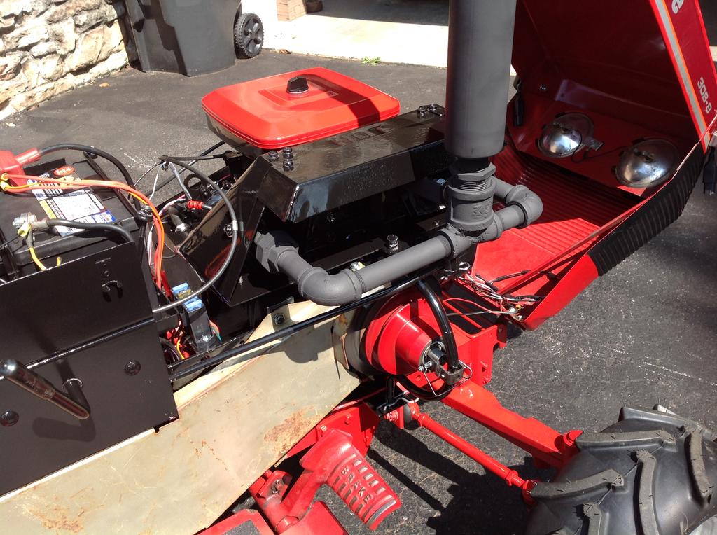

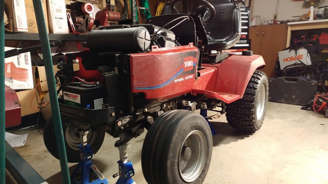

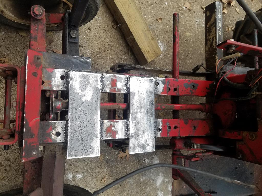

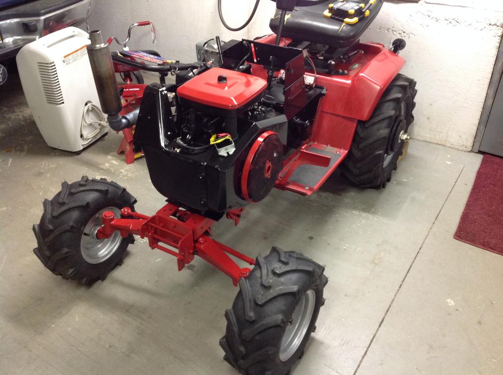

Snoopy11 5,717 #28 Posted June 8, 2022 @WildmanC120... C161 with Predator 22HP... On 10/25/2018 at 6:15 PM, WildmanC120 said: I took the old Briggs mounting plate and cut the angled pieces with the rubber mounts off each end. I then placed it where I wanted it and drilled some new mounting holes. This gave me something to mount the engine too. This plate is literally as high as you can go otherwise the hood will hit and rest on the top of the engine. I wish you could go a little higher but in the end it should work OK. I will have to find some shorter belts to run the deck and snowblower i'm sure. On 10/25/2018 at 6:20 PM, WildmanC120 said: On 10/25/2018 at 6:24 PM, WildmanC120 said: 1 Share this post Link to post Share on other sites

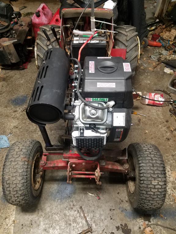

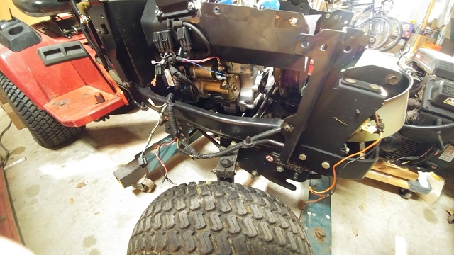

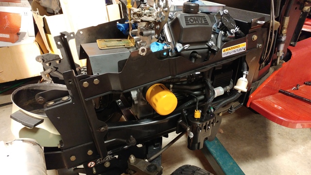

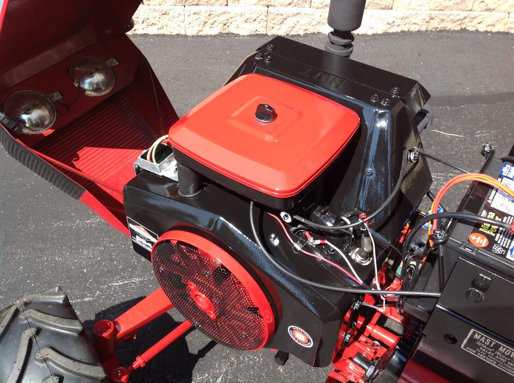

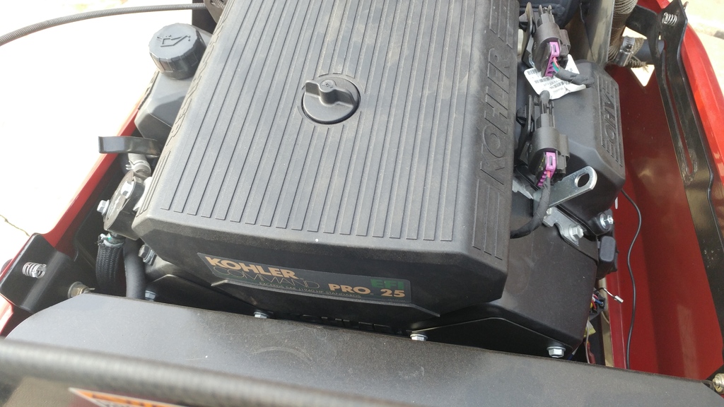

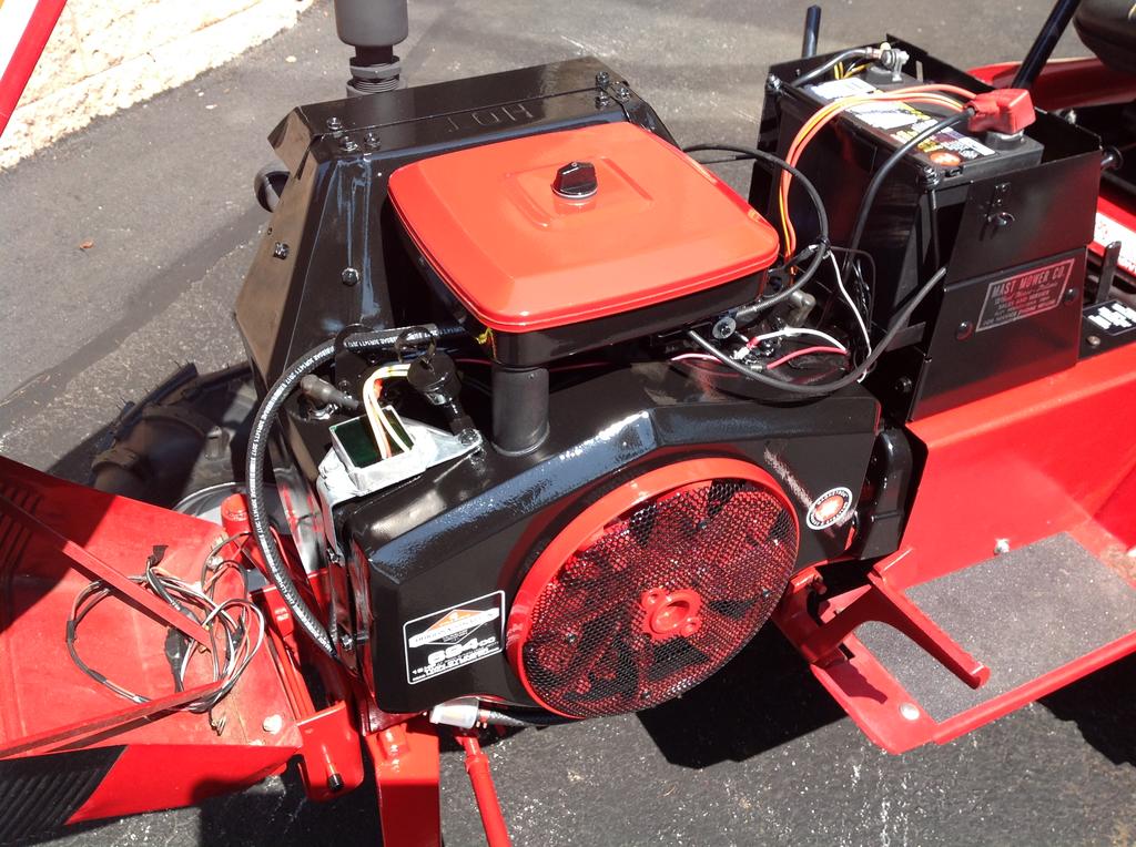

Snoopy11 5,717 #29 Posted June 8, 2022 @bmsgaffer... 525 EXI with 25HP EFI Kohler Command 25 HP CH730... On 10/26/2016 at 11:55 PM, bmsgaffer said: On 11/28/2016 at 10:32 PM, bmsgaffer said: On 3/27/2017 at 12:37 AM, bmsgaffer said: 4 Share this post Link to post Share on other sites

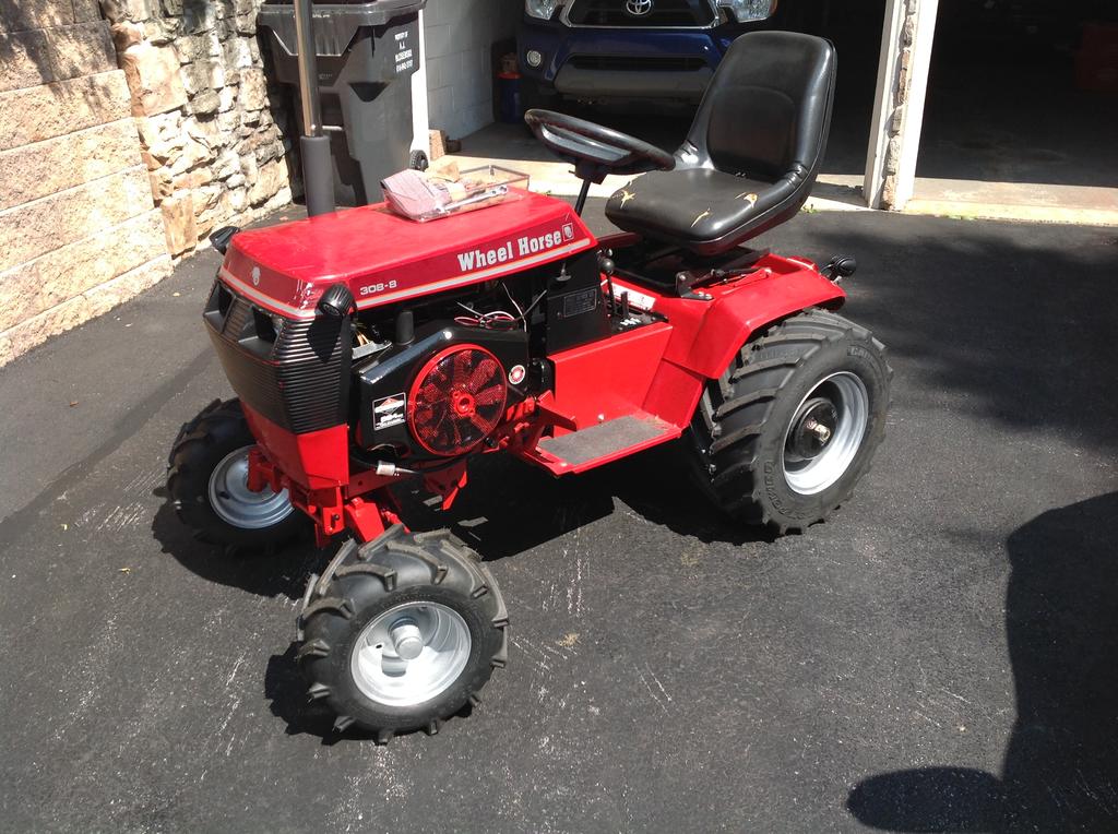

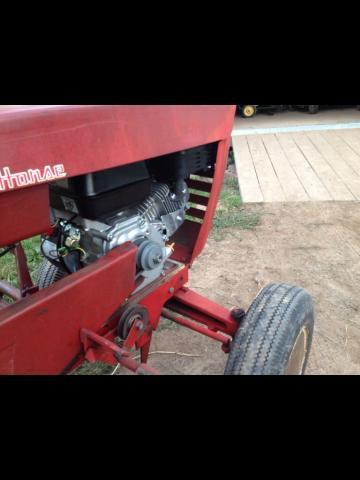

Snoopy11 5,717 #30 Posted June 8, 2022 @aHorseofCourse... 308 with Briggs 18hp opposed Twin... On 8/20/2017 at 8:50 PM, aHorseofCourse said: On 8/21/2017 at 7:52 PM, aHorseofCourse said: 3 Share this post Link to post Share on other sites

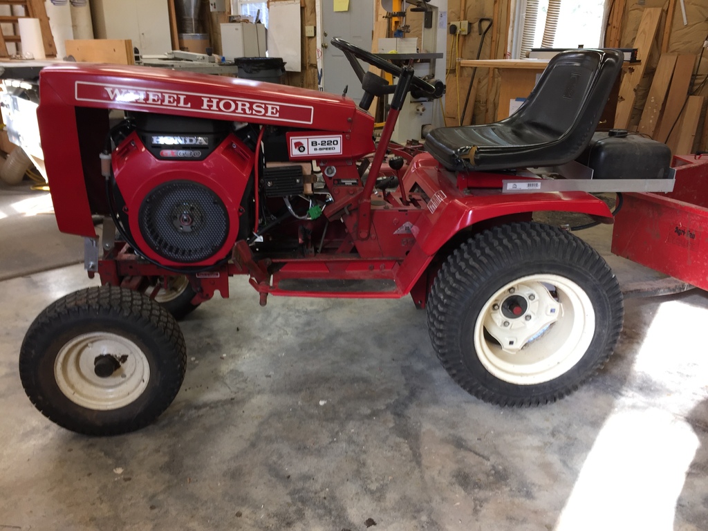

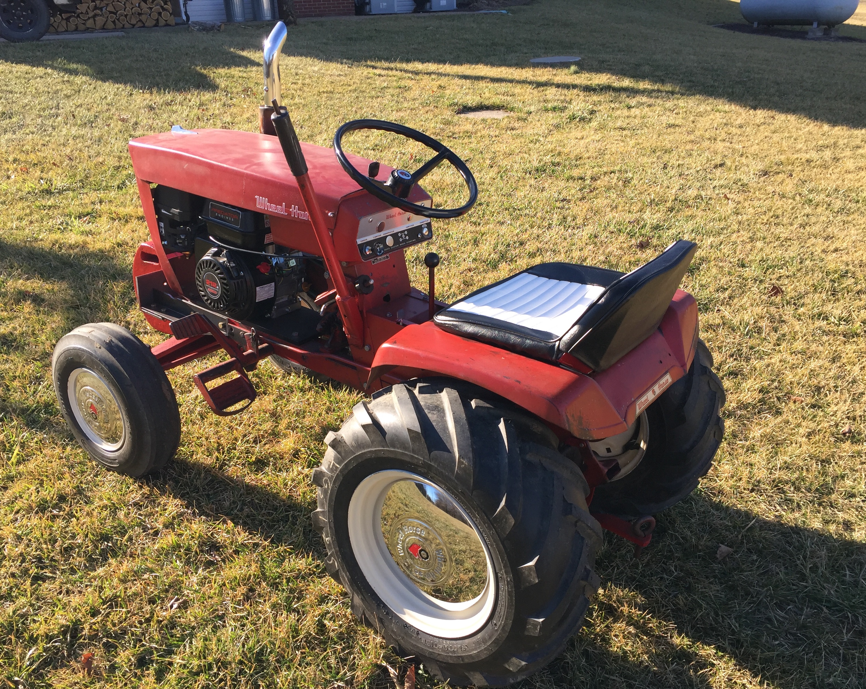

Snoopy11 5,717 #33 Posted June 9, 2022 @Mike Johnson... B-100/220 with GX630... On 2/4/2017 at 10:14 AM, Mike Johnson said: 4 Share this post Link to post Share on other sites

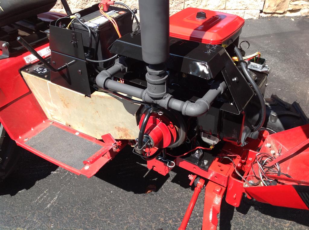

Snoopy11 5,717 #34 Posted June 9, 2022 @artfull dodger ...Commando 8 with Yanmar diesel L70AE On 9/15/2017 at 9:31 PM, artfull dodger said: 3 Share this post Link to post Share on other sites

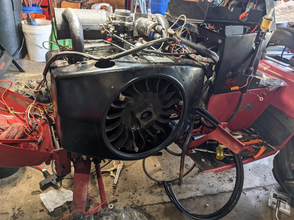

Snoopy11 5,717 #36 Posted June 9, 2022 @seuadr... 520H with Onan N52M swap. On 4/4/2021 at 5:53 PM, seuadr said: But it fits! Even lined up with the existing holes! Muffler clearance is snug Tins mostly fitted in place PTO sits at the same spacing/height 3 Share this post Link to post Share on other sites

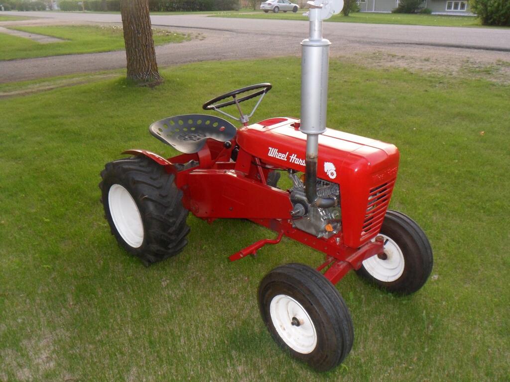

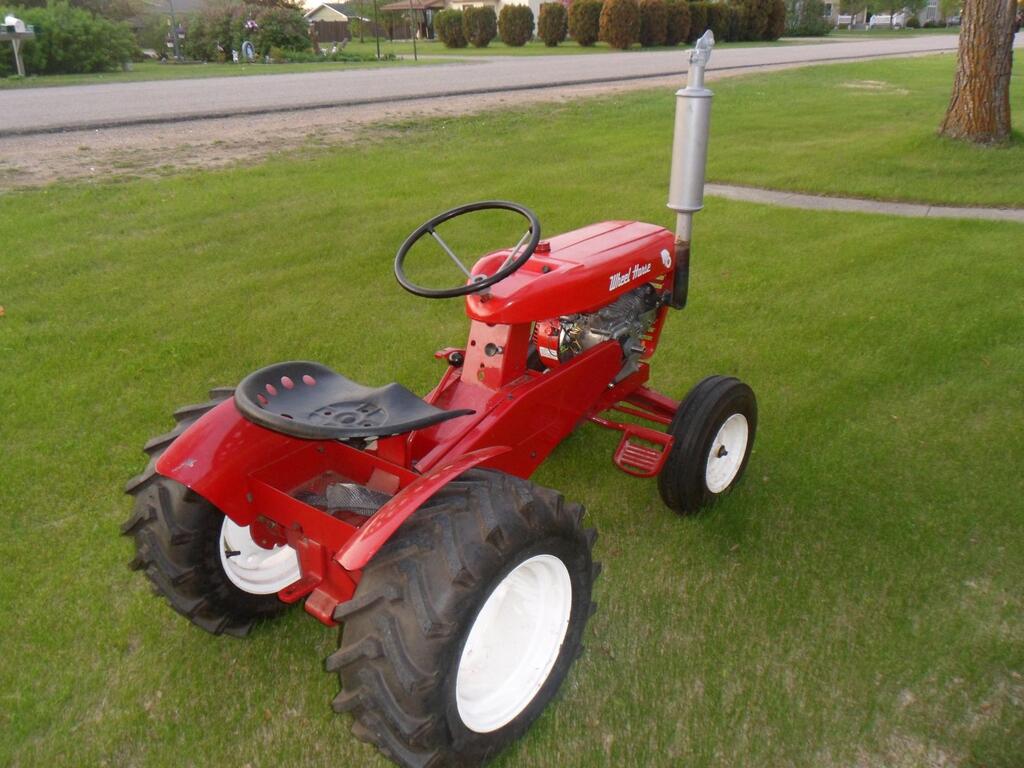

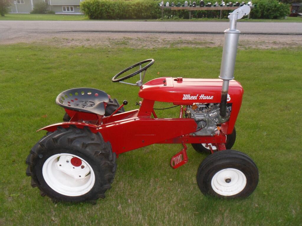

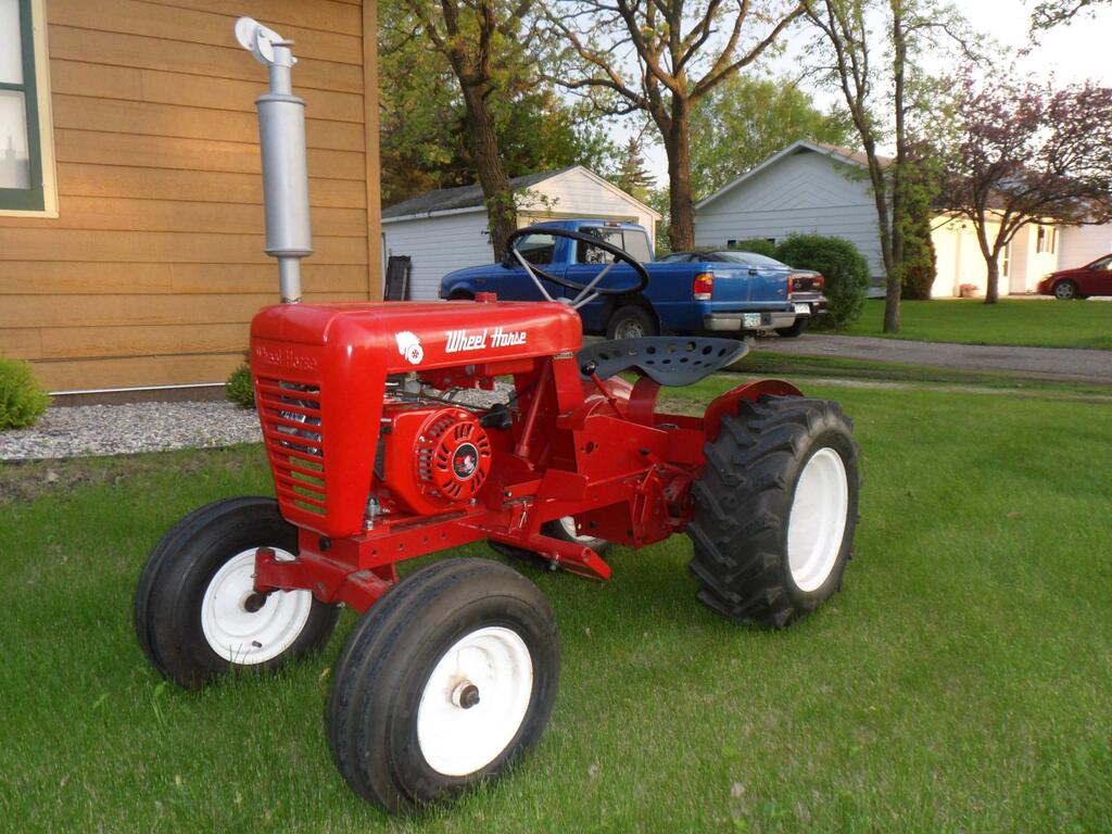

Snoopy11 5,717 #37 Posted June 9, 2022 @cschannuth... 606 with Predator 212 On 4/21/2017 at 6:54 PM, cschannuth said: I was sold on the 212cc Predator by my brother. You see, if it can survive my brother and his kids, it can survive anything. I'm very particular and a maintenance freak. He is neither of those things. He bought a small Baja branded Chinese dirt bike from Orschelns Farm and Home 5 or 6 years ago and it had the small Predator. They have run that poor thing to death and it has never had the oil checked or changed in its entire life. It's starts on the first pull every time and is still going strong. Needless to say, when I came across an almost free 606 roller the Predator was an easy choice for me. It's easily my favorite tractor. I upsized the engine pulley and almost doubled the speed and it handles it with ease. 3 Share this post Link to post Share on other sites

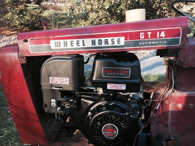

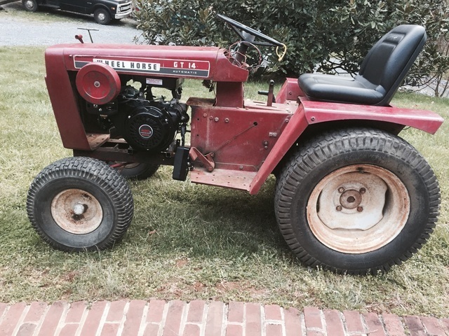

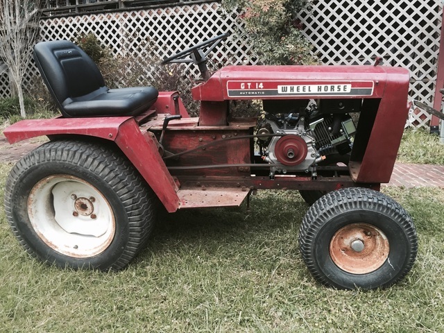

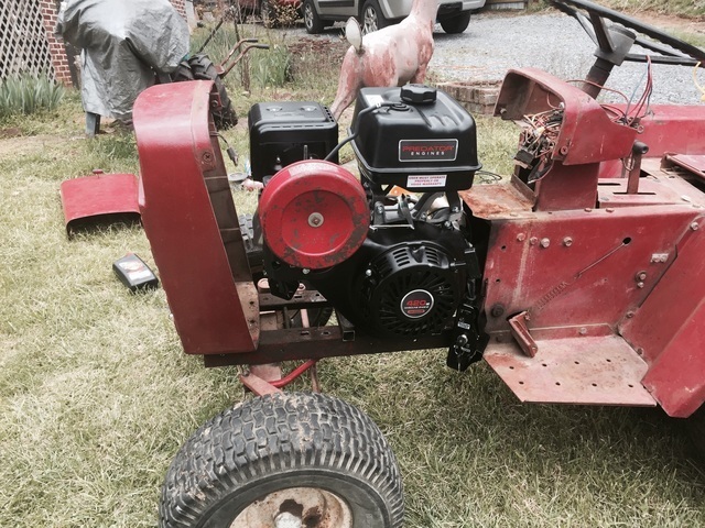

Snoopy11 5,717 #38 Posted June 9, 2022 @dells68... GT14 with Predator 420cc (13 HP) swap. On 4/10/2016 at 9:44 PM, dells68 said: 3 Share this post Link to post Share on other sites

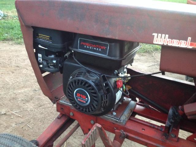

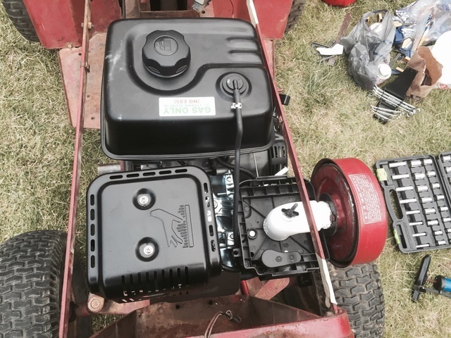

Snoopy11 5,717 #40 Posted June 10, 2022 (edited) @ricksrj58 L-157 with Predator 212. On 6/29/2014 at 3:23 PM, ricksrj58 said: picked up a nice little ranger with minor engine problems mainly being a techy so i bought a predator for $98 bucks.fedex delivered it yesterday and i allready have it mounted on the tractor.i just need to figure out what type of bracket/frame to build so i can use the original fuel tank and position. On 7/9/2014 at 7:28 PM, ricksrj58 said: On 7/30/2014 at 4:29 PM, ricksrj58 said: Edited June 10, 2022 by Snoopy11 1 1 Share this post Link to post Share on other sites

cschannuth 3,817 #43 Posted June 10, 2022 17 hours ago, Snoopy11 said: @cschannuth... 606 with Predator 212 Sorry I missed this thread @Snoopy11. Still one of my favorites and still going strong. And my brother’s Chinese dirt bike is still running on that original 10 year old oil with no issues. 2 2 Share this post Link to post Share on other sites

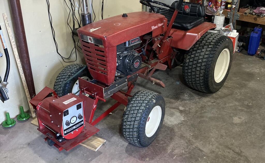

ebinmaine 70,779 #44 Posted June 10, 2022 3 minutes ago, cschannuth said: Like that generator mount. @OldWorkHorse Steve here's an idea. 1 1 Share this post Link to post Share on other sites
cschannuth 3,817 #45 Posted June 10, 2022 Just now, ebinmaine said: Like that generator mount. @OldWorkHorse Steve here's an idea. I built the bumper earlier and just added a couple of angle iron tabs to the front of it to match up with the generator hanger. It works pretty well. 3 Share this post Link to post Share on other sites

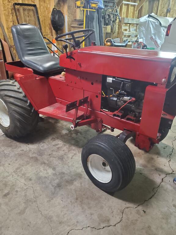

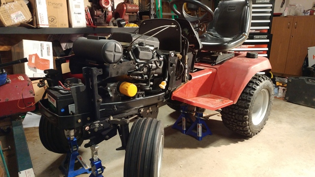

Snoopy11 5,717 #50 Posted June 10, 2022 @Embick87... 18 auto with Kohler CH18... On 10/15/2020 at 10:30 PM, Embick87 said: This is an 18 auotomatic my grandfather gave me years ago. I have been recently inspired to work on it again. I brought it back to life with a kohler ch 18. I cant believe the power and response of this big old tractor. I had to raise it up a little, and had a spacer made. Just so it fits under the hood 2 Share this post Link to post Share on other sites
