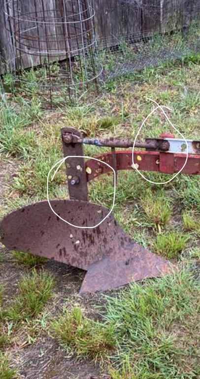

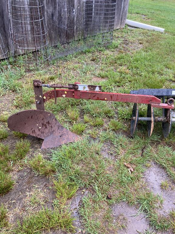

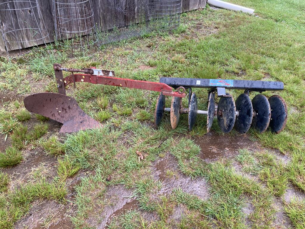

TonyToro Jr. 1,772 #1 Posted June 2, 2022 We just picked up two attachments. One is a Brinley disk harrow and the other one is a Wheel Horse single bottom plow. ( or that’s what the guy told us) If anyone has any tips or tricks for the wheel horse bottom plow for a manual for it it would help a lot. Also, the adjuster on the bottom plow is not moving right now so if anyone has a trick to get it free it would help. Both things will be going on a 312-8 and I don’t really know how the bottom plow hooks up so if anyone has any pictures or anything with it being hooked up it would help. We were just going to get the disk harrow but the kind guy let us take it for free! I’ll be using them both to till up the garden along with my C-145 with a rototiller. 6 2 Share this post Link to post Share on other sites

Jennifer 1,878 #3 Posted June 3, 2022 The person told you right…. We owned a plow just like that. Not sure why they added the part at the adjustment…. Assuming it had broken? 🤷🏻♀️ 1 Share this post Link to post Share on other sites
Jennifer 1,878 #4 Posted June 3, 2022 Unbolt both circles and clean it up…. Soak the adjustment screw do hicky and work it free! Good luck! Should not be to difficult…. Like @Pullstartcommented just work at it slowly…. The two circles are your main adjustment points… 1 Share this post Link to post Share on other sites

pacer 3,175 #6 Posted June 3, 2022 Nobody has mentioned that the plow is/has been ..... messed with? That adjustment appears to be a complete .. re-fabrication? So, it may or may not operate as original. Also, unless you dont show it, you dont have the 'coulter' assy (see @Jennifer manual under coulter) 2 Share this post Link to post Share on other sites
6wheeler 667 #7 Posted June 3, 2022 Cool. I agree with the rest of the posters. Except? I use heat. Penetrating oil works. But? takes a long time. If you have access to a torch? Take the adjuster off. Put it in a vice and heat it. When you do get it apart? Clean the threads (wire wheel or equivalent). When you re-assemble it? Put good grease on the threads and inside the barrel. Never seize gets crusty. Grease stays. Also? You are going to need a sleeve/slot hitch to mount it on a tractor. I can't see what you have on the disc for a hitch. I did make a adapter to put a slot hitch implement on a clevis hitch. But? I sold it with the plow and don't have any pics of it. Good Luck 2 Share this post Link to post Share on other sites

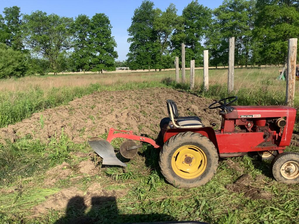

Pullstart 64,582 #8 Posted June 3, 2022 1 hour ago, pacer said: unless you dont show it, you dont have the 'coulter' assy Most of my plowing is done without a coulter. It seems to hang up field trash unless the grass or sod is super short and cleaned off to begin with. I’ve also noticed the coulter (in my area) doesn’t really cut into the sod, it just rolls on top. Might be an adjustment, but I find that I can do wonders without. 2 1 Share this post Link to post Share on other sites

TonyToro Jr. 1,772 #10 Posted June 3, 2022 (edited) Thank you with all the comments and help! But another question in @Pullstart ‘s picture with his plow how does it raise and lower?? It’s it something with the Raise and Lower on the tractor? Also how does the plow hook up to the tractor it has a hitch on it so I’m guessing it hooks up to the regular hitch? I’m trying to learn all this on my own. Edited June 4, 2022 by TonyToro Jr. Share this post Link to post Share on other sites
Pullstart 64,582 #11 Posted June 4, 2022 You’ll need the “slot hitch” on your tractor and a good lift cable. These plows are heavy when they are under ground and seem to lift best for me when I’m moving. here is a picture of a slot hitch in this ad I found. 1 Share this post Link to post Share on other sites
