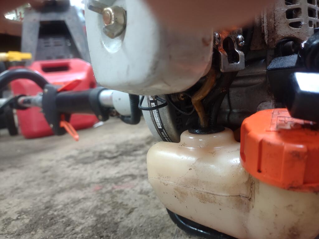

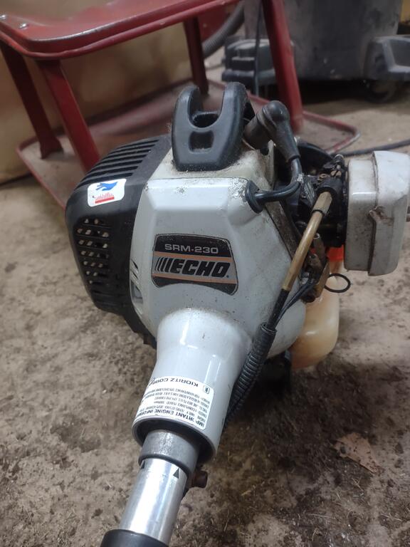

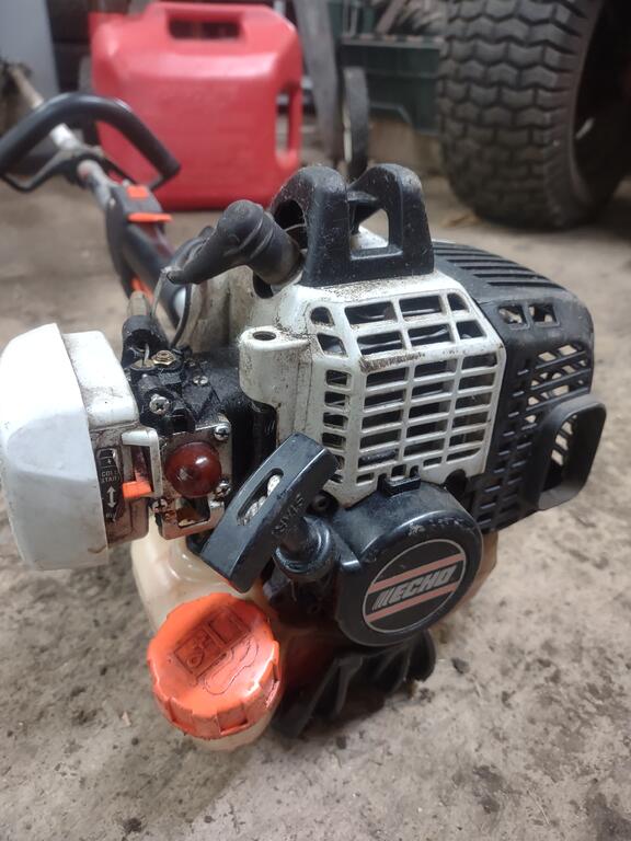

ebinmaine 70,789 #1 Posted May 30, 2022 Trina and I were gifted an Echo string trimmer by @Handy Don a bit ago. Excellent machine and much appreciated. We fired it up today and it's drizzling gas somewhere. We aren't exactly 2 stroke engine mechanics. Is there a vent that's clogged or something? Any thoughts? @Digger 66 1 Share this post Link to post Share on other sites
wallfish 17,498 #2 Posted May 30, 2022 The fuel lines are probably hard and brittle. Change the fuel lines and that primer bulb if it's getting hard. Even time will make those hard, not just ethanol. 8 2 1 Share this post Link to post Share on other sites
JoeM 7,935 #3 Posted May 30, 2022 3 minutes ago, wallfish said: Even time will make those hard, not just ethanol look real close at the tank bushing too. 5 1 Share this post Link to post Share on other sites

midpack 970 #6 Posted May 31, 2022 Looks like it's wet at the tank seal. You can get the lines and seal in a kit with a fuel filter IIRC 1 Share this post Link to post Share on other sites

ri702bill 8,990 #10 Posted May 31, 2022 Eric: All the above, but with 2 notes. It looks to be an older model - one made before ethanol gas perhaps. I was given an older Echo gas Hedge Trimmer with the same issue. I had to go look at a 4x8 trailer for sale at a small engine repair shop and asked the owner about it. He showed me two 55-gallon barrels filed with junk Zama carburetors. Seems that there is a cross drilled passage on them and is sealed with a disc and some type of red sealant. Ethanol gas breaks down the sealant, the disc becomes loose and results in a permanent fuel leak. The replacement carburetors with the ethanol compatible sealant, available on the Jungle site, can be had as a complete kit - carb, bushing, fuel lines and the "clunk" - the filter. - note #2. Do check the seam on the tank. 1 1 Share this post Link to post Share on other sites

Digger 66 3,488 #18 Posted June 1, 2022 On 5/31/2022 at 7:26 AM, ebinmaine said: Yeah I suppose probably that's the only real way to do it right.... If there's nothing broken like the tank etc . It probably could use a carb rebuild kit . I never did an Echo but if it's a Walbro or Zama carb , parts and videos are plentiful. Fuel lines should be replaced with ( IMO ) Tygon lines of the correct size . If you go through it stem to stern now , it will probably outlive us . My cheap Ryobi SS30 is still kickin after almost 27 years of service . PS It's getting hard to find big bore 2 smokers without spending a life savings . Need any help , feel free to PM me . 1 Share this post Link to post Share on other sites
Jrain 276 #19 Posted June 1, 2022 I have a echo weed trimmer its ok bought it about 6 years ago , but yes every other season I have to change all the fuel lines and primmer bulb , echo makes a kit that gives you all the fuel lines ,filter .vent and grommet , the primmer bulb comes in 3 sizes so make sure you get the correct one ,they do sell a 3 pack with all the primmer bulb sizes , also if you have a spark arrester (fine mesh screen at the end of the muffler ) they get clogged up and screw with the engine ,hard starts ,idle and performance , cut the screen out so the exhaust gases flow . 2 Share this post Link to post Share on other sites
