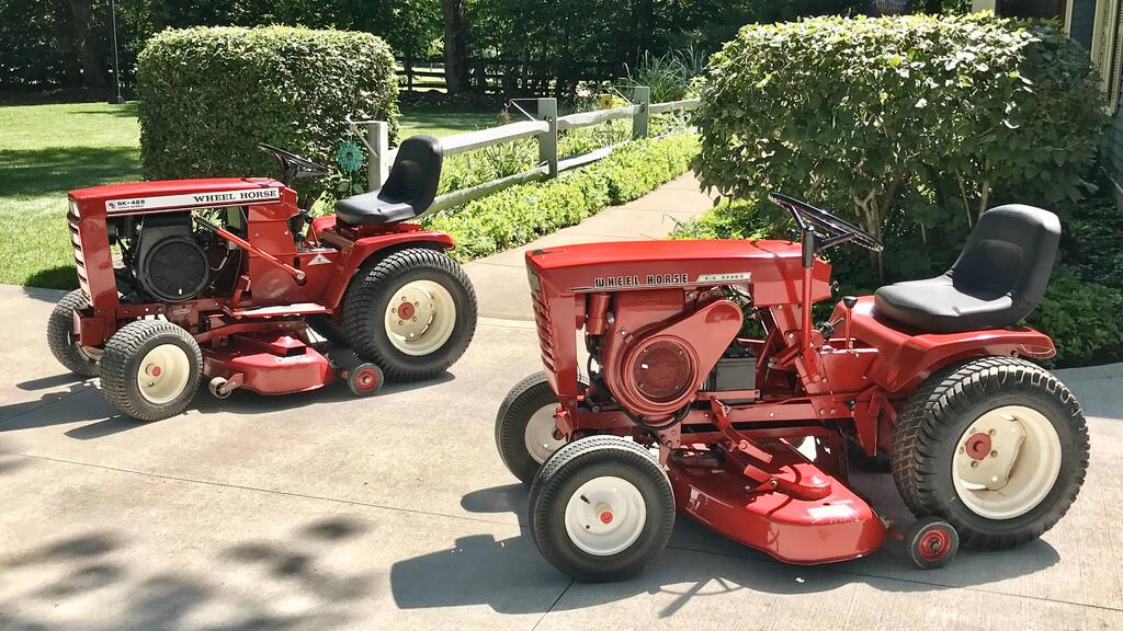

Al C. 1,405 #1 Posted May 26, 2022 After years of pampering these, I’m finding it difficult to use them enough to keep the batteries charged. I’m thinking of “garaging” them for a couple years and want to do it the right way. Belts and filters are new, oil is fresh, and they are tuned. I’m thinking all I need to do is drain the gas and make sure the carburetors are empty. Then put them in a dry corner of the garage and cover them. Is there anything else I should do to ensure they start up in a couple years with fresh batteries? 2 2 Share this post Link to post Share on other sites
