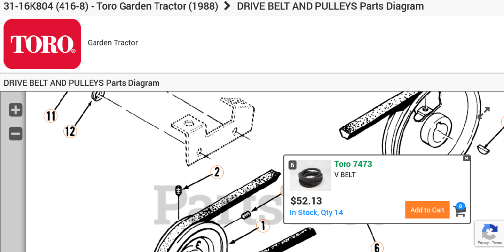

hey guys i just picked up a new tractor it’s a 416-8 and the drive belt looks really beat up and it came off the engine pulley so i wondering what size belt belongs on it because i can’t read the old one
1995 520H+96+97
Kohler powered - Transmission drive belt 78-7100 replaced by 7473 - HB x 81.9" or 5/8" x 81.9"
Onan powered - Tractor drive belt  107939 replaced by 93-9809 - (HB x 83.5" or 5/8" x 83-1/2")
