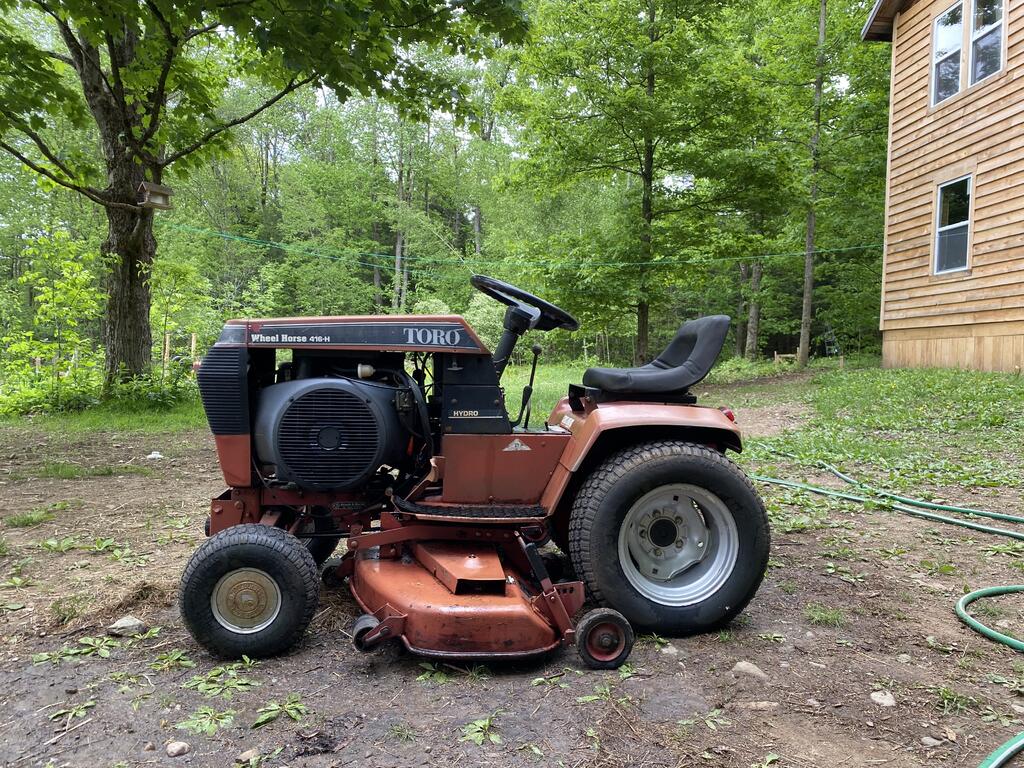

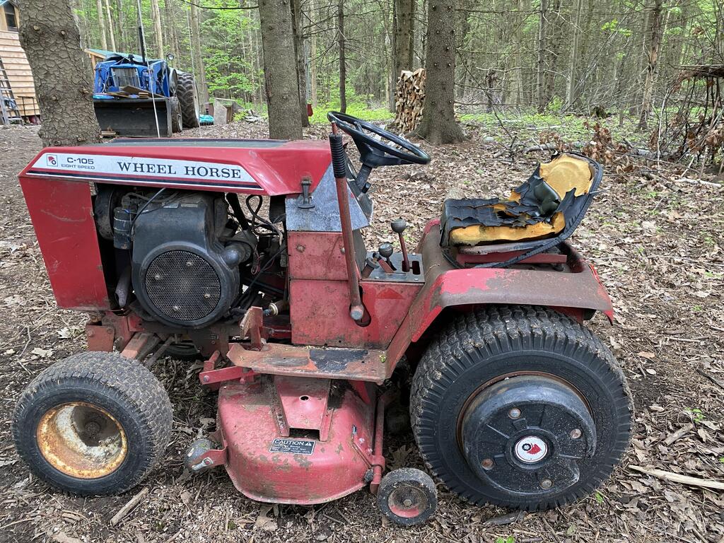

JerryLook 73 #1 Posted May 24, 2022 I recently acquired two Wheel Horse tractors from a relative who wanted to get rid of them. I’ve never owned a Wheel Horse before, and have some questions about them. I’ll tell a little about each tractor. C-105. This tractor is in rough cosmetic and running shape. From the S/N plate I know it’s a 1981. The relative I got it from is the original owner, and has had the engine rebuilt once (because he said he ran it out of oil). This tractor came to me with wheel weights and snow chains on it. He’s supposed to give me the snowblower that goes with it as well. When I changed the oil, some thick metallic sludge came out first. I would imagine the engine has a stuck ring, or something that’s causing it to eat itself. Also there is oil on the head fins, which I’ve read is a sign of a cracked head. This mower also smokes a lot when it runs. I would assume this engine will need a complete rebuild if I ever want to use the tractor for anything. It has what looks to be the original Kohler 10hp engine. 416-H. This tractor is in much better shape than the other. But unfortunately it was being stored outside. I got this one in non running condition. The S/N plate is not where it’s supposed to be on the rear fender. So I don’t know the year. Also the engine data plate is too faded to read. So I can’t get the age info from there either. I found that the seat switch was wired wrong. Someone had spliced the wires together so that the seat light was always on. And the seat was adjusted so it would never touch the seat switch anyways. So I spliced yellow and Orange together for now so it runs. The battery terminal on the ignition switch was broken off. So I borrowed the ignition switch from the C-105 (same P/N). I fired up the Onan 16hp and it runs great. I changed the oil and oil filter, as well as the fuel filter. The mower runs and mows great. I greased all the fittings and sharpened the blades. It shows 487 hours on the hour meter. Sorry for the long post. My questions are this. What is the service interval for greasing the front spindles? Also, on the 416-H, should I go ahead and change the hydro filter and fluid since I don’t know the last time it was done? I’ve noticed that some people are running a Tri rib front tire. What size are you using, and are you reusing the factory wheels? I was happy to see that there’s a forum devoted to these mowers. I’m on a couple of farm tractor forums also. My other tractors are a Ford 3000 diesel, and Ford 8N. So I’m used to working on tractors, just a little bit bigger. 8 3 Share this post Link to post Share on other sites
JerryLook 73 #2 Posted May 24, 2022 Also on the 416-H the parking brake light is on all the time. And the parking brake doesn’t seem to work. So I assume there’s an adjustment that needs to be made to fix the brake and extinguish the light. Share this post Link to post Share on other sites
Pullstart 63,417 #3 Posted May 24, 2022 if there’s a positive to the 416-H being stored outside, the transmission can’t get water in it at least! Most service intervals are 50 hours. For the trans, WIX 51410 or NAPA 1410 hydro filter and replace oil for oil or atf for atf - don’t mix. 2 Share this post Link to post Share on other sites

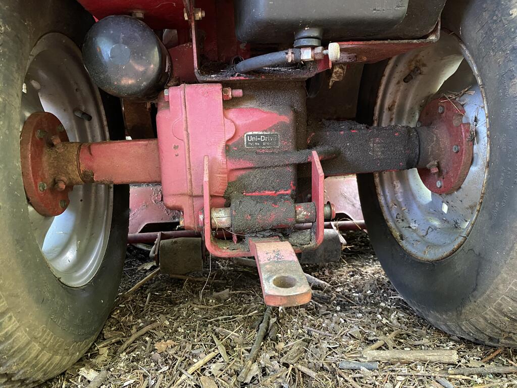

JerryLook 73 #13 Posted May 24, 2022 Ok thanks. I noticed where the hydro filter is in the back by the hitch. I’m sure I can find the drain plug under there. Then the level is check via the dip stick by the gas cap I assume? I noticed my 416 has some oil build up on the right side of the diff. I wonder if I have a leak back there. 1 Share this post Link to post Share on other sites
Achto 28,124 #14 Posted May 24, 2022 Hard to tell if that leak is at the axle seal or on top of the tranny. I would clean it up & run it around for a while to see where the leak is. Drain for the tranny will be on the bottom of the tranny. Right next to the hitch. 3/8 or 1/2" pipe plug. 4 Share this post Link to post Share on other sites
Handy Don 12,998 #15 Posted May 24, 2022 34 minutes ago, Achto said: Hard to tell if that leak is at the axle seal or on top of the tranny I agree. With muck on top of the seat support frame, it could be that the dipstick housing is broken or isn't properly locked into the transaxle or that one of the top bolts wasn't tightened 1 Share this post Link to post Share on other sites

JerryLook 73 #18 Posted May 25, 2022 I was looking at spindles this morning on ebay. Seems like I can get a pair of spindles for 8” wheels pretty inexpensive. Also I think the spindles from the C-105 would fit the 416 from the research I’ve done. The C-105 would need a bit of work to make it right again. It needs an ignition switch, battery, seat, engine overhaul... So I’m not sure what to do with it. I don’t know that I want to put the time or money into a tractor that’s so cosmetically beat up. Yes, that’s the worst seat I’ve seen. It’s pretty sad. I think the snowblower and 416H would be a good combo too. I need to get my hands on the snowblower soon. My relative has it, but not at the same place as the mowers were. I’m realizing now how much this Wheel horse stuff goes for. And it might be hard to find a snowblower near me anyways. Share this post Link to post Share on other sites
JerryLook 73 #19 Posted May 25, 2022 I noticed today that the oil level is over full on the 416. So it must be leaking gas through the carb. Honestly the carb could use a rebuild anyways. I have to run it with about 1/4 choke on to make the engine run smooth. What’s everyone’s opinion on what to do with the C-105? I see my options as this- -Use it as a parts tractor. Take the spindles and front wheels for my 416. Use any other parts I might need off it -Sell it as is for someone else to mess with. Obviously with the full disclaimer of everything I know is wrong with it. -Park it for now and maybe some day do something with it. I have a ton of projects, and not a lot of time. The odds of getting to it any time soon are slim. But maybe some time over the winter. One of these winters. Haha. Share this post Link to post Share on other sites

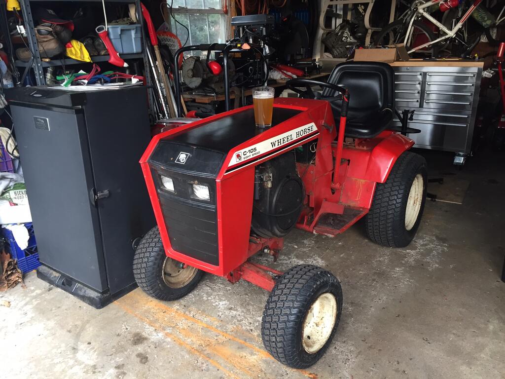

SylvanLakeWH 26,471 #20 Posted May 25, 2022 I consulted with his Black Hood cousin that’s in my garage - my C 105 - and we agree - Keep it and get it running!!! Cheers! 2 Share this post Link to post Share on other sites
8ntruck 7,236 #21 Posted May 25, 2022 Clyde my C195 agrees with @SylvanLakeWH: to the forum. Good bunch of folks here. Collectively, we've probably broken, and fixed, a Wheel Horse in every possible way. Got questions, ask them - you will probably get at least one good answer here. 2 Share this post Link to post Share on other sites
JerryLook 73 #22 Posted May 25, 2022 (edited) Nice looking C-105. Oh and nice beer too The thing that’s holding me back from committing to my C-105 is the engine issues. I’m wondering if it would be cheaper to find a good, used engine, instead of rebuilding the original. The original engine looks to have a few issues. Some are probably related. -Oil on head fins (cracked head?) -Smokes a lot when running -Pressure on oil dipstick -Stripped exhaust bolts, exhaust loose -Tons of metal in oil Since I’ve been told it was rebuilt in the past, who knows how much shady work was done to it then. The person I got it from most likely got the cheapest person to do the work. I also wouldn’t be against putting a non original engine in it. If everything else would fit like stock. Like a different Kohler engine if the same series. I try to not put more money into something than I can sell it for. Even if I have no intentions of selling it. With a few exceptions of course. I’m not opposed to sourcing another engine. If everything could be had for say a couple hundred dollars. Edited May 25, 2022 by JerryLook 2 Share this post Link to post Share on other sites
