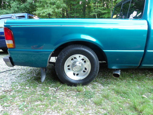

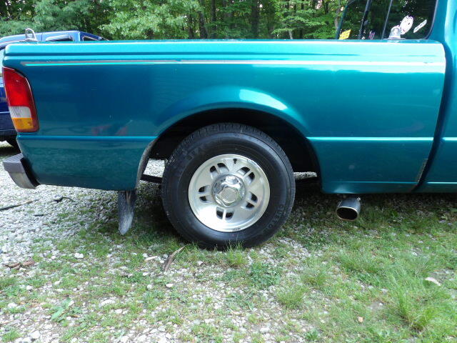

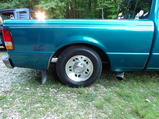

Snoopy11 5,717 #28 Posted May 23, 2022 (edited) On 5/21/2022 at 6:27 AM, adsm08 said: Air shocks are a joke. Oh really... First picture: Stock height (basically loaded). Second picture, 55 PSI. Third picture 100 PSI. Capabilities are 165 PSI... Which... I will probably never need or use... Obviously, there are "better" methods such as air bags... or add a leaf kits... but air shocks aren't a... 'joke' Don Edited May 23, 2022 by Snoopy11 Share this post Link to post Share on other sites
adsm08 2,696 #29 Posted May 23, 2022 1 hour ago, Snoopy11 said: Oh really... First picture: Stock height (basically loaded). Second picture, 55 PSI. Third picture 100 PSI. Capabilities are 165 PSI... Which... I will probably never need or use... Obviously, there are "better" methods such as air bags... or add a leaf kits... but air shocks aren't a... 'joke' Don My Ranger, with the air shocks at 155 PSI, which is where my compressor's shut-off is set, will still drop enough to rub the rear tires with the bed fully loaded. I haven't hit my rear tires since I put the coil-overs on. 1 Share this post Link to post Share on other sites
Snoopy11 5,717 #30 Posted May 23, 2022 4 hours ago, adsm08 said: will still drop enough to rub the rear tires with the bed fully loaded. Interesting... I wasn't aware that this was possible with the stock bump stops installed. Matter of fact, I think on my Ranger... without any bump stops... the axle would hit the frame before the tires rubbed. I would have to notch the frame to make the tires rub... Don Share this post Link to post Share on other sites
adsm08 2,696 #31 Posted May 24, 2022 2 hours ago, Snoopy11 said: Interesting... I wasn't aware that this was possible with the stock bump stops installed. Matter of fact, I think on my Ranger... without any bump stops... the axle would hit the frame before the tires rubbed. I would have to notch the frame to make the tires rub... Don My Ranger is what I like to refer to as "stock plus". I have a first gen (1987) body, so I have the smallest wheel wells of any Ranger body, I have a 97 Explorer rear axle, which is about an inch wider than the pre-93 Ranger axles, and instead of the factory 215/75/15 tires I am running 31X10.50X15s. Extended rear bump stops, which have the possibility of degrading ride quality by hitting too soon, or going to an 89-92 bed with larger wheel wells would both alleviate the issue, but since it only happens fully loaded, which for me is a few hundred pounds over the sticker weight, I don't put a lot of effort into fixing it. I slapped a set of coil-over helper shocks on the back the last time I needed shocks, and it hasn't been an issue since, but it did happen all the time with the air shocks. Actually, the air shocks I had on it were listed for an F-150, but were the same size and eye bolt specs, just a wider operating range, and at 155 PSI they couldn't even lift the rear. That was a scrap run, and I think I off-loaded about 650 lbs at the scale. Payload cap is supposed to be about 500 lbs. Share this post Link to post Share on other sites
Snoopy11 5,717 #32 Posted May 24, 2022 14 hours ago, adsm08 said: Actually, the air shocks I had on it were listed for an F-150, but were the same size and eye bolt specs, just a wider operating range, and at 155 PSI they couldn't even lift the rear. Geeezeus bro... that is unfortunate.... exactly what brand did you buy? Sounds like you got bamboozled... Mine... work... great... Don Share this post Link to post Share on other sites
adsm08 2,696 #33 Posted May 24, 2022 25 minutes ago, Snoopy11 said: Geeezeus bro... that is unfortunate.... exactly what brand did you buy? Sounds like you got bamboozled... Mine... work... great... Don Those were Monroes. Fortunately I didn't buy them. They were defect throw-aways because they came in with the box heavily damaged and the air fitting kit MIA. Store manager said he was obligated to throw them out, but didn't have any control over (or interest in) what happened to them after he set them in the trash can. Share this post Link to post Share on other sites
Snoopy11 5,717 #34 Posted May 24, 2022 4 minutes ago, adsm08 said: Those were Monroes. Fortunately I didn't buy them. They were defect throw-aways because they came in with the box heavily damaged and the air fitting kit MIA. Store manager said he was obligated to throw them out, but didn't have any control over (or interest in) what happened to them after he set them in the trash can. Well, that is unfortunate. I can say... I put mine on, and really REALLY like them. I personally didn't think I was going to keep them... but... they have WELL exceeded my expectations! Don Share this post Link to post Share on other sites
