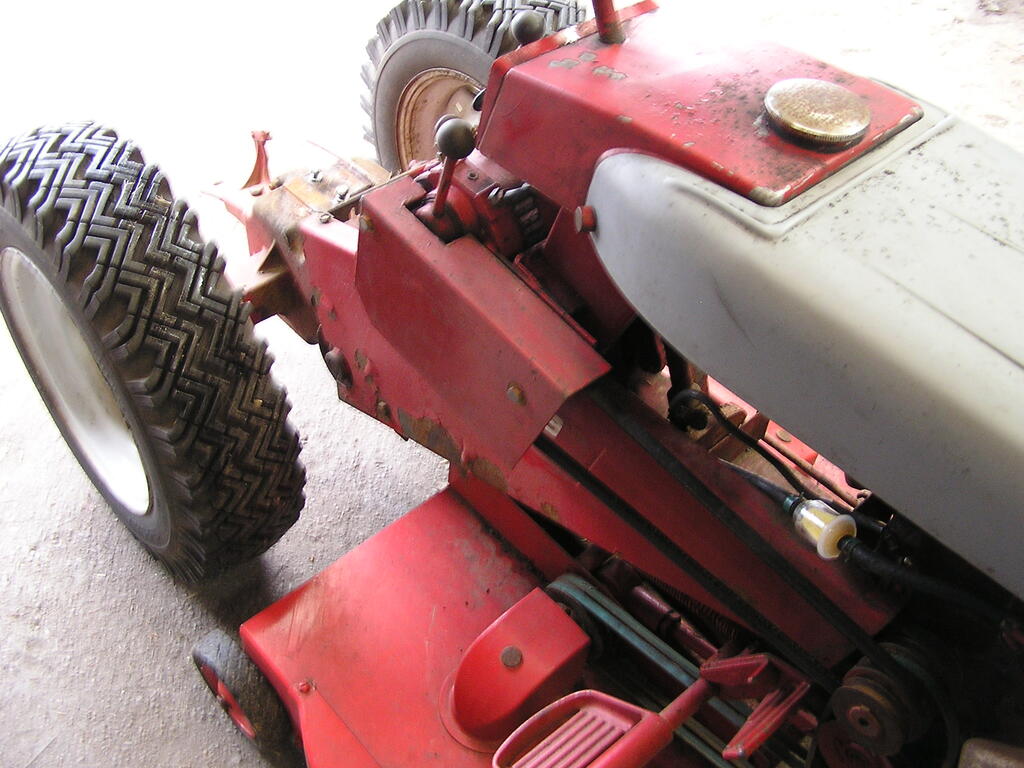

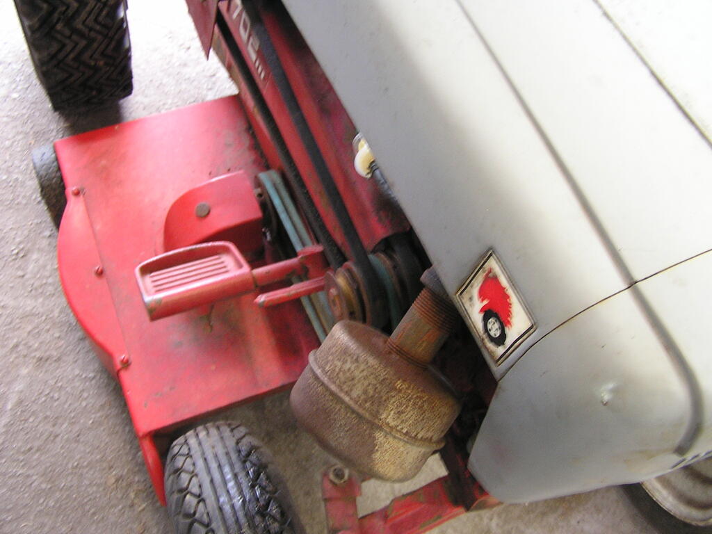

ri702bill 8,994 #1 Posted May 20, 2022 Has anyone added a device to the drive for a Hydraulic pump like a HY-2 shown that would disconnect it to remove that drag while starting? Something along the line of slaving off the deck PTO?? I plan on adding this to a 5 HP rope start 502. Bill Share this post Link to post Share on other sites

ri702bill 8,994 #3 Posted May 20, 2022 (edited) @peter lena Nothing down on paper yet, basically like the drive belt triangle - drive, driven and spring loaded moving idler to tension, with the idler ideally on the slack side... It would be sweet to do this using mostly existing WH pieces from the "Parts Department" too... perhaps inside hidden behind the HY2 belt guard?? Edited May 20, 2022 by ri702bill 1 Share this post Link to post Share on other sites
Handy Don 13,340 #4 Posted May 20, 2022 45 minutes ago, ri702bill said: @peter lena Nothing down on paper yet, basically like the drive belt triangle - drive, driven and spring loaded moving idler to tension, with the idler ideally on the slack side... It would be sweet to do this using mostly existing WH pieces from the "Parts Department" too... perhaps inside hidden behind the HY2 belt guard?? My initial idea would be to consider adding a hinge/pivot at the bottom of the pump mounting. The S/G mount on the similar vintage electric start models, which permits adjusting tension, comes to mind. The hoses to the lift cylinder can flex enough to handle a small movement (I'm thinking it'll take an inch or less of displacement to slacken the belt). A lever could activate a simple cam or arm to pivot and lock the pump in its "working" position. 4 Share this post Link to post Share on other sites
