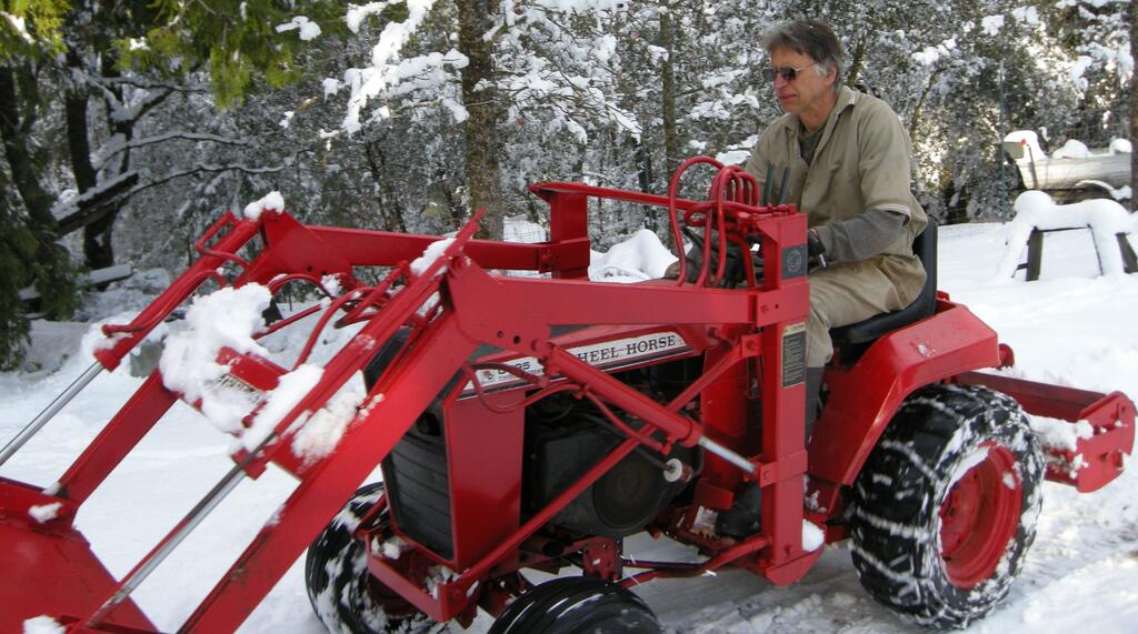

I was driving along in my C-195 Wheelhorse and noticed a lot tranny fluid trail coming from near the filter area (I think) then quickly lost all power.  The hydro is an Eaton Model II CCW, Spec.1100032.  Pulled filter and drained all fluid. Inspected  all lines/fittings, no ruptures evident. Installed new filter and added new fluid (10-40).  Fired it up and no leaks but still no response, forward or back.  Jacked up the rear wheels and notice slight response with very occasional jerky grabbing when putting resistance on both wheels.
Any thoughts on what I should do next?  Previous owner said hydro supposedly had been serviced ten years ago and a Woodruff key replaced...  Comments would be much appreciated.
