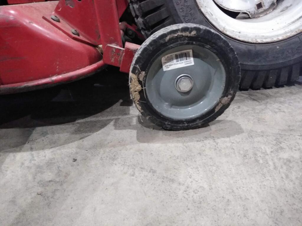

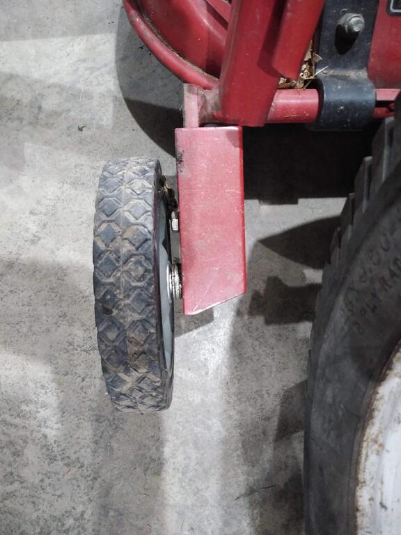

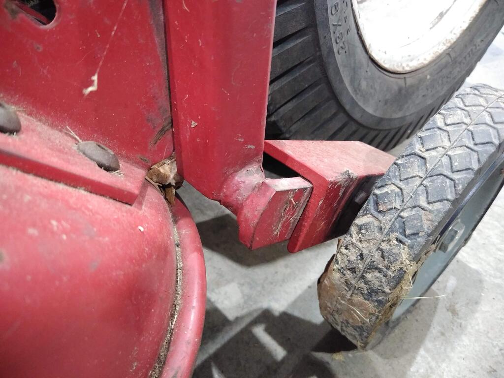

I put bigger wheels on the deck, had to make short extension. I needed my deck higher to pick up leaves without cutting much of the grass

Do you have a pic of what the extension looked like?
edgro
short piece of angle
