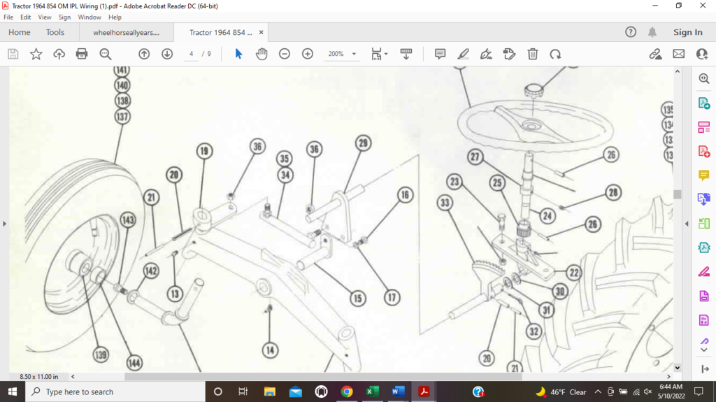

953 nut 57,724 #4 Posted May 10, 2022 I did that a couple of times and found that it attracted dirt and didn't improve steering effort. You should grease the support at the fitting . The biggest thing you can do to improve your steering is to place added shim washers (parts 30 and 31) between the steening support (part 22) and the cotter key on the steering shaft to draw the steering gear (25) closer to the fan gear (33). If there is too much slop there the gear teeth will tend to bind. The shims go behind the steering support, 4 Share this post Link to post Share on other sites
