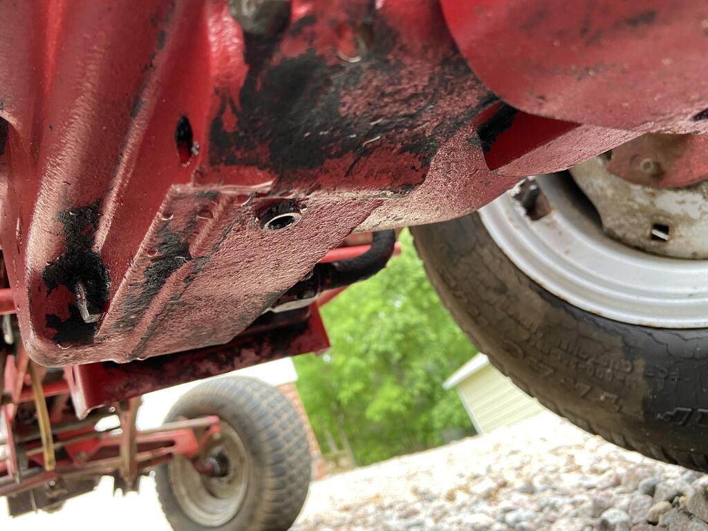

John h zackowski 0 #1 Posted May 8, 2022 I have a 520H and am trying to drain the transfer/transaxle case. I can not find the drain plug. Can anyone let me know where it is? It’s an 86 fyi. Thanks Share this post Link to post Share on other sites
Fishroe 261 #2 Posted May 8, 2022 1/4 Allen socket 2 Share this post Link to post Share on other sites
WheelHorse520H 710 #3 Posted May 8, 2022 (edited) @Fishroe is correct, but I would add to drive it around so it gets hot and flows faster. Edited May 8, 2022 by WheelHorse520H 1 Share this post Link to post Share on other sites
peter lena 10,082 #4 Posted May 9, 2022 @John h zackowski agree with others on the oil gear heat up , do you have any drivable roads or culde sac near by ? thats what I do before all my trans drains , use forward and reverse for heating up that oil . also lift the front end off the ground to increase the drainage . grease your front end while it up in the air , your grease job will be better , grease will come out of top of axel spindles . good luck with it , pete Share this post Link to post Share on other sites
