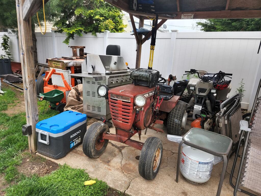

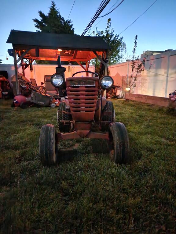

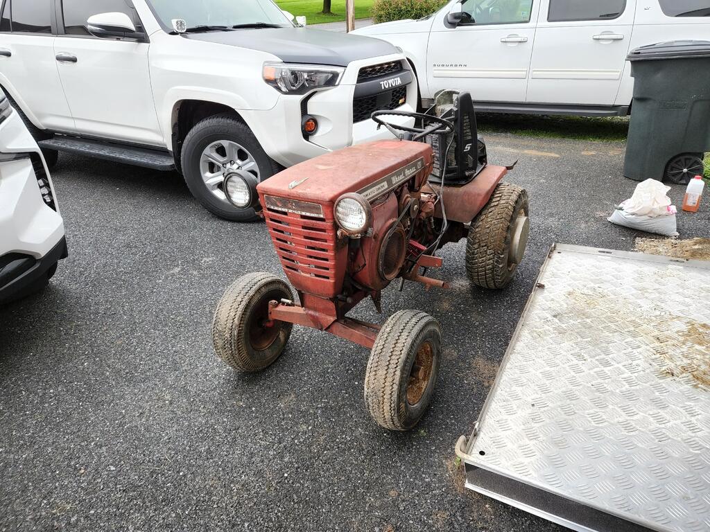

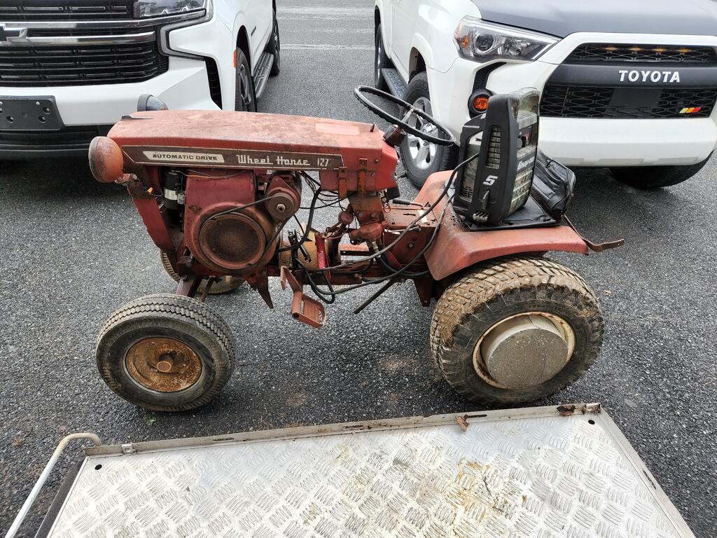

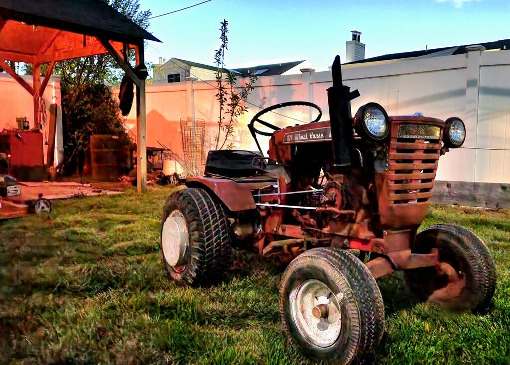

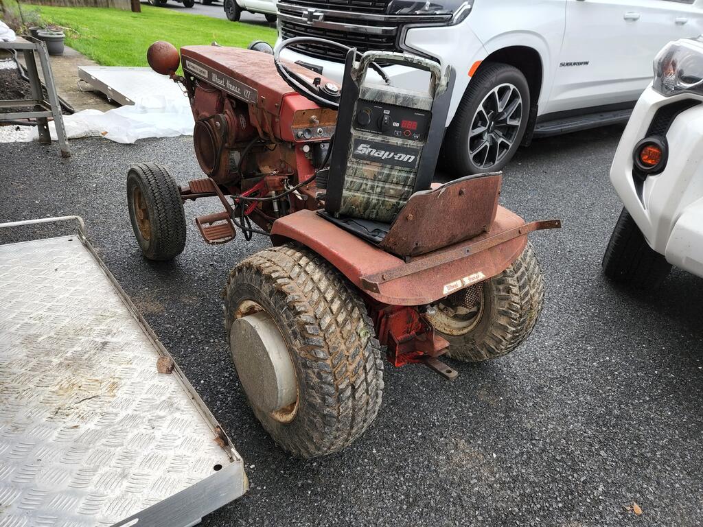

Monstrosity 1,146 #1 Posted May 8, 2022 (edited) Hey! I was looking around for a tractor for my son, he's 5y/o, and I didn't want to buy a power wheels for him to out grow in a few years and why not get a little extra out of the deal .... So I picked up a 1277 that needed some help for $300. It's missing a bunch of items; PTO and lever, belts, main drive cover, seat is gone. The unit came with a mowing deck, snow thrower and an extra engine, the tractor wasn't running, generator/starter didn't work ... which made me weary..... engine had compression and fuel was tarnished. Starter/generator had a broken connection on a brush and dirty. Put a little elbow grease into the fuel and ignition and she fired up... still a little wary of not knowing about the Hydrostatic pump and trans working or not. Ran to tractor supply got a belt (which is to wide) threw it on just to see if it would be enough to spin the pump and it did and it moved! RELIEVED!! This my first garden tractor I'm working on this indepth.. if anyone has information they'd like to share, as I scoure through this forum, it's welcomed!! Thanks for reading! I'll post a quick video next! Edited May 8, 2022 by Monstrosity 10 10 Share this post Link to post Share on other sites
