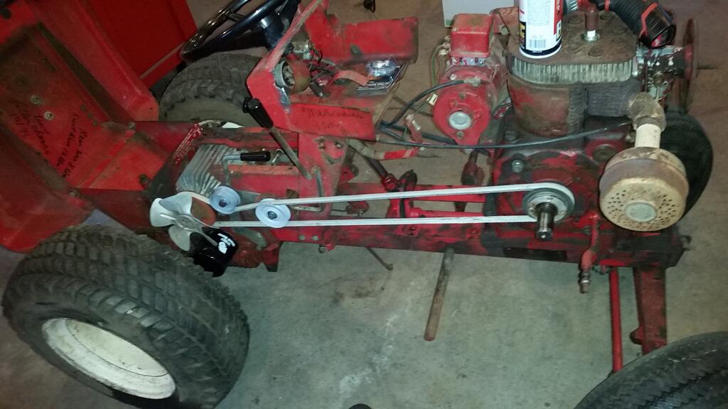

Hello! Brand new picked up a 1277 yesterday and it needs some help. It has no belts, a missing PTO and lever, the main drive cover, and the main drive belt is what I'm trying to figure out how it's routed. Does anyone have pictures of there drive belt with the cover off? Ive searched the forum with no luck maybe I didn't see it but I couldn't find anything.

Belt routing is fairly simple. Just up over the top of the clutch idler. You'll need to find a belt guard they are essential in stopping the belt.

The belt guard has some sheet metal tabs on the inside near the engine pulley.  These tabs hold the belt off of the pulley when the clutch is depressed and the belt is slack.  Without the guard, the slack belt will contact the pulley just enough to keep the input shaft in the transmission turning, which will prevent you from changing gears.
My bad I was thinkin gear jammer.....
here ya go....a 1077 but same difference :)
Belt is a WH 6489 or a 7927or a 4L78 inch belt. I'm partial to the TSC belts.
