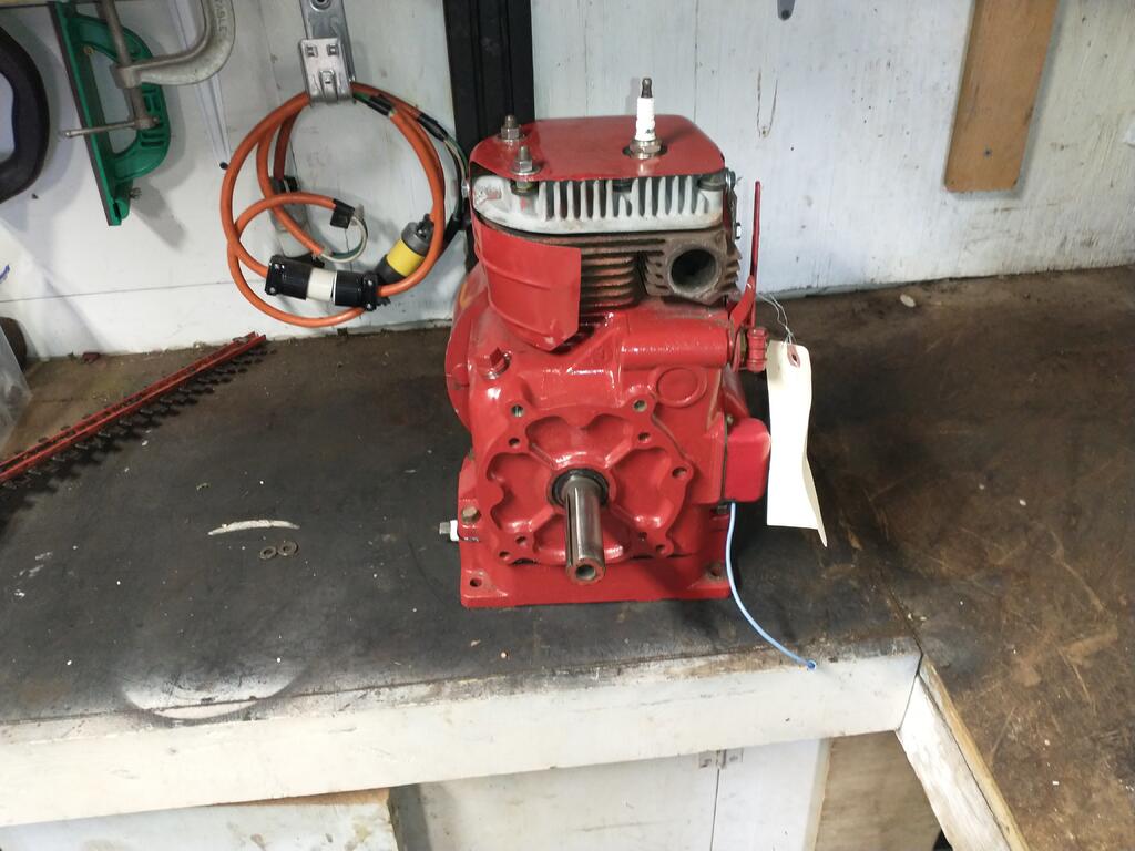

Brockport Bill 1,822 #14 Posted May 7, 2022 8 hours ago, JoeM said: Primer yes and a light scuff with 500. I have used both rattle cans and the Rustoleum drys much better. Hardener is a must in either for mix and spray. Rustoleum sprays better, but is not as shiney. but good. Using a HVLP gun I use acetone as the thinning agent. 5/2 mix. I like mixing the hardener in the thinner then add that mix in the paint. 2 coats okay but 3 is best. I like the first coat to be a light tack coat. 20 minutes between coats by the watch! Both paints fade in the sunlight and I use a clear enamel over top. (Rustoleum rattle can) This gives a better UV protection. A word of caution, neither of the paints dry as well as automotive paint, and if your going to clear, I would wait at least two weeks cause it will lift. Light coats no puddles. The clear cuts and buffs nice if you are wanting show quality. Not bad results for $45 a gallon paint. Base paint not dry when clear was applied Testing the clear Magic base with Rustoleum clear not buffed. Cut and buffed side panel. Rustoleum base with clear sanded and buffed Majic base on hood. do you have a photo of can of the Rustoleum "clear" you put on as final coat Share this post Link to post Share on other sites

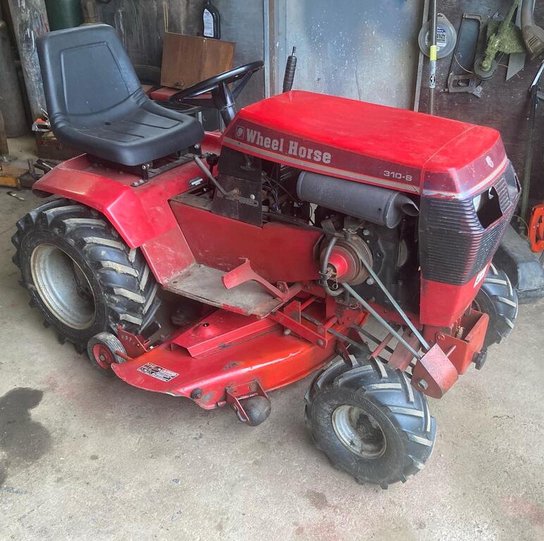

Ifixoldjunk 778 #18 Posted May 7, 2022 @JoeM Man those pictures make me wanna do my 310-8. just gotta hurry up and find a few more new parts and she’ll be ready 1 1 Share this post Link to post Share on other sites
