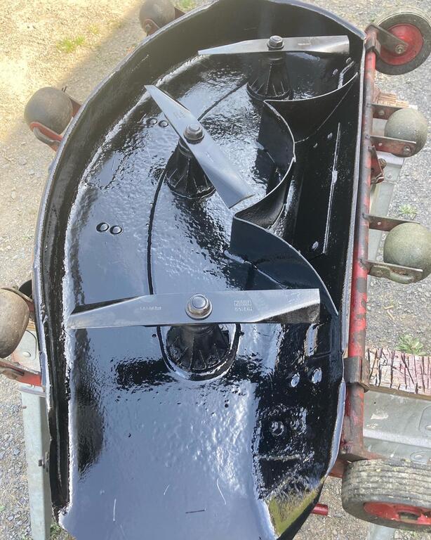

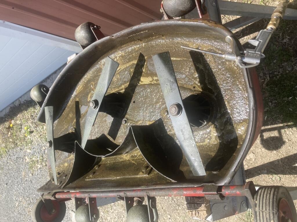

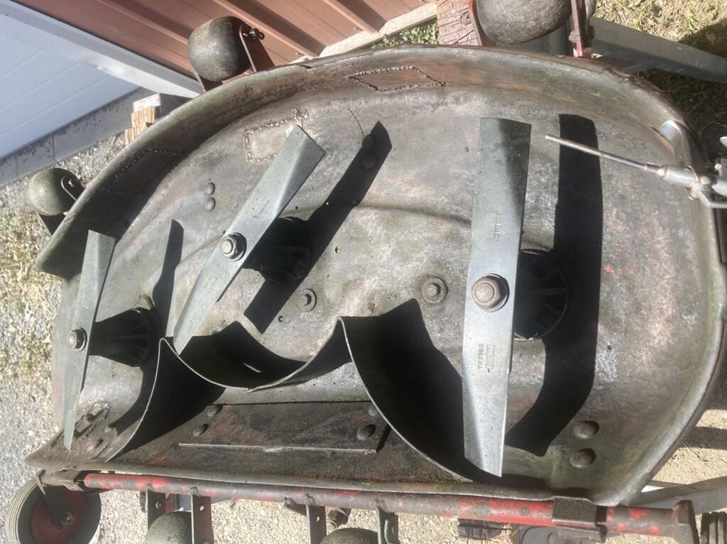

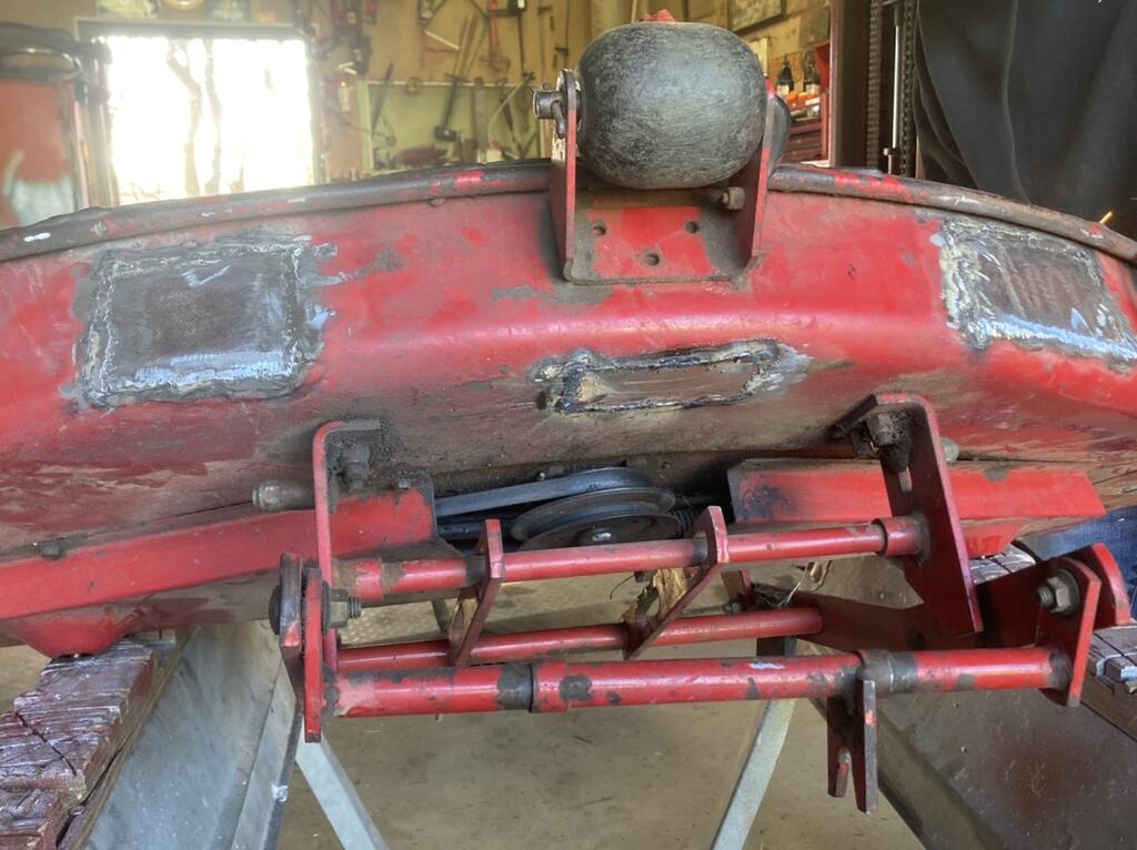

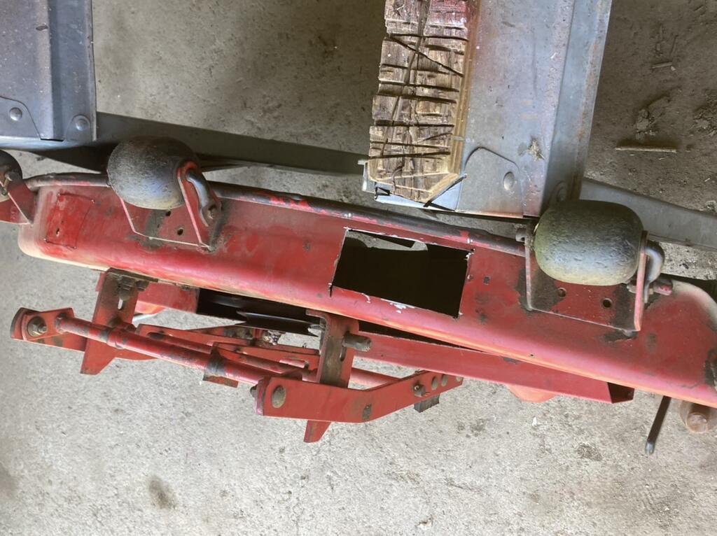

Ifixoldjunk 778 #1 Posted May 2, 2022 So I finally got around to repairing my rusty 42 side discharge. Figured I’d get it ready before the bulk of mowing season. started off by hacking out all the thin and blown through sections. Probably had to patch about 4 sections. The worst of it was around the front curvature. Which makes sense seeing that’s where most of the grass will clump. Although there was still plenty of good steel which surprised me. I degreased and cleaned the underside as well as I could. The POR-15 degreaser is some serious stuff. It turned all the rust and grass into liquid. I started off with two coats of POR-15. After that I hit it with a few coats of agriculture enamel. I know it looks fairly pitted but most pits are only the thickness off a fingernail. Anyways I’ll probably give it one more generous coat of agriculture enamel and it should hold up for quite some time. I don’t really have sandy dirt so it hopefully will last 7 5 Share this post Link to post Share on other sites

Jeff-C175 7,203 #5 Posted May 3, 2022 21 hours ago, Ifixoldjunk said: two coats of POR-15. After that I hit it with a few coats of agriculture enamel Let us know how that works out. I've been leary about top coating por with anything but por, especially after it's cured, being afraid that it won't bond. 2 Share this post Link to post Share on other sites
Ifixoldjunk 778 #6 Posted May 3, 2022 @Jeff-C175 Yeah i was worried about that as well, but the POR-15 kit said any oil based paint will be able to stick 1 1 Share this post Link to post Share on other sites
