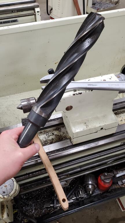

bds1984 1,457 #19 Posted April 26, 2022 5 hours ago, Pullstart said: that’s the style of drill that ate my hand a while back. 7/16” eats meaty flesh pretty quickly! It could have been worse than a 7/16 bit.... 1 4 Share this post Link to post Share on other sites

clueless 3,028 #22 Posted April 27, 2022 (edited) 21 hours ago, bds1984 said: It could have been worse than a 7/16 bit.... "My that's a big one". Edited April 27, 2022 by clueless 2 Share this post Link to post Share on other sites
