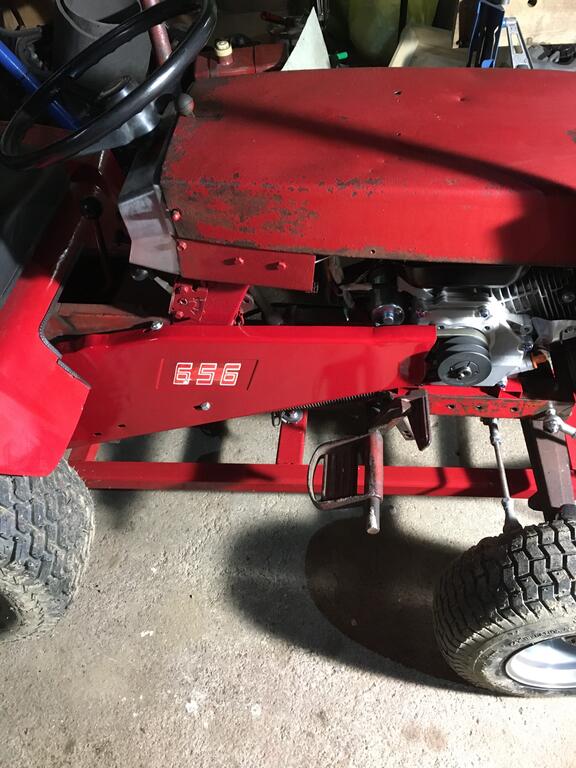

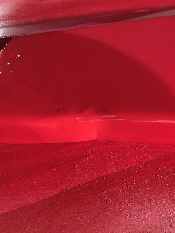

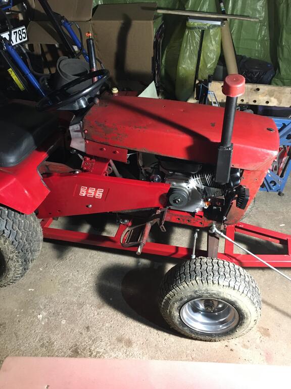

Tractorhead 9,065 #21 Posted April 24, 2022 I used a inch bigger on the Front ( Engine side) Therefore i must rework a little bit the Beltcover but not too much. I cutted the original cover and bend it up, inserted a long triangle Steelchop welded it on and repaint it. Can also be used with the Stock pulley. Share this post Link to post Share on other sites
