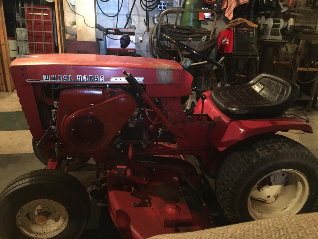

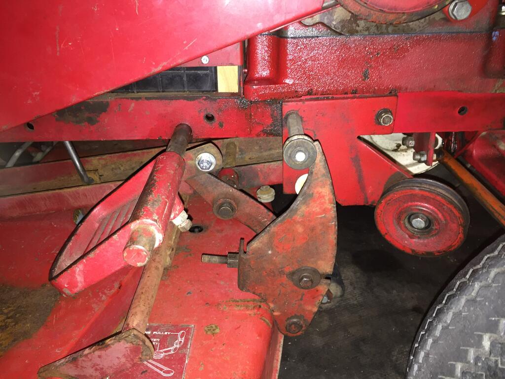

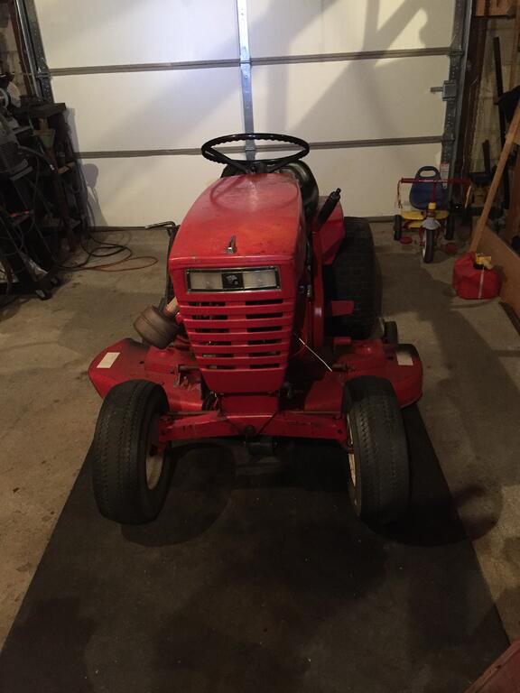

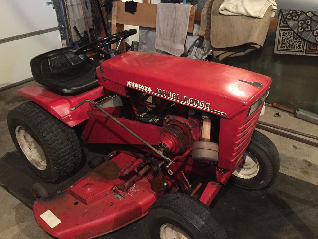

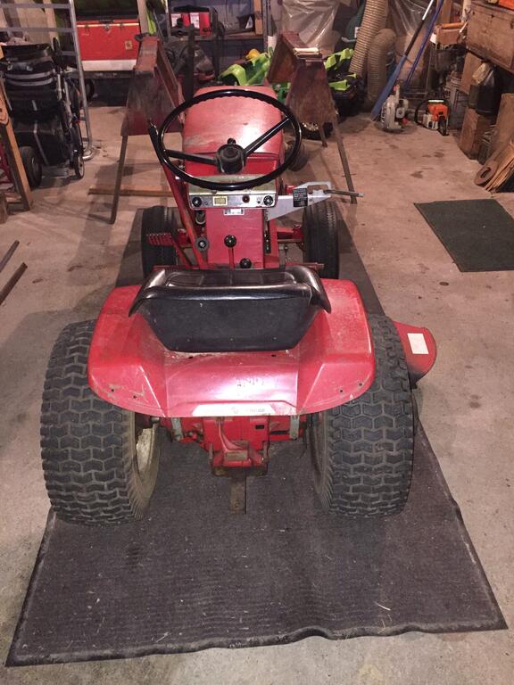

JimSraj 430 #1 Posted April 21, 2022 This is the T 1267 tractor that I got last summer with a broken rod. I really only wanted parts from the deck mounting to use on a 1969 GT14 I was working on but the P.O. would not separate. The price was reasonable so I ended up with another tractor. After I got looking this one over I thought it was a pretty good looking tractor and just needed a good motor. So I decided to try a rebuild. I had never done this before but I figured if I can follow directions I should be able. Anyway it’s done and running well. Now I’m Trying to get the RL486 mowing deck back on it and can’t seem to get the belt tensioner on the deck lift shaft and on the part that swings from the tractor frame and goes through the hole in the top of the 6725 part of the tensioner assembly. As far as I can tell the deck and mounting parts on the GT 14 and this one are the same. I wanted to include a video but 12.27 MB limit won’t allow it. Any help confirming the tractor model and year and/or tensioner issue will be greatly appreciated. Share this post Link to post Share on other sites

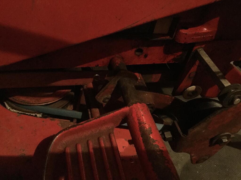

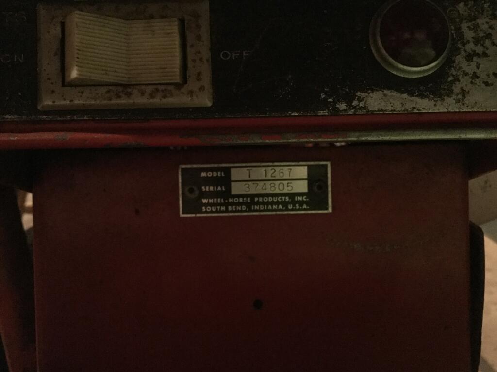

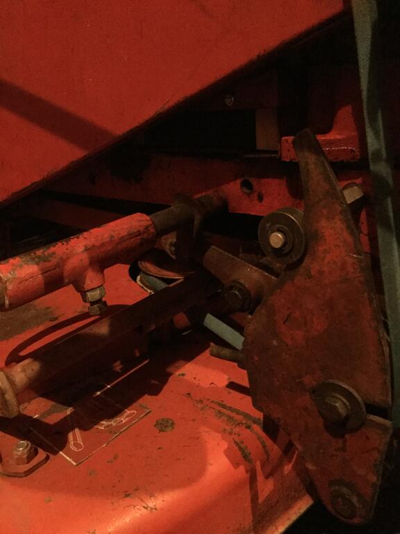

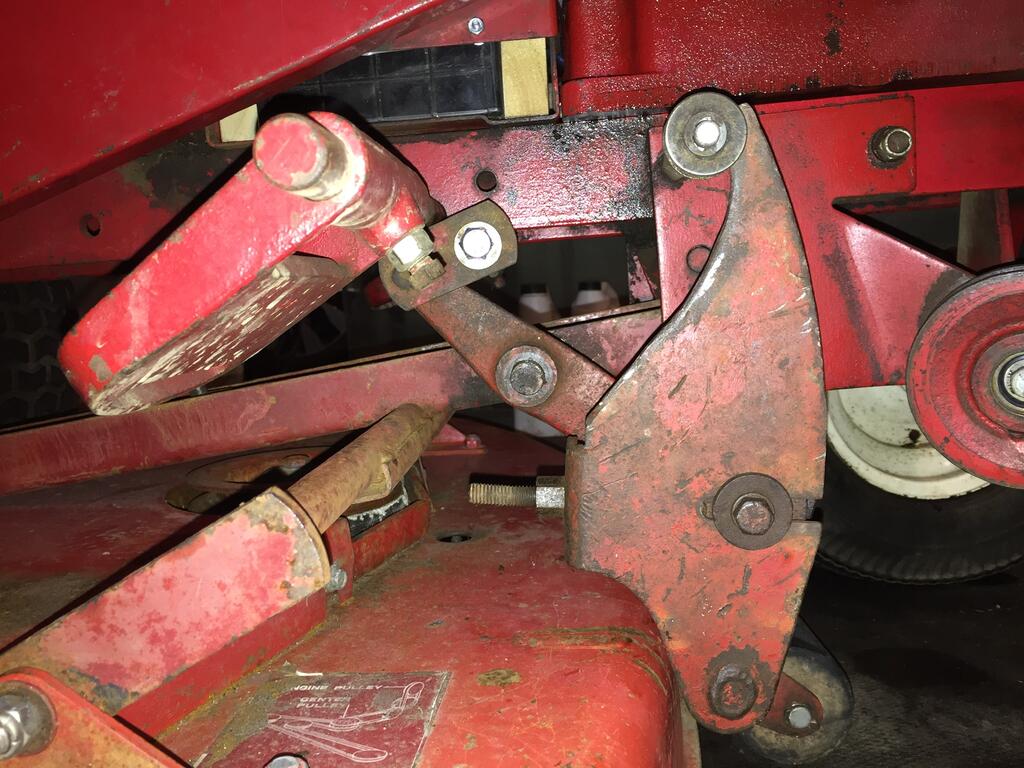

JimSraj 430 #4 Posted April 22, 2022 I’ve taken a few pictures to show the tractor as well as the problem I am having getting the pivot arm and the cam arm installed. Picture shows the pivot arm on the lift assembly shaft. But, as I hope is obvious, the cam arm end is stuck under the pedal shaft. I can get either one where it belongs but not both. What am I missing? Also, I’m still not sure what year and model this tractor is. Is it just a T1267. Or is it a Raider 12 as the PO told me? Share this post Link to post Share on other sites
953 nut 55,712 #5 Posted April 22, 2022 The pictures in this manual are not too good but perhaps @pfrederi or someone else with this type of mower drive can provide som better pictures. Share this post Link to post Share on other sites

JimSraj 430 #7 Posted April 23, 2022 (edited) It Looks like the problem may be solved. Thanks 953nut for the mower manual. I was trying to get the cam arm assembly to mount to a hole in the frame as it is on my GT14. On this tractor it goes on the foot pedal shaft. It’s on now and everything looks good. Belt is on and ready for a trial run tomorrow. 🤞 Can anyone I’d this tractor for year and model? PO said he thought it is a 1967 Raider 12 but he wasn’t sure. Edited April 23, 2022 by JimSraj 1 Share this post Link to post Share on other sites
953 nut 55,712 #8 Posted April 23, 2022 On 4/21/2022 at 10:53 PM, JimSraj said: Is it just a T1267. Or is it a Raider 12 as the PO told me? 8 hours ago, JimSraj said: Can anyone I’d this tractor for year and model? You have a Model 1267, Twelve HP; six speed; built in 1967. That was the general method og coming up with model numbers in the '60s. Share this post Link to post Share on other sites
