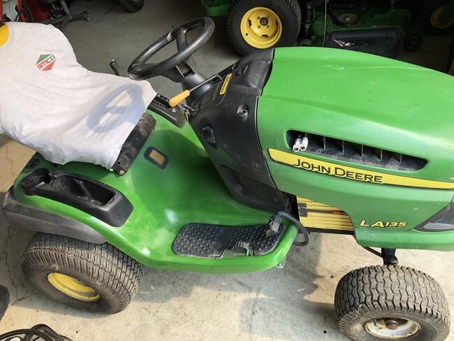

Evguy 556 #1 Posted April 19, 2022 Something different, neighbor was trashing a jd mower with blown engine. During Covid downtime I put this together to move trailers etc. Other than pulley and belt, I had the parts in the shop. 3 8 Share this post Link to post Share on other sites

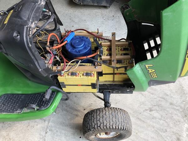

SylvanLakeWH 27,592 #2 Posted April 19, 2022 Very cool! How about some more details…? Motor type. Voltage. Battery type. Connecting motor to frame system… 1 Share this post Link to post Share on other sites
Evguy 556 #3 Posted April 19, 2022 29 minutes ago, SylvanLakeWH said: Very cool! How about some more details…? Motor type. Voltage. Battery type. Connecting motor to frame system… The motor was salvaged from a powered pallet jack, had it for a decade, I machined the gear off the shaft and fitted a pulley. the voltage for motor was 12v but I increased it to 16 to get enough rpm. batteries are lithium 3.5 volt. I simply made a aluminum plate to widen surface area and fit motor and batteries to the frame. It is inefficient due to motor, but has a lot of torque with hydraulic drive, enough to roll a tire off rim while pulling a trailer. I probably get 1/2 hour running time. 1 1 Share this post Link to post Share on other sites

Evguy 556 #13 Posted April 19, 2022 Just now, Snoopy11 said: What brand you runnin' ...? Trojan... Interstate? EDIT: Batteries... I mean... Don Using some 100ah lithium batteries from a EV I decommissioned, lighter weight Share this post Link to post Share on other sites

8ntruck 7,395 #18 Posted April 20, 2022 (edited) What sort of temperature control are you using on the lithium batteries - if any? Edited April 20, 2022 by 8ntruck Share this post Link to post Share on other sites
Evguy 556 #19 Posted April 20, 2022 12 hours ago, 8ntruck said: What sort of temperature control are you using on the lithium batteries - if any? I have no heating in the batteries, I also have no bms I check balance periodically. 1 Share this post Link to post Share on other sites
