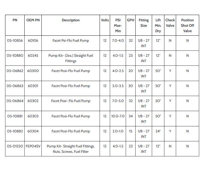

bo dawg 536 #7 Posted April 18, 2022 1 hour ago, 953 nut said: I switched several of my Wheel Horses over to electric fuel pumps and the hard starting problems went away. Mount it on the frame lower than the tank, wire it to a circuit that is powered when the key is on (like the hour meter) and protect it with a fuse (5 amps is fine). So what pump is it you used? And is there a plategasket that gos over the hole where the factory pump was? 1 Share this post Link to post Share on other sites
pfrederi 19,267 #8 Posted April 18, 2022 Facet posiflo have several never an issue. Made in USA good enough for aircraft good enough for WH. There is a plate you can buy but you can make your own or leave the pump in place 5 Share this post Link to post Share on other sites
bo dawg 536 #9 Posted April 18, 2022 So I assume that the Hipa vac style pumps are not that great like originally on the 520s? 1 Share this post Link to post Share on other sites
bo dawg 536 #10 Posted April 18, 2022 7 minutes ago, pfrederi said: Facet posiflo have several never an issue. Made in USA good enough for aircraft good enough for WH. There is a plate you can buy but you can make your own or leave the pump in place The pressures are adjustable? Is lower the better so you dont flood carb? 1 Share this post Link to post Share on other sites
pfrederi 19,267 #11 Posted April 18, 2022 Not adjustable. I have used both 2.0-1.0 and the 4.0-1.5 no issues. My problem with pulse pumps is if they fail they can suck fuel n the crankcase... 6 Share this post Link to post Share on other sites
pacer 3,177 #12 Posted April 18, 2022 Electric, hands down!! and the Facet .... type? is preferable (there are after mkt clones (square shaped) also and I have had good luck with them) The MANY electrics shown on the bay can be ... overwhelming? But one type seems to have a high failure rate and that is the round shaped ones, would not recommend them.... 4 Share this post Link to post Share on other sites
WHX?? 53,330 #13 Posted April 18, 2022 (edited) 36 minutes ago, bo dawg said: Is lower the better so you dont flood carb? I would think so. I used the cheapy 2-3 psi jungle ones on customers tractors with no issues. Yah Pacer worried about how long they would last cause guys report they had issues. Couple out there for two three years now and no complaints. The carb float should keep the engine from flooding out but if the carb inlet has got crap in it all bets are off. Filter in front of the pump then. I know when @dclarke put one on my 520 he used a better one but he's a classy guy! Edited April 18, 2022 by WHX?? 2 2 Share this post Link to post Share on other sites
