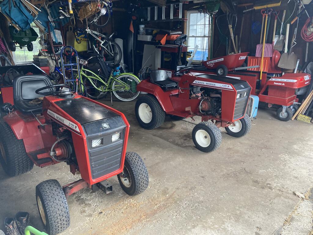

SylvanLakeWH 26,597 #4 Posted April 15, 2022 15 minutes ago, WHX?? said: Yes they do they'll be along. I need to make one too. Clips into the front attach like the mule drive. Sylvia? @SylvanLakeWH @Ed Kennell ??? Bought mine off eBay. Just search “Wheel Horse Front Hitch” on eBay. Works great. Snaps right in front attach a matic… pics of mine on my C 105 and then pic from eBay. 6 Share this post Link to post Share on other sites

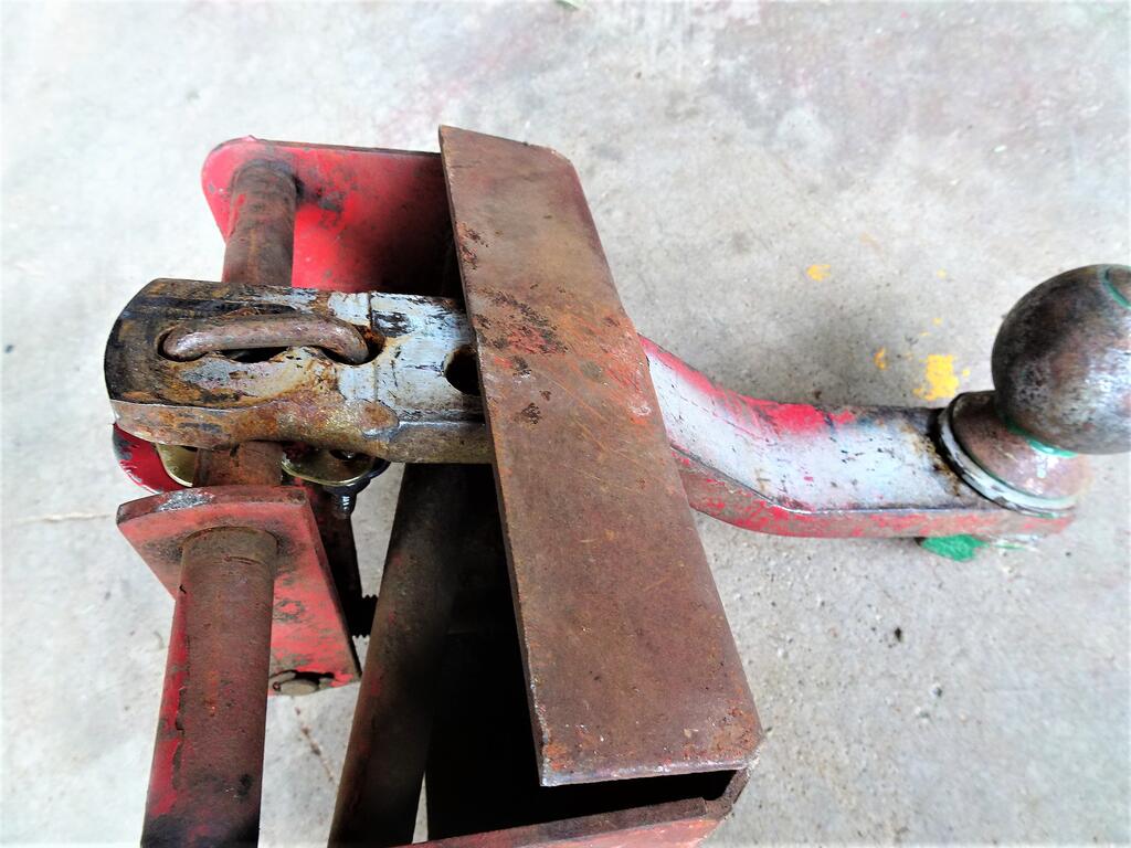

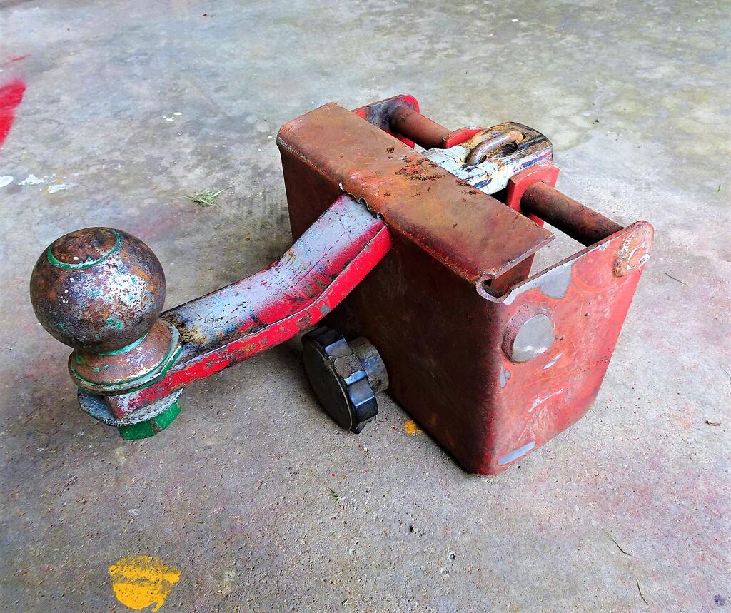

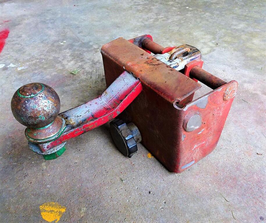

clueless 3,075 #7 Posted April 15, 2022 5 hours ago, SylvanLakeWH said: Bought mine off eBay. Just search “Wheel Horse Front Hitch” on eBay. Works great. Snaps right in front attach a matic… pics of mine on my C 105 and then pic from eBay. the He also sells one that bolts to the front and is permanent and doesn't interfere with the mule drive, I have both the 2" receiver for my 416 and the permanent one on my 312. The 2" receiver is nice if you need the ball to be higher and you have a 2" hitch that has a drop or rise . The permanent one on the 312 can hold at least a 300# tongue weight, I use it 95% of the time and don't have to remove the mule drive. I also have a change a ball on it, can change it from a 1 7/8" ball to a 2" ball in about 10 seconds. 1 1 Share this post Link to post Share on other sites

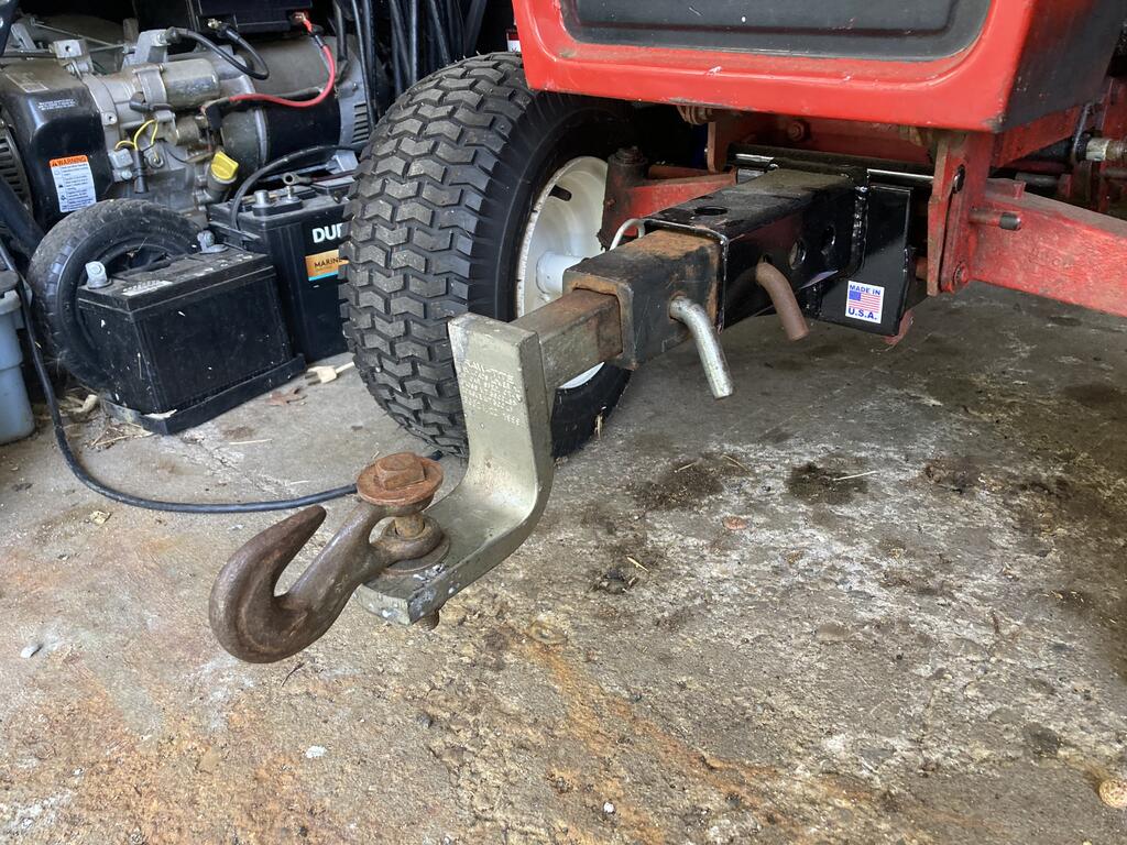

Ed Kennell 39,754 #8 Posted April 15, 2022 I don't have a front reciever mount, but I do have a front hitch. I think this was a U shaped channel part from the walk behind tiller I cut apart and mounted on the front of the plow frame. It simply bolts to the face of the mule drive and does not interfere with the mule drives operation. I use it mainly for parking boats in tight spaces. I can also attach a regular drop pin trailer . Oh yeah, be careful not to bang into the grill when you're hooking up. 6 1 Share this post Link to post Share on other sites
