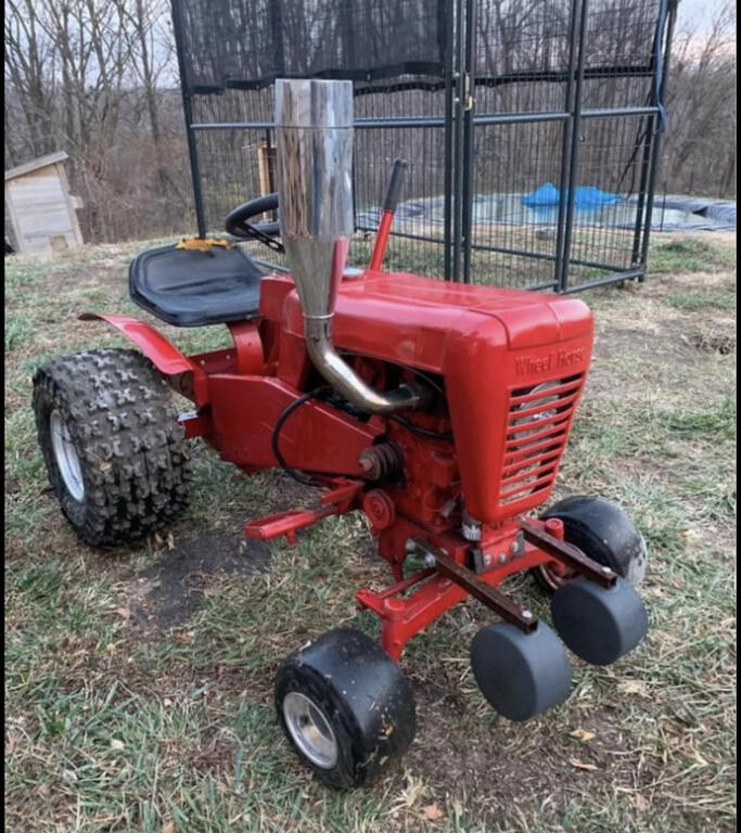

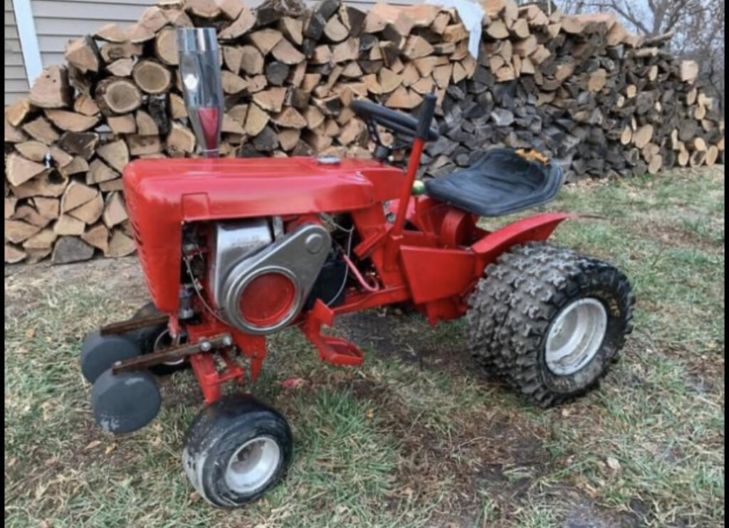

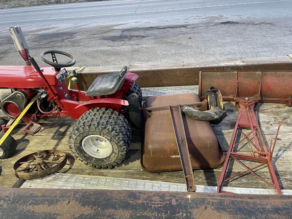

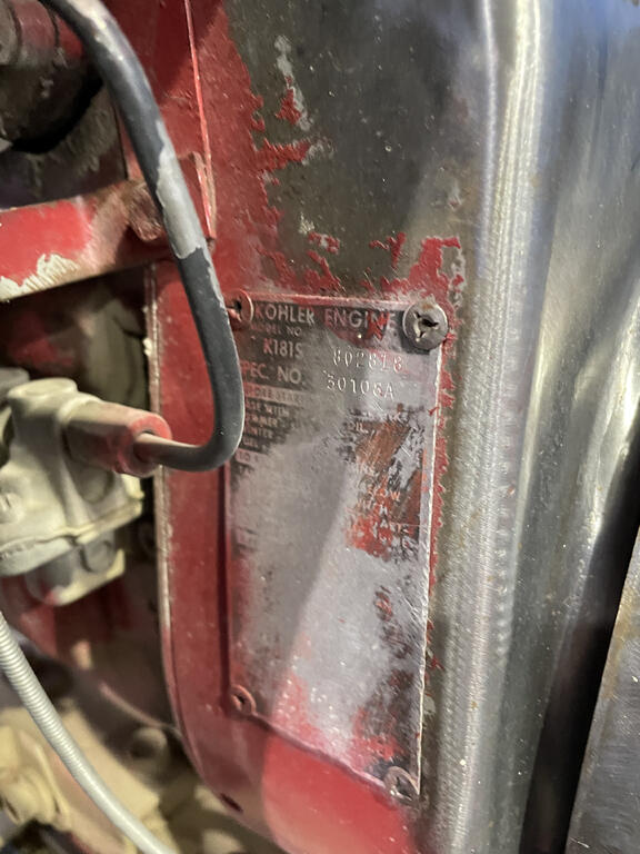

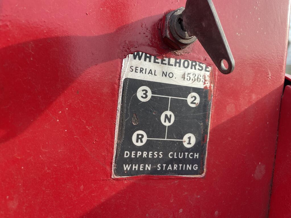

Okay friends husband and I brought home another mutilated mutation that I felt sorry for and wanted to fix….  Questions will it run??  Lol… what model for sure?  So I believe it’s an 854 and would like feed back to confirm..  lots of stuff coming off… has the k181s tag on the engine!  Two piece gas tank!  So if my friends on here would agree or disagree I would be able to see how much I have been learning over the years!

Looks a lot like my 854, there's quite a few modifications on that tractor.

These was the pictures my husband was sent before we got it!

I've been wrong before, but many of the parts and shape of things look very similar to an 854.  Man can these tractors go through changes over the years. :text-lol:

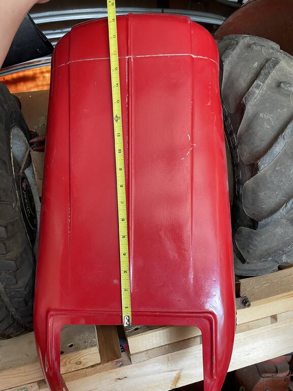

I agree it "looks" like an 854, definitely later than 1962. Could be a 753 with the K181 added. A couple of ways to tell - does it have the longer 8 HP air cleaner? Measure the hood  854 hoods are about 1 inch longer if measured along the center rib in front of the gas tank up to grill section - compare it to your 702.

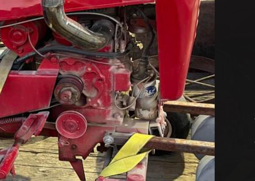

Is that PBR can a coil holder?

Alcohol injection system… Kinda like nitrous but, not… :auto-layrubber:

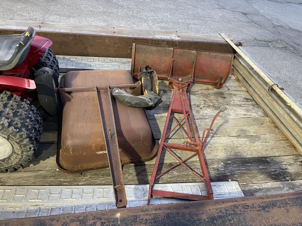

The plow is a very early one - probably around 1962 - the "Jockey shift" angling handle gives it away. It does not use a Unidrive mount, instead it is loosely fastened to the two lower holes on the sides of the frame plate.

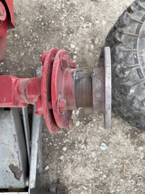

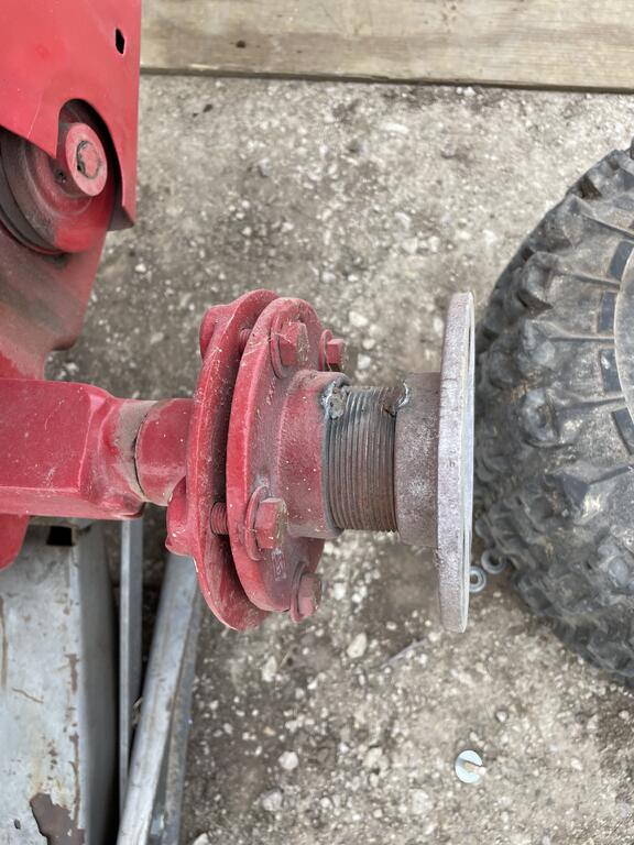

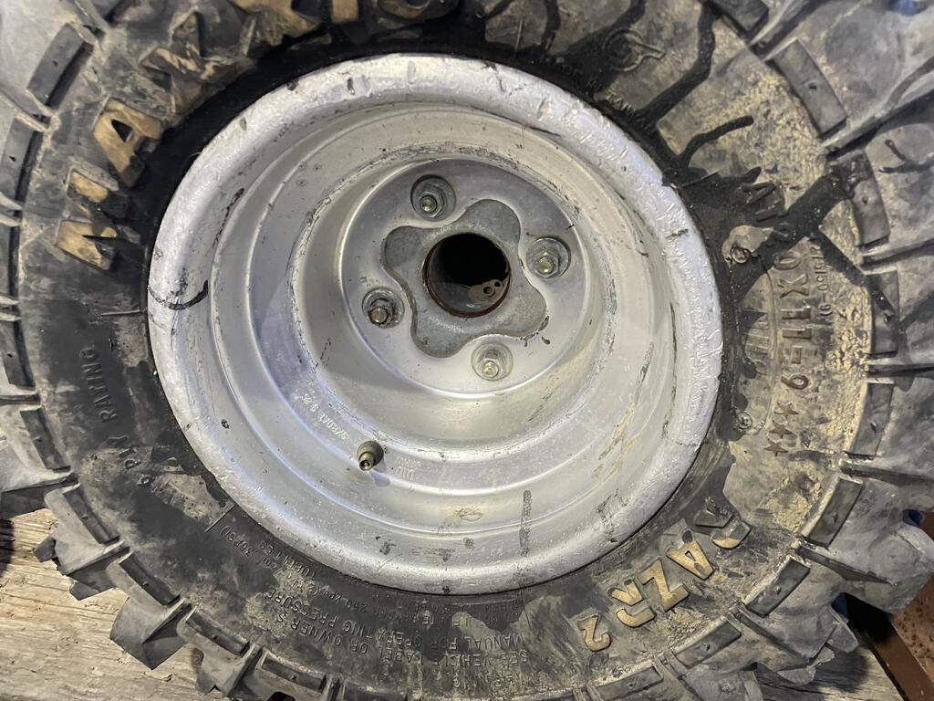

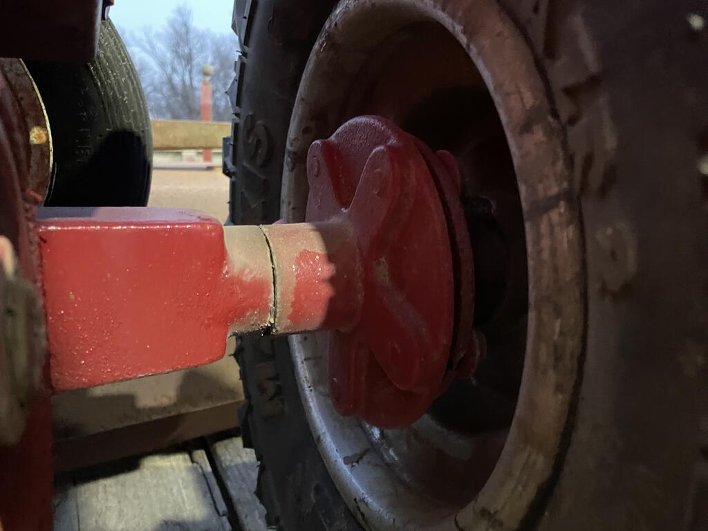

I’d like to see how those 4 bolt wheels are on the stock hubs… if you get the rear wheels off I’d love a picture :handgestures-thumbupright:
Lee1977
8 pictures down there is an extra plate bolted to the hub ,

Lol yep they rapped it … it’s being removed

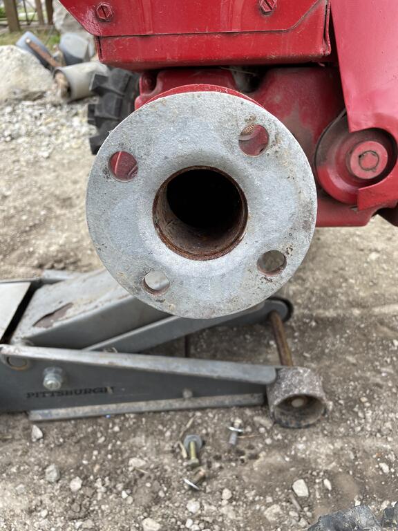

Yes they made some sort of adapter from wheel horse 5 bolt to the 4 bolt rims they have on it

J854D

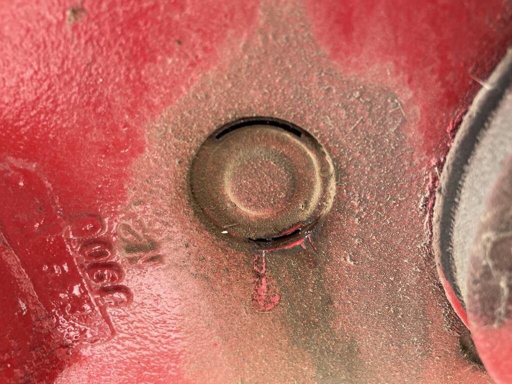

Your serial number 45369 is in line with the other serial numbers listed in the Red Square file section for the 854 model. In fact it looks like @gwest_ca may have already added your serial number to the list not that long ago. -JD-

Yes husband spied it right away and the guy says no it’s for Massey Ferguson my husband argue I decided just to buy it and be happy lol…

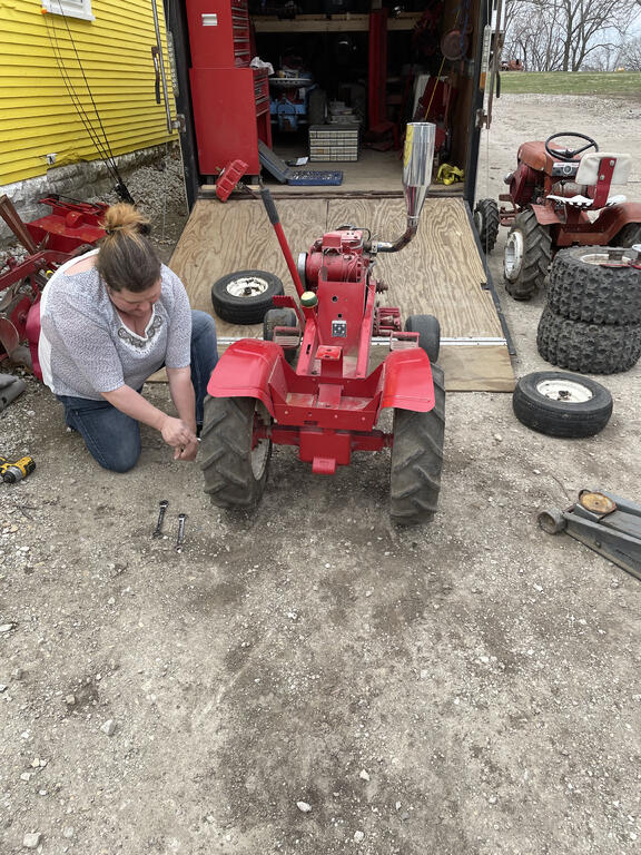

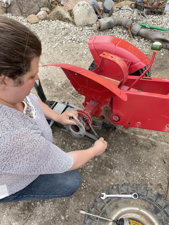

Changed out the wheels already!  Will have the correct ones when meet up with Wes in May!  Front will work for now!

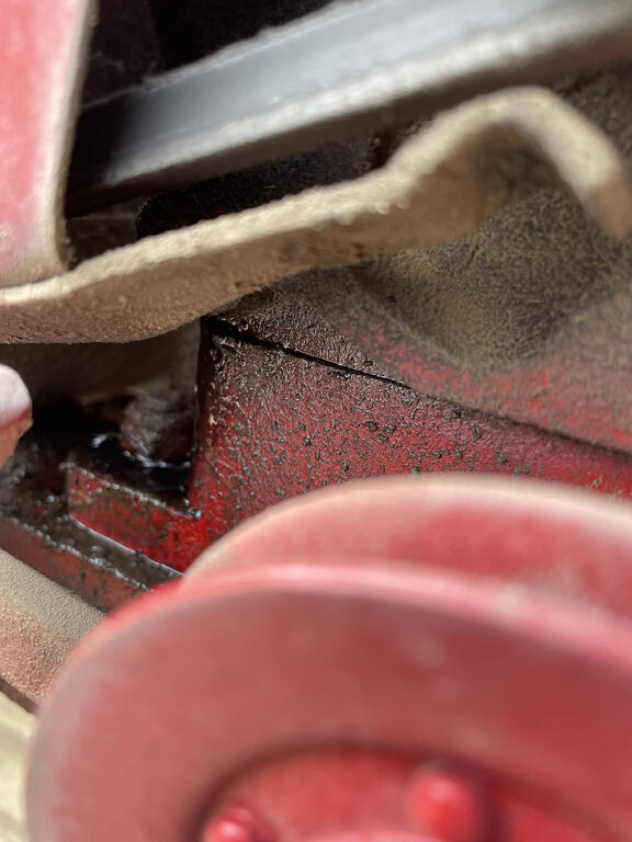

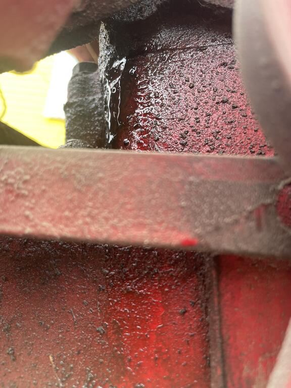

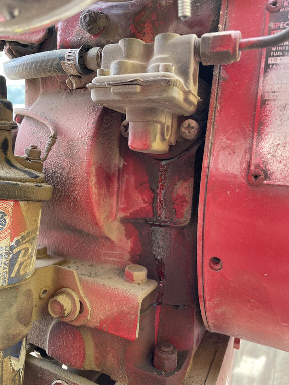

Lots of leaking!!!  Transmission only has reverse and 1st. Engine pan gasket needs replaced and fuel pump gasket!  Lol
