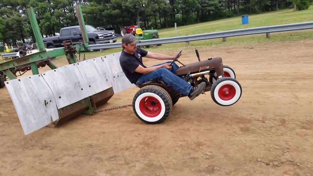

TJ5208 1,824 #1 Posted April 9, 2022 If you were pulling dead weight where would you want the hitch would you want it higher or lower. I figured higher would pull better because the weight is pushing down on the rear tires. 1 Share this post Link to post Share on other sites
roadapples 6,983 #2 Posted April 9, 2022 Higher may want to lift the front end... 4 Share this post Link to post Share on other sites
Pullstart 63,866 #3 Posted April 9, 2022 There’s a perfect balance as to where it lifts the front tires just barely so ALL the tractor’s weight is on the drive tires. This is puller talk here. For use around your property, you’ll want to steer of course. Pullers generally have adjustable height hitches for just this reason. Track conditions play a big role in this figure too. For most all around the house work, hitch height shouldn’t matter. Just add more weight to the tractor. 4 Share this post Link to post Share on other sites
953 nut 57,057 #4 Posted April 9, 2022 If you take a look at the big boy pulling tractors you will see that all the added weight is low for added stability. Hooking low also adds stability. Many garden tractor pullers have an adjustable weight bar at the front that allows the weight to be extended forward to suit the traction needed for that track. Dan @Achto says weights are for sissies! 2 1 3 Share this post Link to post Share on other sites
