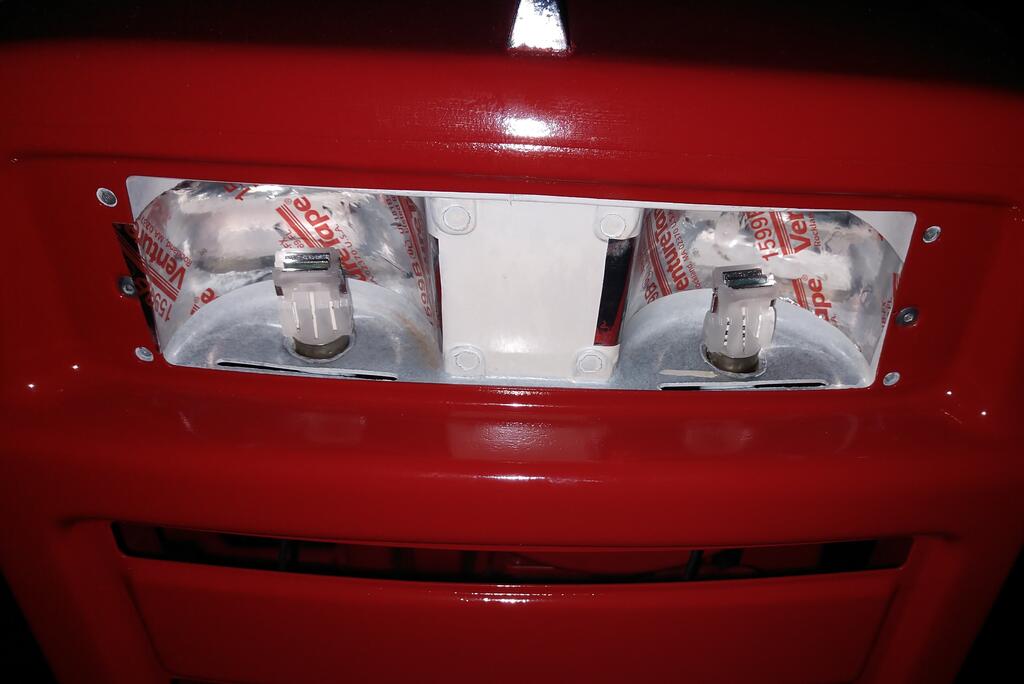

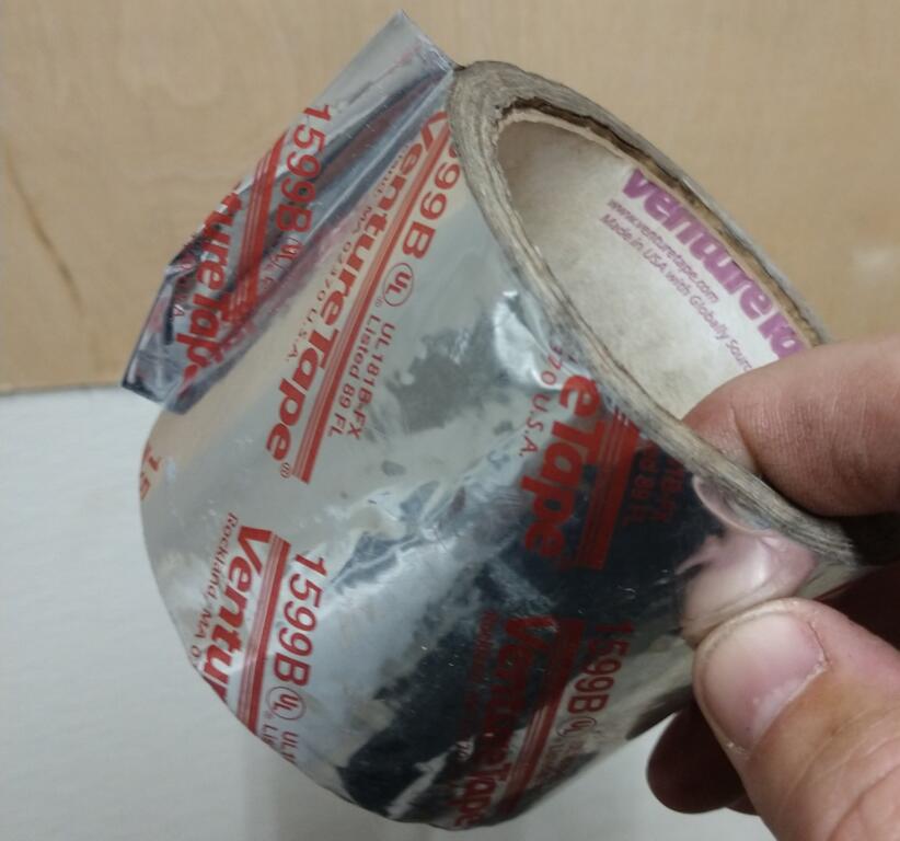

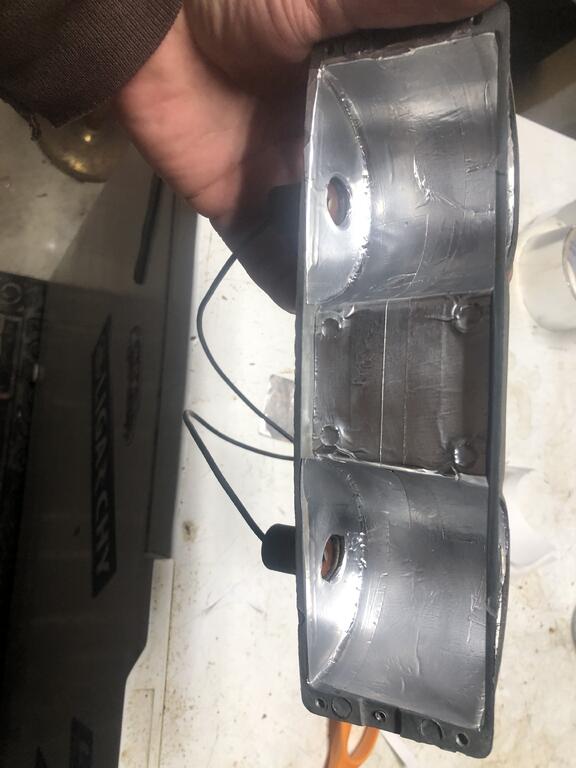

Rob J. 1,942 #1 Posted April 8, 2022 I’m sure this is done all the time but my attempt to brighten up the bucket. I used aluminum pipe tape. Have some 6000 lumen LED’s going in. Should be bright. 4 5 Share this post Link to post Share on other sites
WHX?? 53,322 #2 Posted April 8, 2022 (edited) @Achto just did a resto on one and used a chrome plating paint of sorts on it. Post 158 I tried polishing one once but didn’t have the right tool to get in there for a shine finnish. Edited April 8, 2022 by WHX?? 6 Share this post Link to post Share on other sites
ebinmaine 75,743 #3 Posted April 8, 2022 Nice work Rob! 1 1 Share this post Link to post Share on other sites
Maxwell-8 4,370 #4 Posted April 9, 2022 12 hours ago, Rob J. said: I’m sure this is done all the time but my attempt to brighten up the bucket. I used aluminum pipe tape. Have some 6000 lumen LED’s going in. Should be bright. Looks great! just a question do those led's have cooling fans? If they really are 6000lumens, that would draw around 600w from the electrical system and would be generating a lot of heat. 1 Share this post Link to post Share on other sites
Handy Don 15,174 #5 Posted April 9, 2022 (edited) 1 hour ago, Maxwell-8 said: Looks great! just a question do those led's have cooling fans? If they really are 6000lumens, that would draw around 600w from the electrical system and would be generating a lot of heat. I think with an LED this would be more like 50 watts @ 12v. So about 4 amps. But if it is only a 3 amp charging circuit, it will be a net drain on the battery. Edited April 9, 2022 by Handy Don 1 Share this post Link to post Share on other sites
ebinmaine 75,743 #6 Posted April 9, 2022 4 minutes ago, Handy Don said: I think with an LED this would be more like 50 watts @ 12v. So about 4 amps. But if it is only a 3 amp charging circuit, it will be a net drain on the battery. He's got a '73 with a Kohler 8 so it likely has a 15 amp output. Should be good 👍👍 2 Share this post Link to post Share on other sites
WHX?? 53,322 #7 Posted April 9, 2022 1 hour ago, ebinmaine said: Should be good Way good ... my measurements on led bulbs show they draw alot less than what guys think they do. Since one can't really read resistance on them and plug that into Ohm's law the only way to know is actually measure the amp draw. They really do throw a monkey wrench at Mr Ohm since there is no way that I know of to convert lumens to amps. Remember they are rated in EQUIVELENT watts so the rated wattage is useless as far as using it in math. You ever got nothing better to do @squonk bust out yer Fluke and see what yours draw. 3 Share this post Link to post Share on other sites

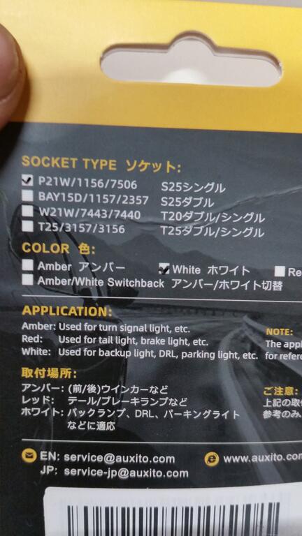

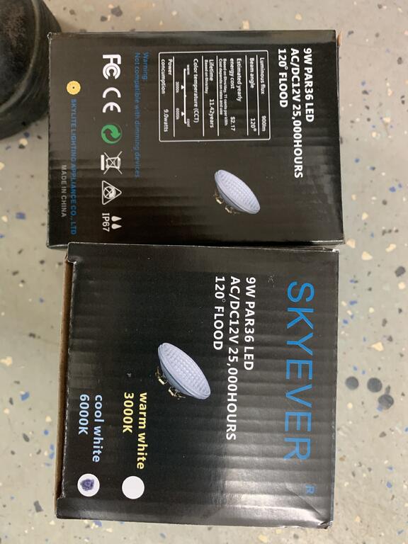

Horse Newbie 7,398 #14 Posted April 9, 2022 (edited) Maybe @Rob J. meant to say 6000k… is that the same as 6000 lumens ? I am putting these in my 1984 Work Horse GT-1600 which I believe charges at about 3-4 amps… Will they be okay ? Hope I’m not highjacking this thread… BTW, what does that actually mean ? Edited April 9, 2022 by Horse Newbie 2 Share this post Link to post Share on other sites
Handy Don 15,174 #15 Posted April 9, 2022 (edited) 6 minutes ago, Horse Newbie said: Maybe @Rob J. meant to say 6000k… is that the same as 6000 linens ? I am putting these in my 1984 Work Horse GT-1600 which I believe charges at about 3-4 amps… Will they be okay ? Hope I’m not highjacking this thread… BTW, what does that actually mean ? If you can trust the label, it claims 9w power consumption per lamp. Mr. Ohm says W ÷ V = A. So 9 ÷ 12 = .67 amps each. So less than 1.4 amps together. If the only other loads are charging the battery and running the tractor, you will be just fine. BTW: - lumens is a measure of brightness or total quantity of light energy in the visible spectrum (i.e. light humans can see) - K is a measure of the color of the light (6000K is a very white light with a tinge of blue, lower numbers have more yellow) Enjoy! Edited April 9, 2022 by Handy Don 5 2 Share this post Link to post Share on other sites

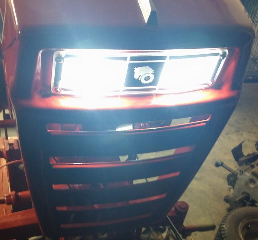

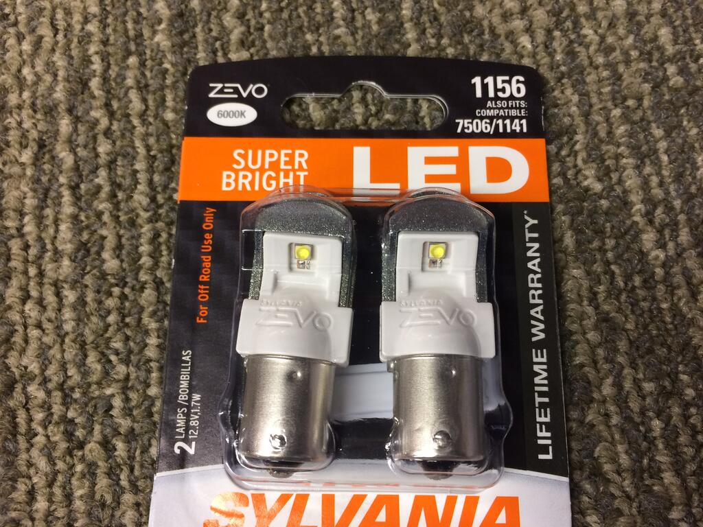

squonk 44,860 #19 Posted April 9, 2022 (edited) 1 hour ago, WHX?? said: Way good ... my measurements on led bulbs show they draw alot less than what guys think they do. Since one can't really read resistance on them and plug that into Ohm's law the only way to know is actually measure the amp draw. They really do throw a monkey wrench at Mr Ohm since there is no way that I know of to convert lumens to amps. Remember they are rated in EQUIVELENT watts so the rated wattage is useless as far as using it in math. You ever got nothing better to do @squonk bust out yer Fluke and see what yours draw. I use these bulbs now. Nice and bright and my meter shows they draw a tenth of an amp. I had the tractor at the Steam Pageant and a guy comes up to me and tells me the lights kept turning on an off all night by themselves. (problem with the rocker switch) and the battery would still start the tractor without charging it. They are rated at 1.7 watts. $28 for the 2 Edited April 9, 2022 by squonk 3 1 Share this post Link to post Share on other sites
Rob J. 1,942 #20 Posted April 9, 2022 Sorry yes 6000k white light. Geez don’t make a mistake on this site. But yeah thanks for correcting me. 3 Share this post Link to post Share on other sites
Handy Don 15,174 #21 Posted April 9, 2022 23 minutes ago, Rob J. said: Sorry yes 6000k white light. Geez don’t make a mistake on this site. But yeah thanks for correcting me. Actually, 6000 lumens is feasible. A medium-sized ATV or off-road vehicle lightbar will throw that much light and I've got one only slightly smaller on one of our tractors! The package stated 900lm (luminous flux?) in excruciating fine print! 2 Share this post Link to post Share on other sites

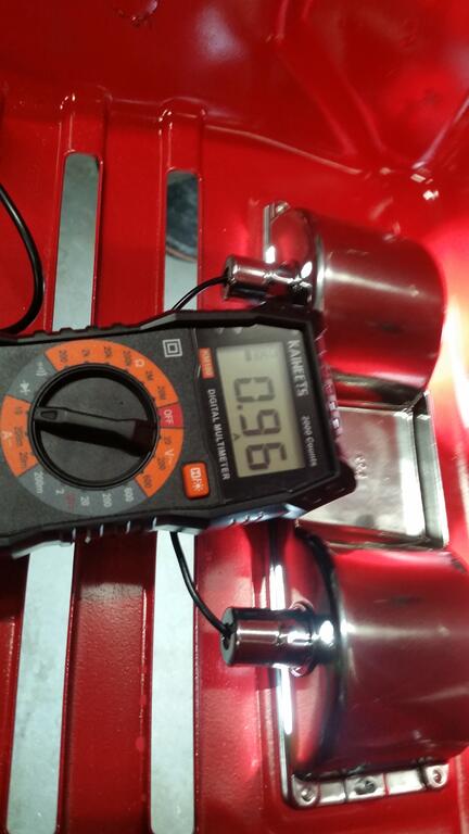

WHX?? 53,322 #23 Posted April 9, 2022 Just for grins put an ampmeter on @Achto 867 resto. 1 amp both bulbs and very bright. Specs wasn't listed on the package but he said they were in the jungle. 1 Share this post Link to post Share on other sites
Achto 30,193 #24 Posted April 9, 2022 8 minutes ago, WHX?? said: Specs wasn't listed on the package but he said they were in the jungle. From the specs on the Jungle site. 【Specification & Note】Voltage: DC 12V. Power: 7W/Bulb. Lumen: 3200LM/Pair. Color: 6000K white. 2 Share this post Link to post Share on other sites
kpinnc 16,183 #25 Posted April 10, 2022 I used chrome tape in my FILs Charger, with LEDs. Worked great! Makes you wonder what the old incandescent lights were even for, because they are about 1/4 as bright as LEDs. 5 Share this post Link to post Share on other sites
