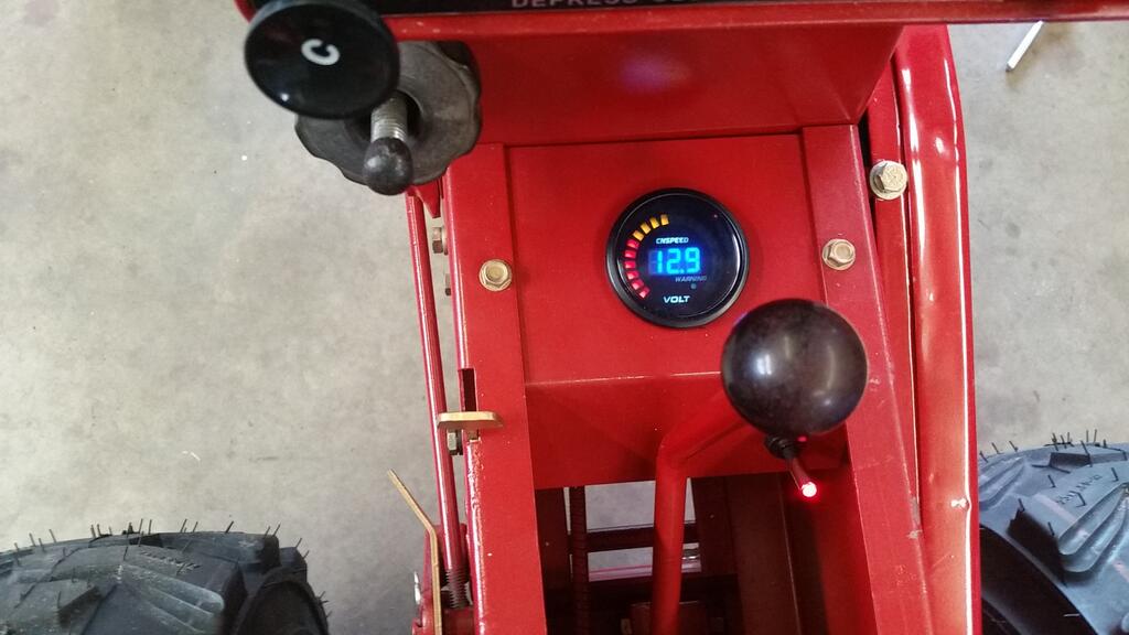

I got this one just for eye candy.... Put the same one on my C-145 for functionality as to monitor battery volts since it doesn't have regulation . works great.

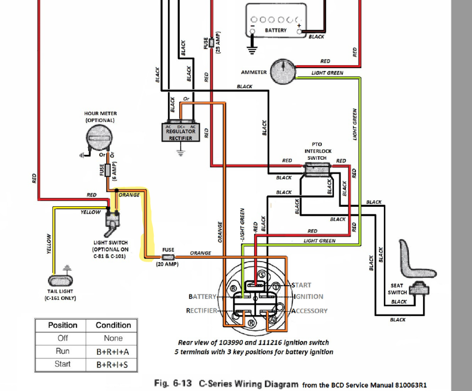

Here ya go Stegs.
You DO NOT want to tie it to an ammeter lead as Don suggested. DISCONNECT THE BATTERY  If your battery is in front of the dash remove it for best access. Remove the ammeter and tie the wires together and insulate well and install the volt meter.
Negative of the voltmeter to ground. Positive to the orange wire that I highlighted in yellow AFTER the fuse. You should not have to mess with the ignition switch at all although greasy Pete Lena would recommend checking the plug and switch terminals for corrosion and applying some dielectric grease just for upkeep.
The hot side of the light switch would be a good place to land the + from the voltmeter. Make sure all other connections are good, including grounds,  while you are in there and securely tie wrap things out of the way. Reconnect the battery
Done !
Your tractor may not have the color wires as depicted if someone else was in there molesting things.
Diagram is from a 78/79 C series.
Tractor 1978-79 C-Series Wiring SM Color.pdf
Edited by WHX??
Handy Don
I agree with WHX??. His way is certain to work--mine can leave the voltmeter live all the time and be a slow drain on the battery, even if it isn't illuminated.
