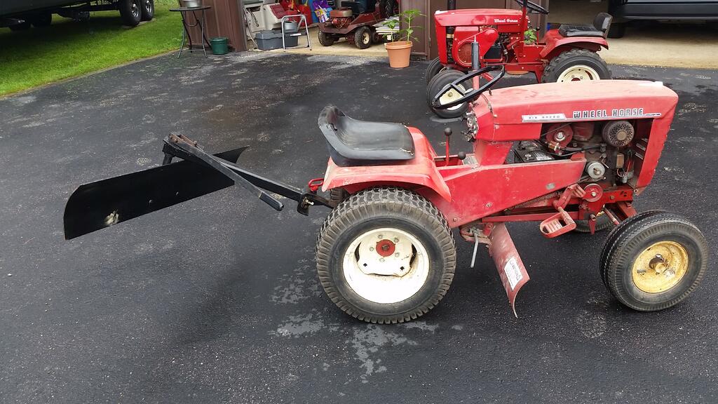

JoeB 34 #1 Posted April 4, 2022 (edited) Hello, It seems every time I try something new I have to come here to get some wisdom. My latest challenge is installing a grader on my 321 hydro. I can attach it to the quick connect but I don't see where to attach the link to my hydraulic system. If I raise it as high it will go, the three holes in the part that I attach my snowblower to are all to low. The chain that lifts the mower is attached about that but I don't see how to reach it and if I did I would have to remove the chain which doesn't seem right. Sorry if I don't have the names of these parts right, but I hope you know what I mean. It seems like a need a short linkage bar between the hydraulic and the grader blade. Any wisdom would be much appreciated. I forgot to mention, its a pull grader. Best, joe Edited April 4, 2022 by JoeB Share this post Link to post Share on other sites

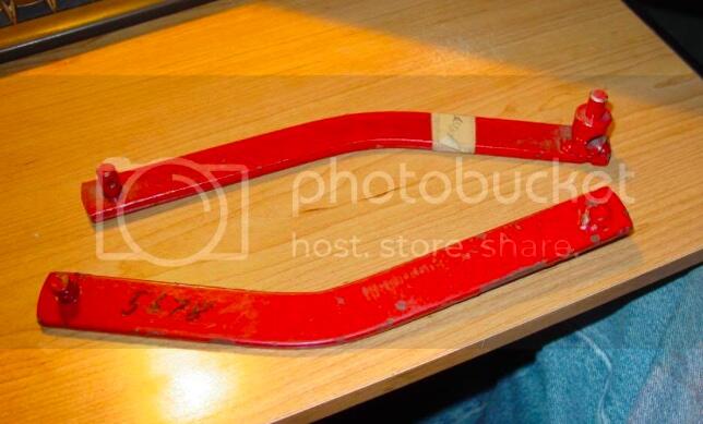

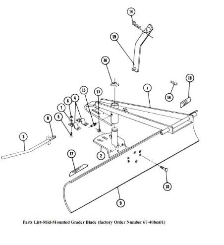

stevasaurus 23,069 #2 Posted April 4, 2022 I'm not going to be able to answer your question, but I might be able to point you in a direction. Is it a Wheel Horse grader blade?? If so, do you know the model number? If not, I would look in the Manuals Section for grader blades and they should show how to hook them up. The hook up should be common to most 300 & 400 series horses. I have a feeling the solid link is what you want to have...Wheel Horse made several lengths of solid links, but you could make your own. 1 Share this post Link to post Share on other sites
JoeB 34 #3 Posted April 4, 2022 The grader is a Wheelhorse and looks just like the picture below. The linkage it looks like the bottom one in the picture on the left. Perhaps I need the upper linkage? Share this post Link to post Share on other sites

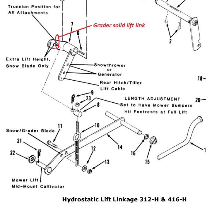

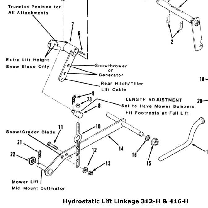

JoeB 34 #5 Posted April 5, 2022 (edited) thanks for the image. However I don't see the place to attach the grader so that I can apply down pressure. The hole labeled snow/grader I think is for the front plow rather than the mid frame grader. thanks again, best, joe Edited April 5, 2022 by JoeB Share this post Link to post Share on other sites
oliver2-44 10,370 #6 Posted April 5, 2022 Go to Wheelhorse Parts and More website and they sell the grader blade solid lift link that go from the hole in the above diagram to your grader blade 1 Share this post Link to post Share on other sites

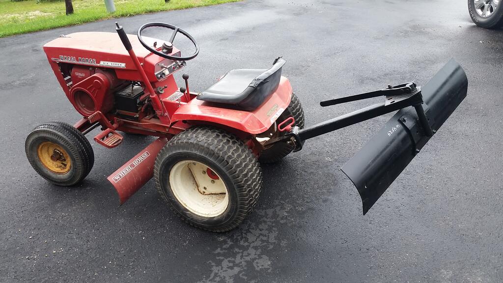

WHX?? 50,740 #8 Posted April 5, 2022 (edited) Might be this one but best to call Lowell to make sure. He will know what you need. https://wheelhorsepartsandmore.com/product/toro-wheel-horse-5678-mid-mount-grader-blade-lift-linkage/ Just to get the jargon right the black one in back is a pull behind or rear blade. The one up front is called a mid mount. Edited April 5, 2022 by WHX?? 1 Share this post Link to post Share on other sites
squonk 42,554 #9 Posted April 5, 2022 19 hours ago, JoeB said: The grader is a Wheelhorse and looks just like the picture below. The linkage it looks like the bottom one in the picture on the left. Perhaps I need the upper linkage? You use the upper link and attach it to where the diagram says "all other attachments " I remove the chain thingy and the mower deck lift bar when using the mid grader. Share this post Link to post Share on other sites
JoeB 34 #10 Posted April 5, 2022 Thanks all for all the good information. Two other questions. It seems I have to remove the mover lift linkage from that trunnion. Is that the case? Second I have a terrible time trying to get the linkage rod up there to attach it. Perhaps my hands are too big. Any tips on the best way to do that? Thanks again joe Share this post Link to post Share on other sites
Lee1977 7,037 #11 Posted April 6, 2022 15 hours ago, JoeB said: Thanks all for all the good information. Two other questions. It seems I have to remove the mover lift linkage from that trunnion. Is that the case? Second I have a terrible time trying to get the linkage rod up there to attach it. Perhaps my hands are too big. Any tips on the best way to do that? Thanks again joe Yes. it's a pain to attach those parts on a 312. There isn't an easy way to attach to that lift point on a 312. That lower panel is removable but all the wiring is attached to it and will come unattached if moved enough to get your hand in there. A reason to buy another Wheel Horse a C-series 1973 to 1977 they are easier to get to that lift point. The mower deck lift bar you may be able to tie it up out of the way. I can't say for sure as my grader blade is home made and my lift point on the blade might be different. Share this post Link to post Share on other sites
oliver2-44 10,370 #12 Posted April 6, 2022 I have C series and tie the mower deck lift bar out of the way. The lift point is a little easier to get to on a C series, but not much. Share this post Link to post Share on other sites
