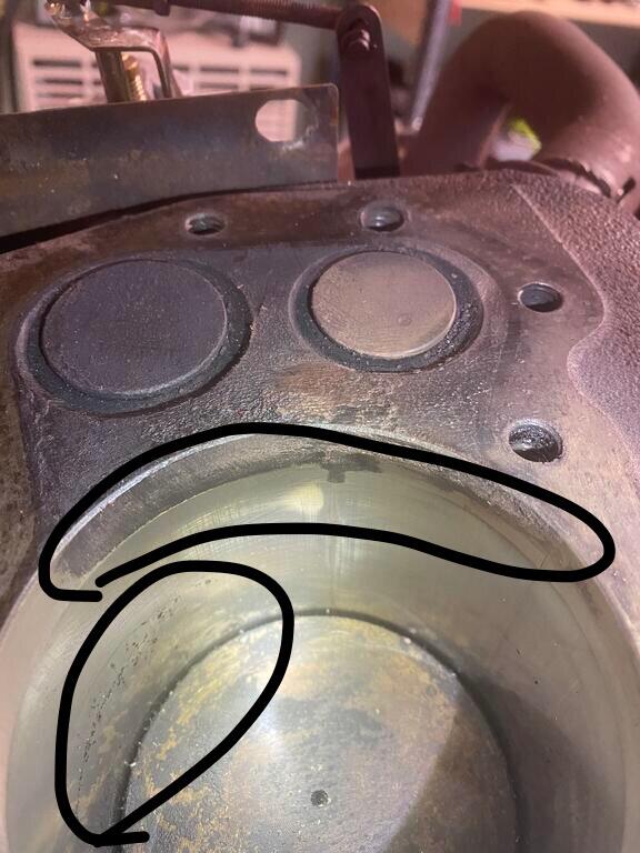

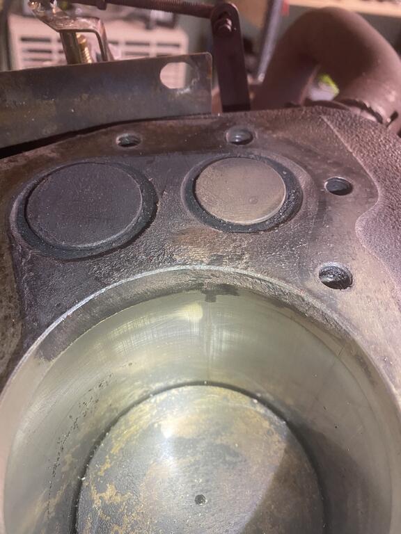

Hi. I have a C121 which starts right up but lacks power. A compression check indicated 30lbs of pressure. I took the head off hoping maybe it’s just a gasket, but I think the cylinder needs to be honed or bored out. Based on the attached pics, is this block still good and would honing fix it?

I should mention that only the top of the cylinder looks bad, the stuff on the sides is just dust from my shop.
That engine has automatic compression release. You will get a low number unless you can spin the engine fast enough to override the release. A cylinder leakage test will give you more accurate results. Harbor Freight sells a decent tester.

Thanks Squonk. Should I be concerned about the ridges at the top of the cylinder?
The ridge is the area above the ring travel. If it is just carbon build-up that is fine but it is probably a sign of the cylinder wear, you should be able to borrow or rent a "Ridge Reamer from most auto parts stores.

This looks more then just the typical ring ridge. Additionally, the cylinder appears to be pitted maybe from water sitting there at one point.
I believe a bore will be required.
