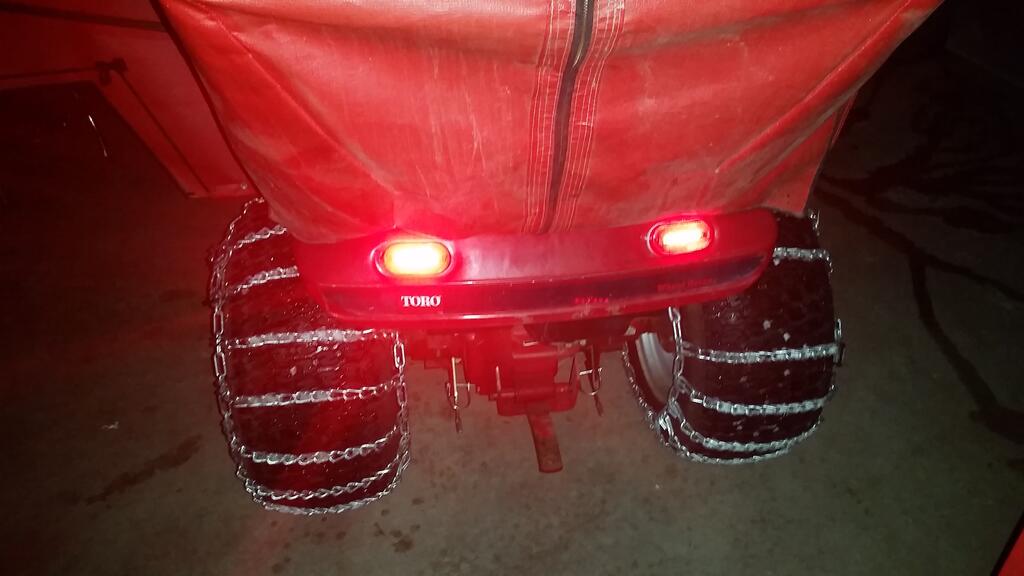

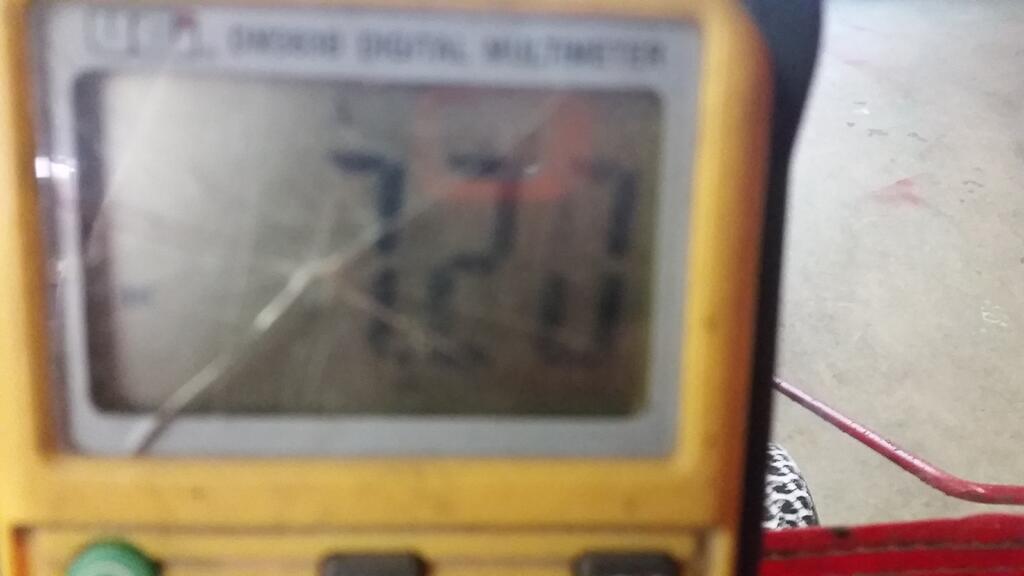

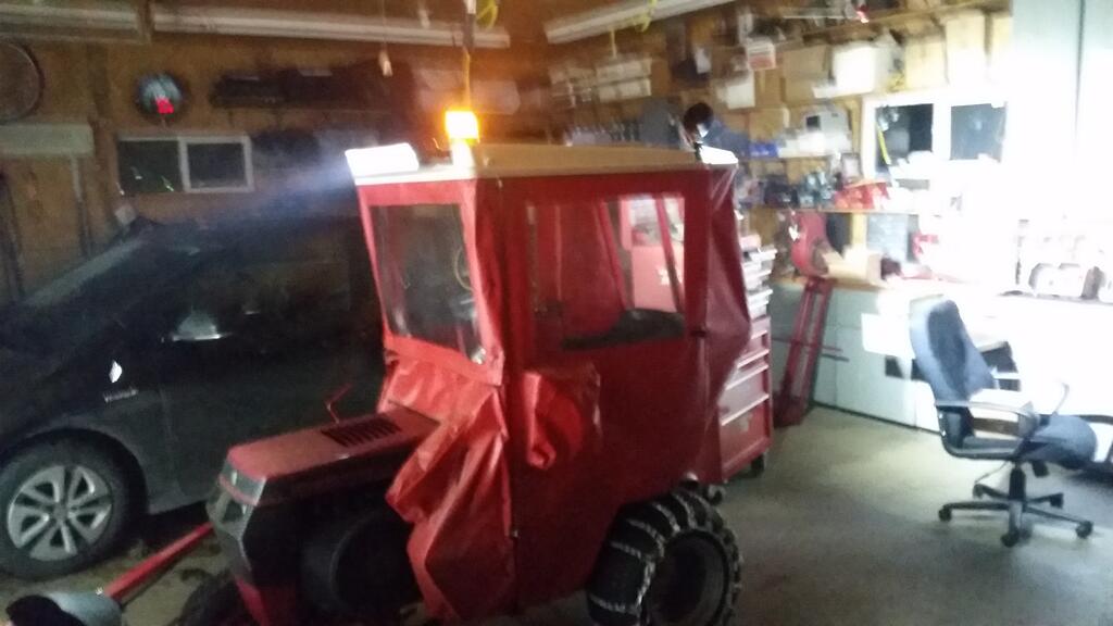

WHX?? 49,923 #11 Posted March 22, 2022 (edited) If you have access to a DMM Dan you can easily measure the amount of current the lights use. Best practice is fuse the lights with a less than 15 amp fuse. These lights Drew this So I fused them all at 10 amps which is well below the 20 amp output of the tractor. Ohm law is a great tool to have in one's tool box but I like to see it for real. The rated wattage can be different than what the manufacturer says and actual battery voltage plays a part. Also led's are rated in an equivalent wattage which can throw a monkey wrench into calculations. https://www.youtube.com/watch?v=HsLLq6Rm5tU Edited March 22, 2022 by WHX?? 3 Share this post Link to post Share on other sites
