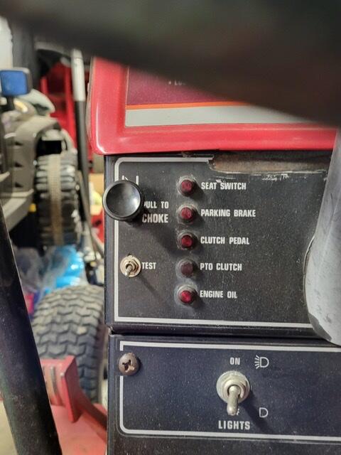

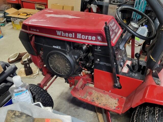

AHS 1,482 #1 Posted March 20, 2022 Ok, what year is this? The model number is faded so bad you can’t see it. It has a 6 terminal key switch. The key switch is new and the solenoid is new… but it won’t start by the key. The seat switch has three wires… not two like you’d normally expect. It must be the clutch or PTO switch? I have one wiring diagram, but it’s the wrong one due to the wire colors and the seat switch having two wires. I’m stumped, I’m all ears!😀 Share this post Link to post Share on other sites

JCM 9,916 #3 Posted March 21, 2022 If the steering wheel is the original one which it probably is, It appears to be an 85, 6 or 7. 11 hours ago, AHS said: Ok, what year is this? The model number is faded so bad you can’t see it. It has a 6 terminal key switch. The key switch is new and the solenoid is new… but it won’t start by the key. The seat switch has three wires… not two like you’d normally expect. It must be the clutch or PTO switch? I have one wiring diagram, but it’s the wrong one due to the wire colors and the seat switch having two wires. I’m stumped, I’m all ears!😀 1 Share this post Link to post Share on other sites
AHS 1,482 #4 Posted March 21, 2022 @JCM Excellent! 85 was the year that they did AC headlights and DC ignition. I have an 85 310, a whole different ball of wax! 😀 1 Share this post Link to post Share on other sites
953 nut 56,754 #5 Posted March 21, 2022 '85 and '86 had the K Series Kohler engines, '87 was the first year for the Magnum in a Wheel Horse. 2 1 Share this post Link to post Share on other sites

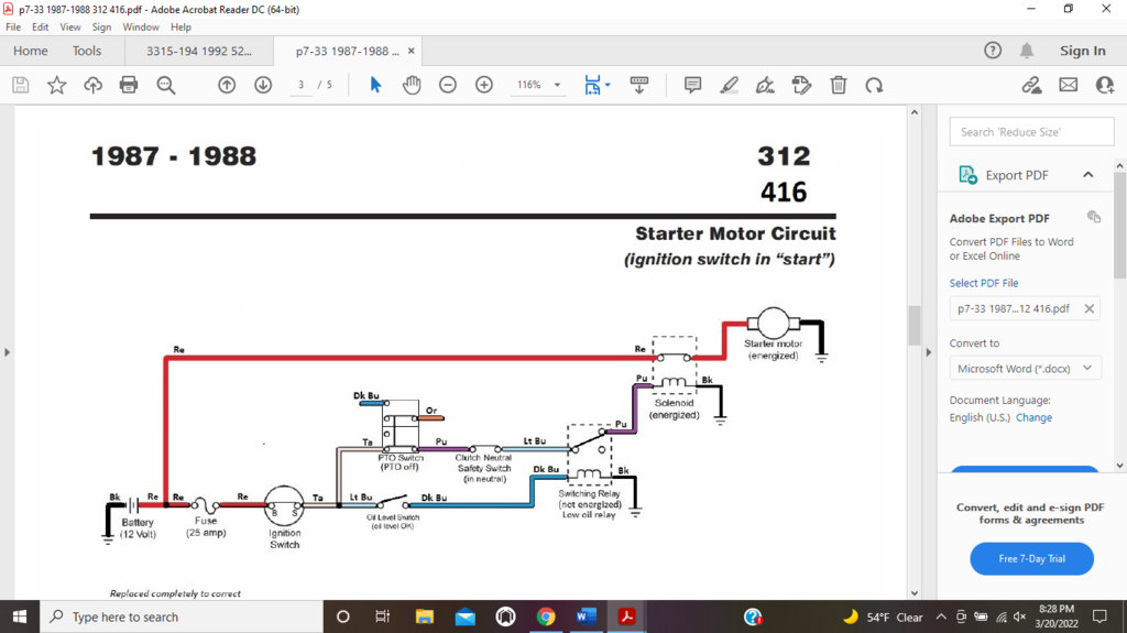

AHS 1,482 #6 Posted March 21, 2022 @953 nut So, I should have continuity (W/ clutch pedal pressed and PTO off) from Tan to lt blue? Yes, the solenoid is grounded. Your wiring is for 87-88, is that the only one that took 6 terminal key switch’s? Share this post Link to post Share on other sites
AHS 1,482 #7 Posted March 21, 2022 1 minute ago, 953 nut said: '85 and '86 had the K Series Kohler engines, '87 was the first year for the Magnum in a Wheel Horse. It must be an 87?😀 Share this post Link to post Share on other sites
gwest_ca-(File Mod) 11,176 #8 Posted March 21, 2022 Have the serial number of the engine? That will tell you what year Kohler made the engine. Could be the same year as the tractor or one model year newer. 3 Share this post Link to post Share on other sites
953 nut 56,754 #9 Posted March 21, 2022 The ignition switch number from the factory was 111215 which was replaced by 103-991 and has been used on Magnum powered Wheel Horses for several years. 3 Share this post Link to post Share on other sites
