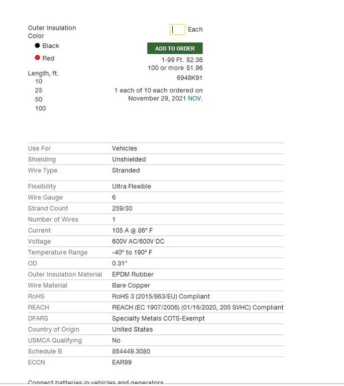

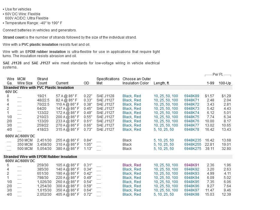

pfrederi 18,181 #8 Posted March 13, 2022 For battery cables you want 6ga and having it very flexible makes installation and routing easier. Strand count is key yu want a big number lots of very fine wires make it flexible. 3 Share this post Link to post Share on other sites

Handy Don 13,085 #13 Posted March 13, 2022 (edited) 3 hours ago, pacer said: I am not a 'purist' and what with the horrible ammeter wiring on the horses cooking bout half the wiring on our horses.... I just started buying the trailer wiring 'kit'. You get 7 different colors of good grade wire in long lengths.... cheap! It can be a bargain, but read the descriptions carefully. A lot of the trailer light hookup wires are 16 ga (and sometimes even smaller!) and it is common to find copper coated aluminum instead of full copper under those niftily colored jackets! IMHO, while it can be cool to have fat wiring for the starter it is electrically overkill. Using 6 ga (as supplied with most electric-start WHs) along with proper solid connections and excellent grounds is plenty with capacity to spare. These are just not long enough for the gauge to have a significant impact on current flow. Flexible wiring makes initial installation easier, but even the stiffer stuff is fine once you've formed it to the shape you need. In a car or truck, the engine moves relative to the body and chassis so flexible connections are useful and last longer. On a WH, not so much (shaker mounts being the exception, of course). Edited March 13, 2022 by Handy Don 2 Share this post Link to post Share on other sites

pfrederi 18,181 #15 Posted March 13, 2022 45 minutes ago, Handy Don said: It can be a bargain, but read the descriptions carefully. A lot of the trailer light hookup wires are 16 ga (and sometimes even smaller!) and it is common to find copper coated aluminum instead of full copper under those niftily colored jackets! IMHO, while it can be cool to have fat wiring for the starter it is electrically overkill. Using 6 ga (as supplied with most electric-start WHs) along with proper solid connections and excellent grounds is plenty with capacity to spare. These are just not long enough for the gauge to have a significant impact on current flow. Flexible wiring makes initial installation easier, but even the stiffer stuff is fine once you've formed it to the shape you need. In a car or truck, the engine moves relative to the body and chassis so flexible connections are useful and last longer. On a WH, not so much (shaker mounts being the exception, of course). When your are working on an older machine that runs eh full starter current through the ignition switch trying to shape the stiffer wire into the small space behind the gas tank can put a lot of stress on the small ignition switch terminals and those switches are expensive if you break or damage the terminal 2 1 Share this post Link to post Share on other sites
WHX?? 49,923 #16 Posted March 13, 2022 A 753 is gonna have the small battery so no need for automotive style battery connectors. It will also have the 702/953 style start button. For the battery cables I use cables for running trolling motors. It's got the many strands of fine wire as mentioned for the flexibility. I but it by the roll 'cause I got 20 tractors but if you go to any boat shop they'll have it by the foot. The rest I just use what's called primary wire.... any auto store in any gauge and color. A frame off or sometimes even a mechanical only resto I will build a harness. All terminal ends as required are solder and shrink wrapped. I don't have any qualms about crimping with the good crimpers 'Nut linked to to get her running. To just geterunin I just run it as the crow flies in a neat way. In other words most tractors that come here are have severely PO cobbled wiring. So the second thing they get is a wiring job some times just half @$$ed till I can show her some real love. 2 Share this post Link to post Share on other sites
