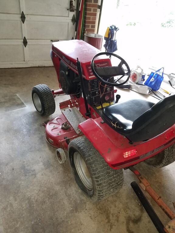

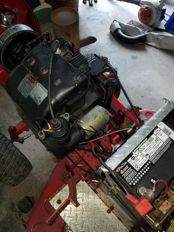

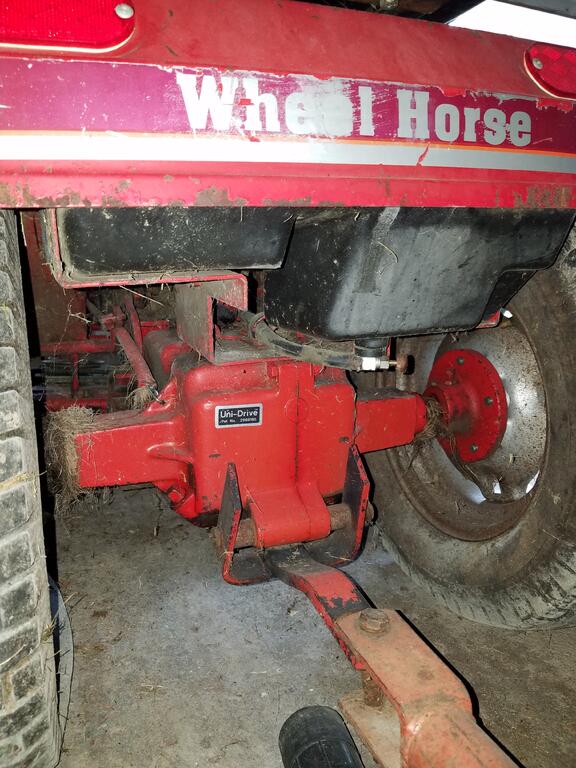

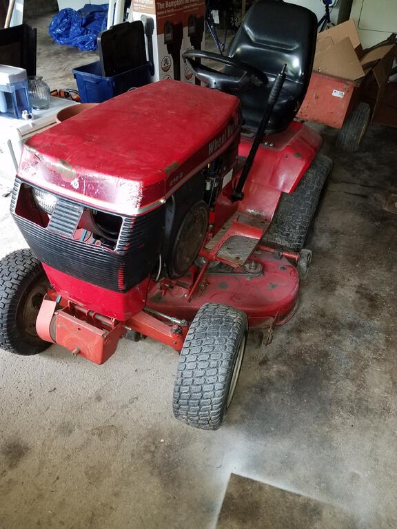

Mustang67ford 234 #1 Posted March 12, 2022 Decided to start a restoration tread on the 86 414-8 I'm redoing. Picked it up around october 2021 from somebody I know that was moving after it sat for about a year. They were the original owner and always kept inside. It ran and cut, but decided to fix it up a little. What a small project turned into more than expected. But on the home stretch now. Starting with pics as it sat before it was brought home. 2 Share this post Link to post Share on other sites

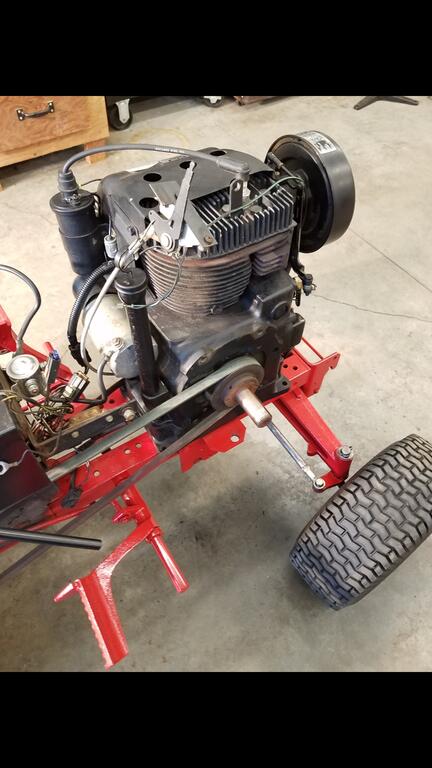

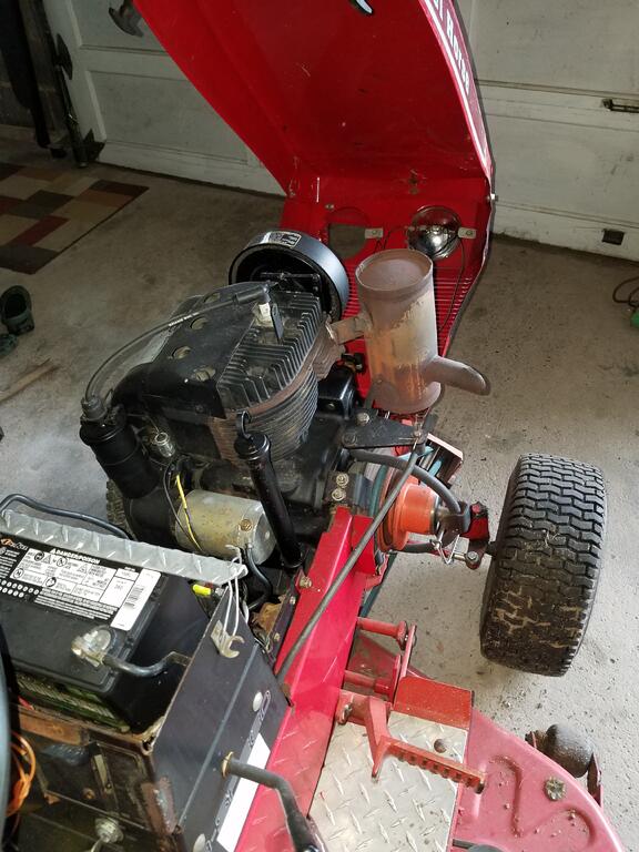

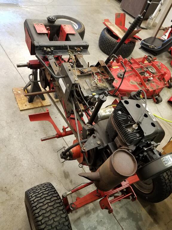

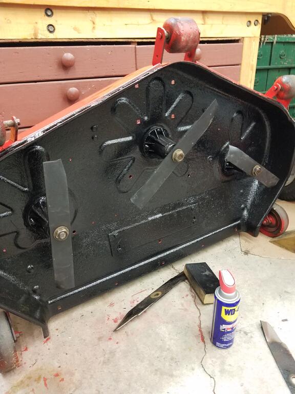

Mustang67ford 234 #4 Posted March 12, 2022 Restoration underway.. 2 Share this post Link to post Share on other sites

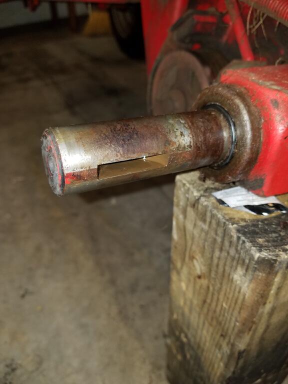

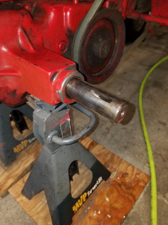

Mustang67ford 234 #5 Posted March 12, 2022 Hubs removed 3 Share this post Link to post Share on other sites

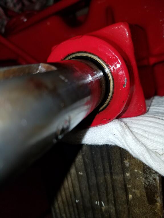

Mustang67ford 234 #6 Posted March 12, 2022 New axle seals installed 4 Share this post Link to post Share on other sites

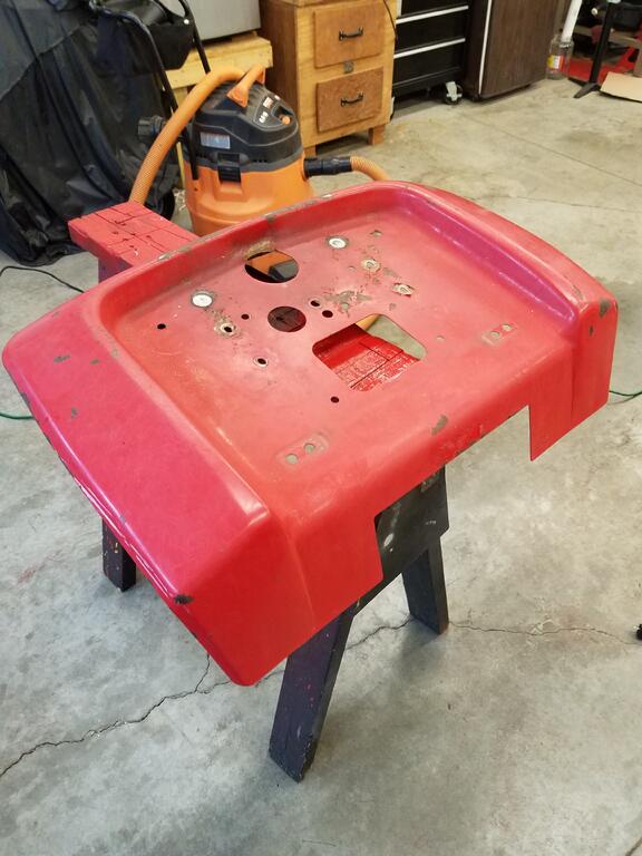

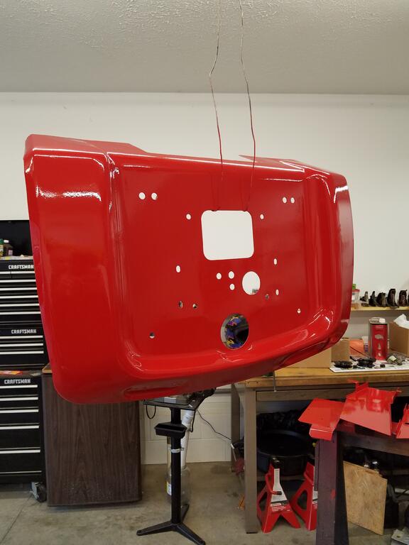

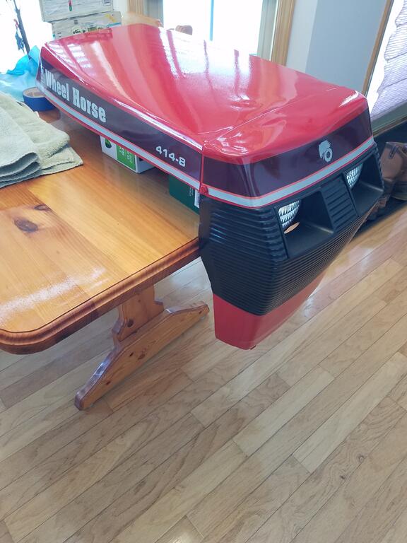

Mustang67ford 234 #7 Posted March 12, 2022 Hood redone 7 Share this post Link to post Share on other sites

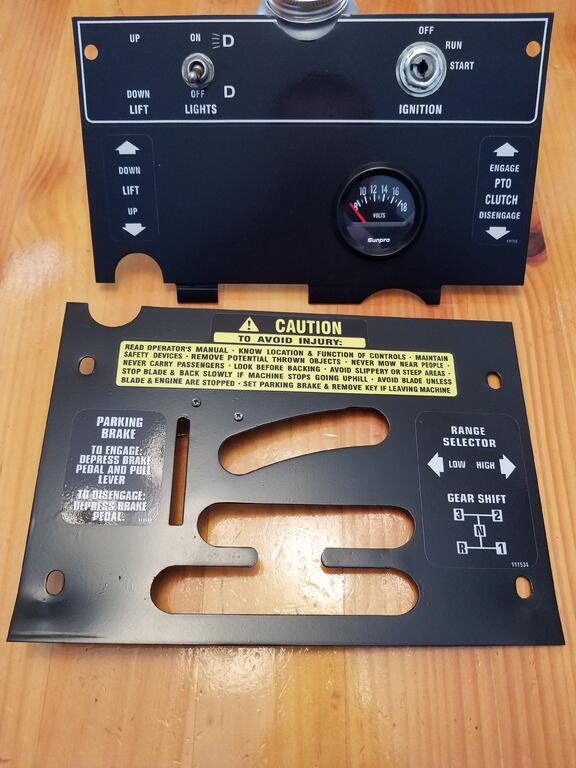

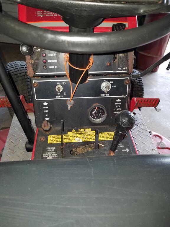

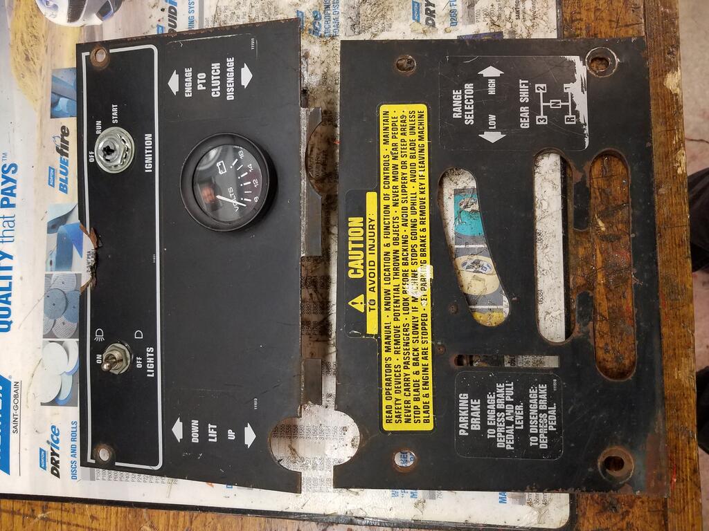

Mustang67ford 234 #8 Posted March 12, 2022 Instruments redone 6 Share this post Link to post Share on other sites

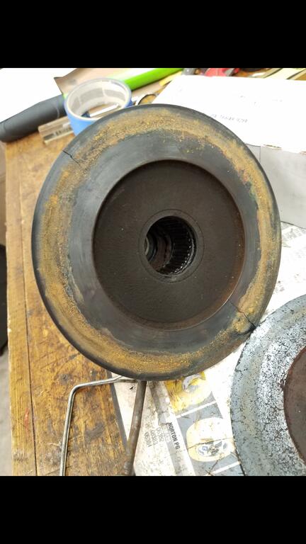

Mustang67ford 234 #9 Posted March 12, 2022 Mule drive redone 6 Share this post Link to post Share on other sites

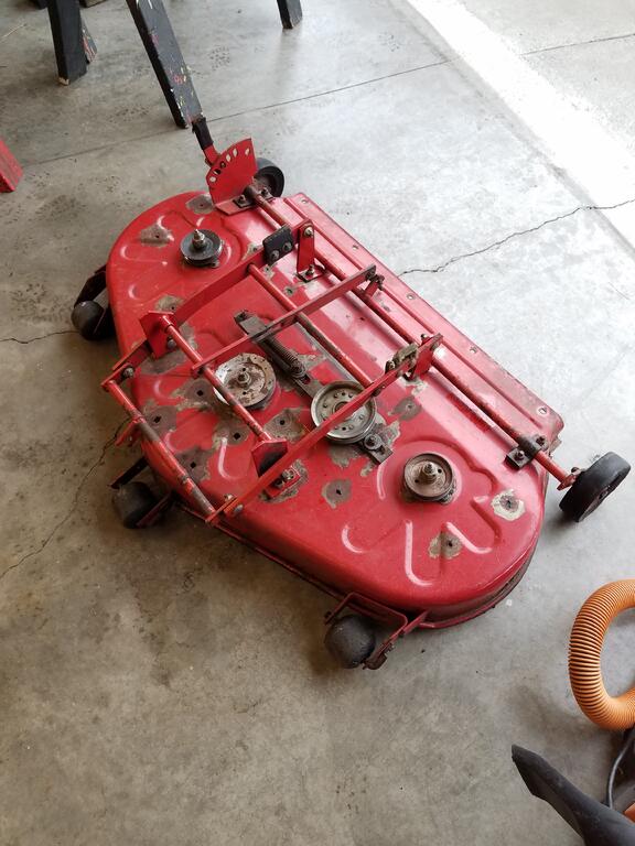

Mustang67ford 234 #10 Posted March 12, 2022 Sheetmetal underway 7 Share this post Link to post Share on other sites

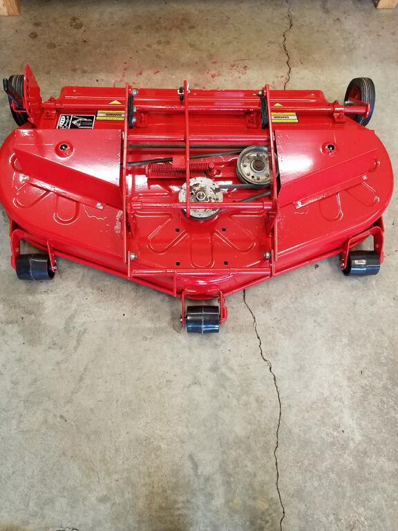

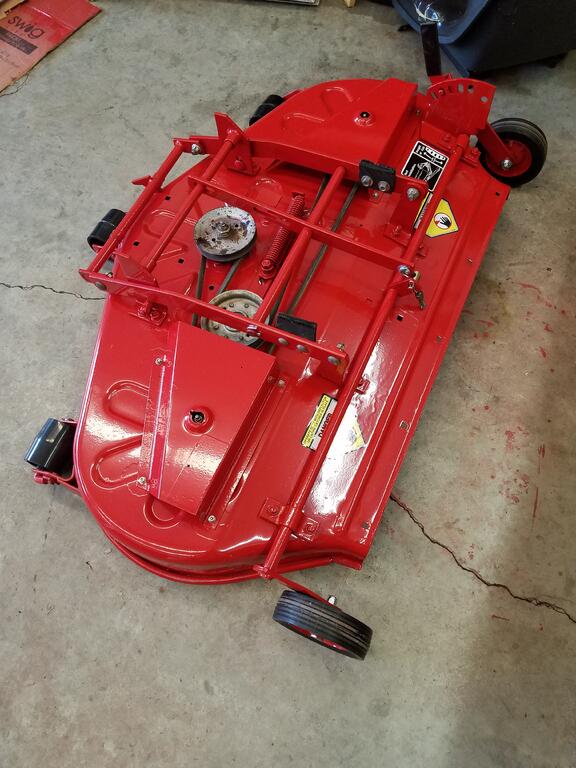

Mustang67ford 234 #11 Posted March 12, 2022 Deck work underway 5 Share this post Link to post Share on other sites
Mustang67ford 234 #12 Posted March 12, 2022 Deck done 4 Share this post Link to post Share on other sites

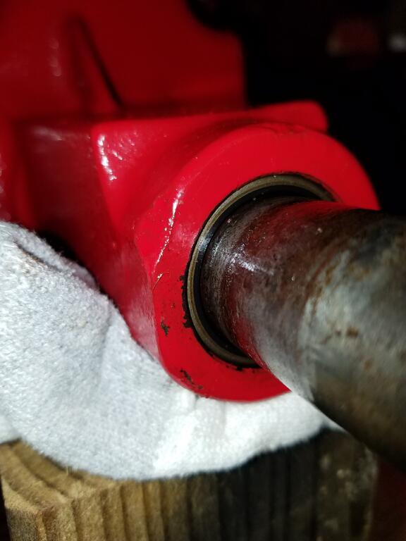

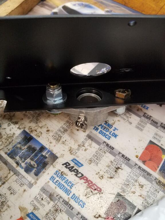

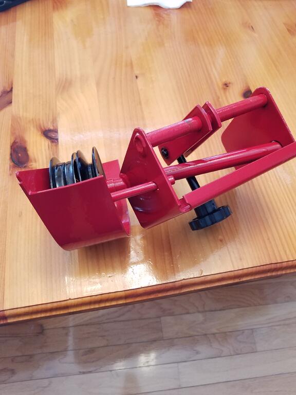

Mustang67ford 234 #13 Posted March 12, 2022 (edited) New beefed up steering thru the dash with dry sleeve bearing and thrust washers and thrust bearing at the collar. Ready for assembly. Thanks to Eric Friedrichsen as his post on the dry bearing help here. I decided to put the bearing under the lip and notched the nut for the circuit board. Edited March 12, 2022 by Mustang67ford 4 2 Share this post Link to post Share on other sites

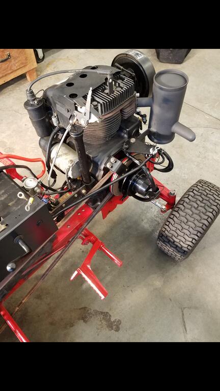

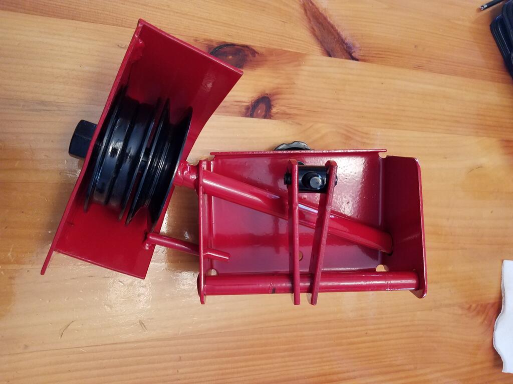

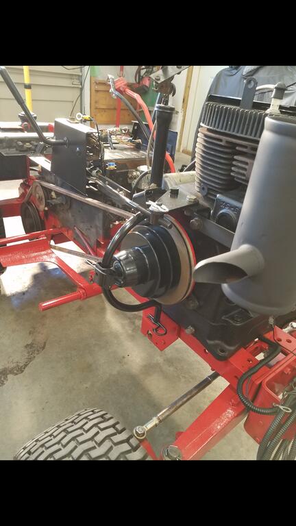

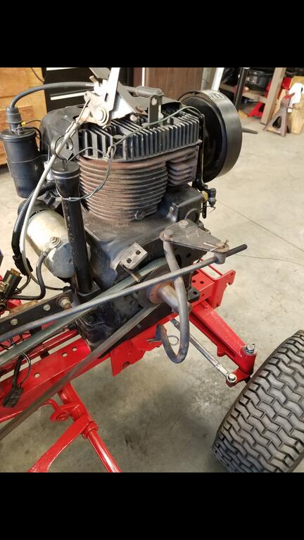

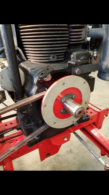

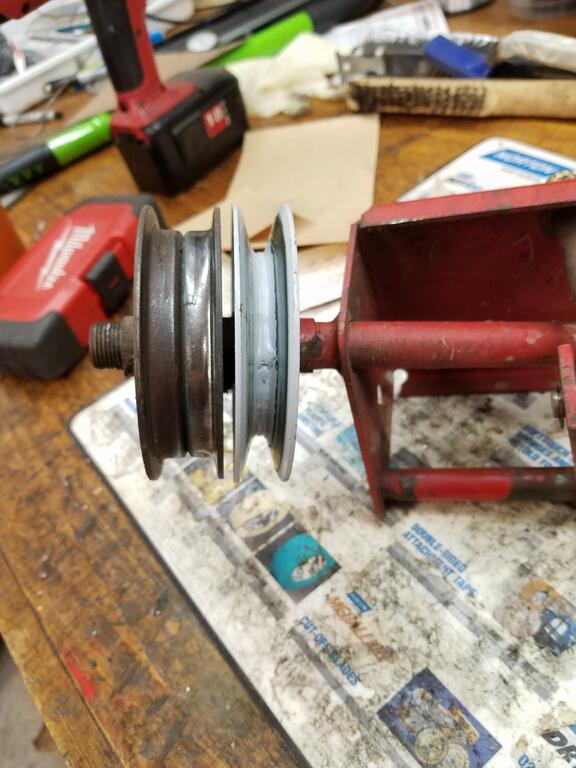

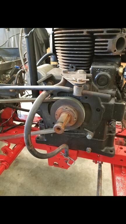

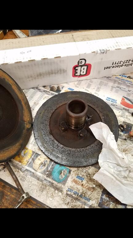

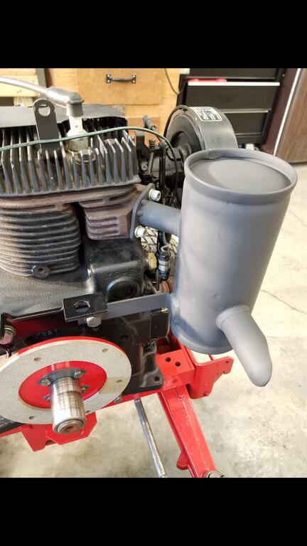

Mustang67ford 234 #14 Posted March 12, 2022 (edited) Replaced pto drum, clutch disk, and exhaust. Linkage redone. Edited March 12, 2022 by Mustang67ford 5 3 Share this post Link to post Share on other sites

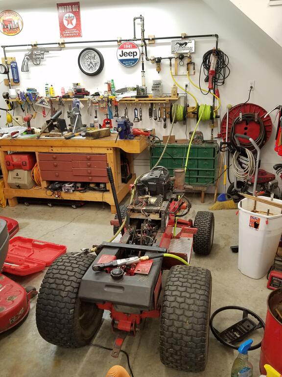

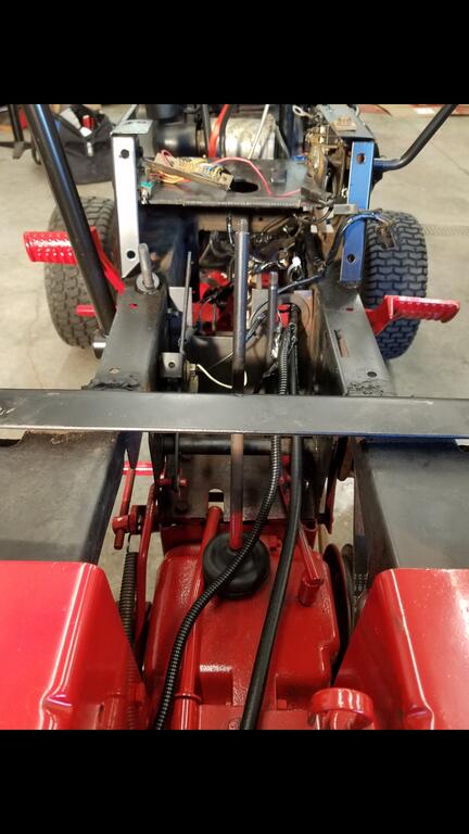

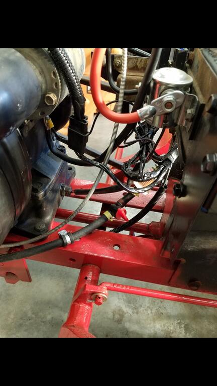

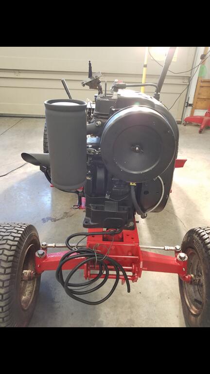

Mustang67ford 234 #17 Posted March 12, 2022 Back to a rolling chassis. Electrical all checked and fuel line replaced. Lots of other parts replaced including lower steering block. On the home stretch now. 5 3 Share this post Link to post Share on other sites

ri702bill 8,997 #19 Posted March 13, 2022 13 hours ago, Mustang67ford said: Lots of other parts replaced including lower steering block. Were the ears broken off?? If so, it's a bit late now, but check the four frame plate holes where the Unidrive bolts on for cracks. Hope it does not look like this .... 1 Share this post Link to post Share on other sites
squonk 42,585 #20 Posted March 13, 2022 New bigger cables! NICE! 1 Share this post Link to post Share on other sites
Mustang67ford 234 #21 Posted March 13, 2022 3 hours ago, ri702bill said: Were the ears broken off?? If so, it's a bit late now, but check the four frame plate holes where the Unidrive bolts on for cracks. Hope it does not look like this .... The steering block where the upper steering shaft goes in to meet the fan shaft. The hole was worn out. I'll have to check the plate you mentioned. I didn't notice anything but I didn't give it a good look either. 1 Share this post Link to post Share on other sites
Mustang67ford 234 #22 Posted March 13, 2022 2 hours ago, squonk said: New bigger cables! NICE! #4 for both + to the relay and - to the starter mounting bolt. Then a ground jumper up to the dash ground. 4 Share this post Link to post Share on other sites

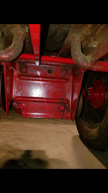

Mustang67ford 234 #23 Posted March 14, 2022 (edited) On 3/13/2022 at 8:43 AM, ri702bill said: Were the ears broken off?? If so, it's a bit late now, but check the four frame plate holes where the Unidrive bolts on for cracks. Hope it does not look like this .... @ri702bill Well I checked mine and its pretty bad. I started a thread on to to see how to go about the repair. That is a show stopper for sure. Edited March 15, 2022 by Mustang67ford 2 Share this post Link to post Share on other sites
ri702bill 8,997 #24 Posted March 15, 2022 I knew something was going on - the tractor wiggled side to side like an inch worm on uneven terrain - only one of the four screws had a solid hold!! 1 Share this post Link to post Share on other sites
Mustang67ford 234 #25 Posted March 20, 2022 Here is what I found when I checked my F plate. 2 Share this post Link to post Share on other sites
