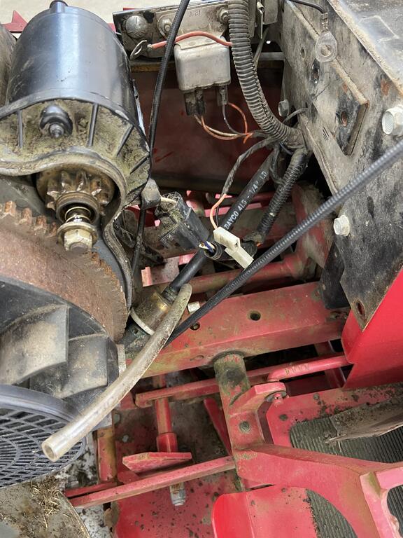

Fishroe 261 #1 Posted March 10, 2022 Looking at the kohler magnum manual it shows a 1 post solenoid. This tractor has a 2 post. I just bought it not running. Solenoid was not mounted just hanging by 1 cable. Are these 2 factory connectors for the solenoid. Just making sure. Looks like they are my 86 414-8 has a 1 post. The 89 has a regulated charging system. Different type starter on the 89. Also what is that tube by the fuel filter for. It’s stuck in a hole in the frame Share this post Link to post Share on other sites
pfrederi 18,343 #2 Posted March 11, 2022 All solenoids will have two big posts. Some have one small post some two. Hard to tell if you solenoid is original (guessing not.) One small terminal feed power to trigger the solenoid. the second one may be a ground or maybe a bypass of a ballast resister ((some older car types especially Fords), Look closely one small terminal should show a + the other may have no mark or an "I". No mark make sure it is grounded and "I" leave it unconnected.... 2 1 Share this post Link to post Share on other sites
Fishroe 261 #4 Posted March 11, 2022 I found an electrical diagram of the tractor in the dymistification dept. not real good at reading those but it looks like it’s supposed to be a 2 post. Not getting voltage from the ignition switch took it off and all the resistance checks were good. Switch actually looked fairly new. Jumped the solenoid to check starter. Turned engine over good. Only did it for a second or two. Time to start backtracking safety switches and wiring i don’t believe the throttle shaft even has a bushing in the top it’s so much slop. The little shock cylinder for the seat don’t work. This thing is a frickin nightmare thanks for the info fellas aint it pretty 😂 Share this post Link to post Share on other sites

gwest_ca-(File Mod) 11,252 #7 Posted March 11, 2022 The plastic tube likely plugged into a nipple to drain a plastic battery tray under the battery. 3 Share this post Link to post Share on other sites

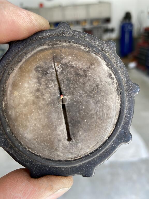

Fishroe 261 #11 Posted March 11, 2022 Update I’ve got the starter working with the key switch just had to spray the wire connectors with brakekleen and air pressure. It does have spark next thing after breakfast is push it out of garage and blow off and spray engine down with purple power. Have Yal had any luck freeing up a frozen choke cable. If not, for now I’ll unhook the rod and work it by hand. Will change fuel filter and clean gas tank. Fuel valve feels pretty good. I don’t know if it will run. Top of throttle shaft has 3 or 4 millimeters of front to back play. Needs a new gas cap. Of all things to work all the dummy lights work except the low oil one when you do the test😂😂. Volt meter is working now although reading a little low. Haven’t cleaned those connectors yet. Battery is brand new Motor has wrong plug in it. Champion rj19lm my other 414 uses the H 10 C i’ll check the specs later on this magnum can you buy just the bushing for the carburetor or do you have to buy the whole kit probably better off buying the whole kit anyway parts list Carburetor kit gas cap this cap has the float on it One axle seal that’s leaking pretty bad transmission oil looks a little rough on the dipstick might have to do the flush with kerosene on this one wonder if it’s one place I can get all of these parts do they still sell the shock cylinder for the seat that don’t work either Share this post Link to post Share on other sites
WHX?? 50,782 #12 Posted March 11, 2022 5 minutes ago, Fishroe said: wonder if it’s one place I can get all of these parts Probably not but gas cap can be had here... https://www.capsandgauges.com/main.sc and the seat shock might be this one but check the part No. https://www.capsandgauges.com/main.sc He will also have the seal but if the seal is leaking chance the outer bearing maybe suspect so check that. Share this post Link to post Share on other sites
Fishroe 261 #13 Posted March 11, 2022 I hope not on the bearing I don’t want to have to go in transmission 😞😞 Share this post Link to post Share on other sites
WHX?? 50,782 #14 Posted March 11, 2022 45 minutes ago, Fishroe said: I hope not on the bearing Share this post Link to post Share on other sites
