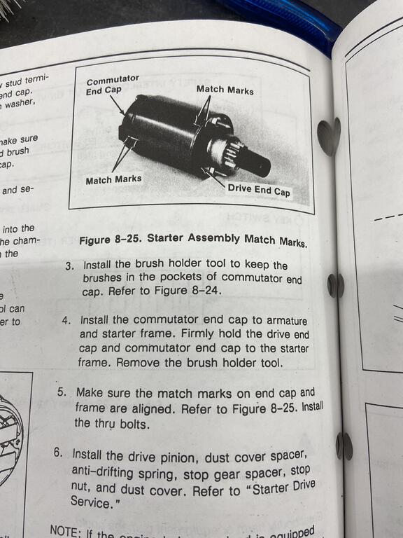

there is one thing I would like to get clarified
min the kohler service manual it says to align both end caps to the corresponding marks on the starter frame. I see the marks on the frame but can’t tell where they are on the caps or does it really matter. I know, I should’ve paid attention to how they were before taking apart
Handy Don
It matters because it aligns the brushes in the end cap with the wire windings in the body AND it aligns the thru-bolt holes!

So both end caps can go on 2 ways
will either way work
Fishroe
I’m going to cut 4 pieces of sheet metal to hold the brushes down, it’s the end cap positions I want to get right. Each end cap can go 2 way’s because of the bolt holes lining up
It has been several years since I did one of these. The end cap for the brushes has a small keyway which should line up to a key in the body. the Bendix end cap can go either way.

I finally figured it out
The frame on mine does have a notch on both ends. If I had sprayed penetrating oil on the bendix I wouldnt have had to take starter off
