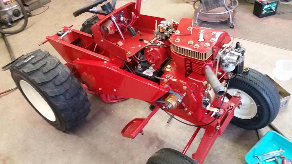

Cee245 823 #10 Posted March 9, 2022 (edited) I can say I painted the engine tins on my 416 over 10 years ago with rustoleum self etching primer and regular black paint. It still looks good. I didn't paint the insides because there was no rust or deep scratches. Edited March 9, 2022 by Cee245 Pic 6 1 Share this post Link to post Share on other sites

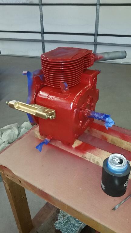

WHX?? 50,728 #22 Posted March 10, 2022 (edited) On 3/9/2022 at 5:58 AM, JoeM said: Never paint the cooling fins just wire brush clean. Thats what I was always told as well. Also never paint heads . Which before I was told that by @Achto I had painted two of them. this one got the black out treatment in high heat with the VHT flame proof on the head. No issues so far. Second pic was Ford engine red with just even regular no heat gold on the the head. Hey I thought it would look cool. Fingered I have issues just pop back off & re-blast and put back on raw. Blackened around the exhaust but no other issues. The Ford red is really close to Regal. Oh and BTW @Brockport Bill I also do prime (self etch) and paint the insides of tins. Regular Regal unless Dan has a can of Van Sickle open. No issues. Edited March 10, 2022 by WHX?? 2 1 Share this post Link to post Share on other sites
