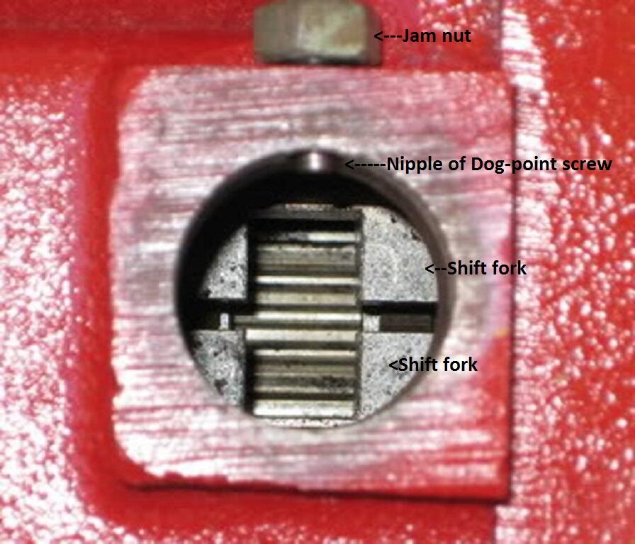

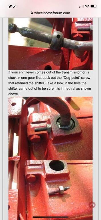

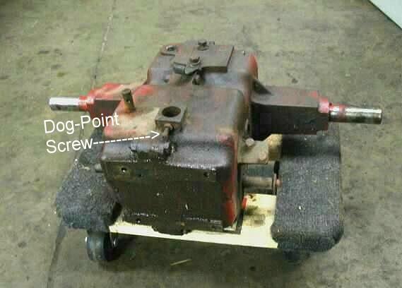

daveoman1966 3,768 #2 Posted March 7, 2022 If you are 'switching' gears on-the-fly, THAT is a NO NO. Every gear you select MUST be from a standing STOP. These are NOT synchromesh transmissions and on-the-fly gear shift is highly detrimental. The whole shifting problem MAY be at the shift forks, which is adjusted by the DOG-POINT screw where the shift lever fits into the transmission. Have a look at this pic...may help. 5 Share this post Link to post Share on other sites
TC10284 111 #3 Posted March 7, 2022 (edited) Thanks for this. I'll check the dog-point screw. Also, I never, ever switch while moving. Only at a standstill. What I meant there was that sometimes I've had to "rock" the tractor (and some others I own) back and forth sometimes using my bodyweight to get it to go into gear more easily. Edited March 7, 2022 by TC10284 Share this post Link to post Share on other sites
