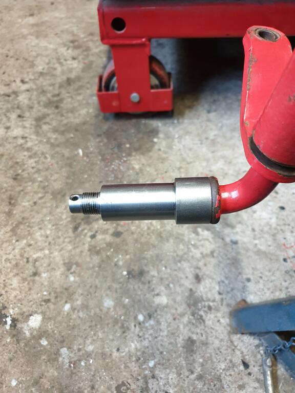

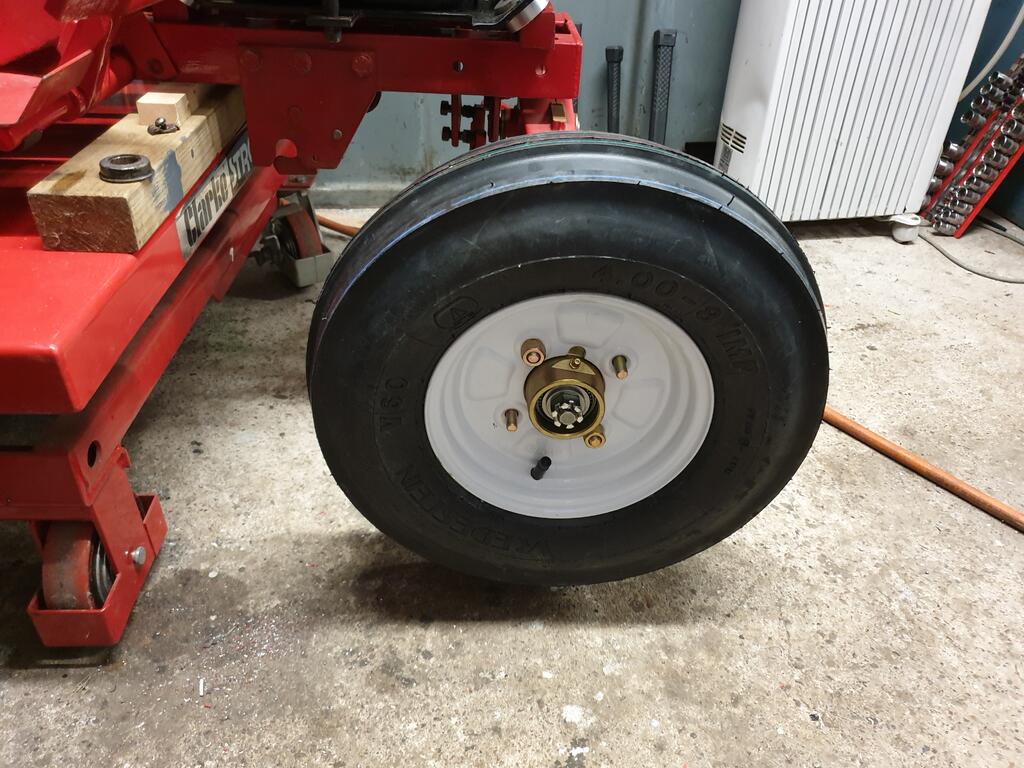

Mickwhitt 4,400 #3 Posted March 2, 2022 I took the plunge and replaced my front stub axles with one inch ones made for trailer hubs, now I have a pair of trailer hubs on there and four stud mounting front wheels. It was a pretty straight forward job to do and I'm very happy with the results. 3 7 Share this post Link to post Share on other sites

peter lena 8,408 #9 Posted March 2, 2022 @Mickwhitt nice upgrade on that mick ! get some good lubricant to keep that area moving easily , pete 1 Share this post Link to post Share on other sites
