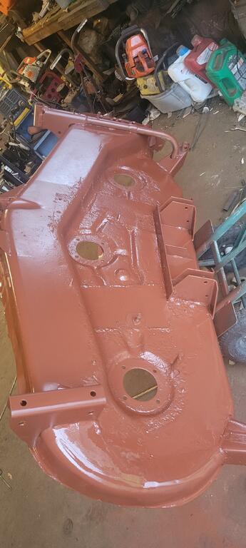

RED-Z06 2,720 #8 Posted February 27, 2022 Waiting on a new 3m respirator and hardener but i have everything else...its primed at least. This deck was...rough 2 Share this post Link to post Share on other sites

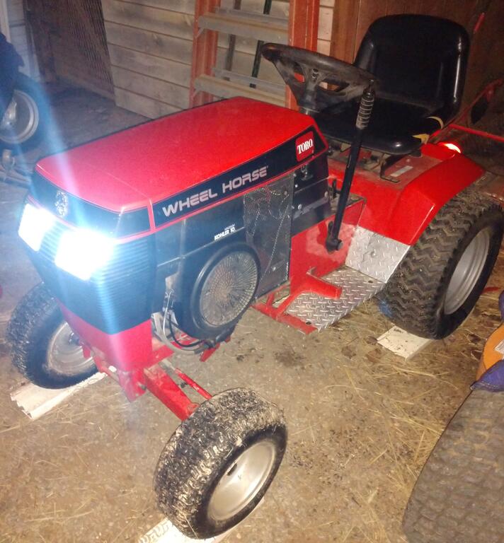

kpinnc 18,915 #9 Posted February 28, 2022 (edited) I painted this tractor 20+ years ago with automotive paint over rattle can red oxide Rust-Oleum primer. None of the paint ever bubbled from underlying rust, and even typical scratches don't rust. Even in the environment here where items stored under a shed "sweat" from the humidity year round, I'm a believer in this primer. Even when used over light surface rust, it works well. Edited February 28, 2022 by kpinnc 3 1 1 Share this post Link to post Share on other sites

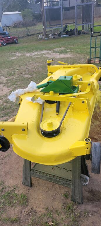

RED-Z06 2,720 #10 Posted March 4, 2022 Turned out nice. Thanks for all the advice. Share this post Link to post Share on other sites
