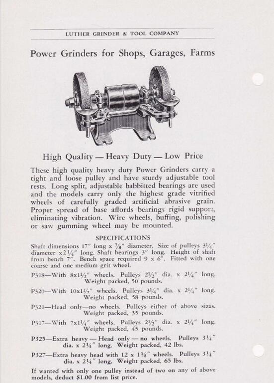

formariz 12,352 #12 Posted February 13, 2022 12 hours ago, Mike'sHorseBarn said: Anyone know anything about old tools? My wife's grandfather passed away in January and nobody wanted it so I thought it was too cool to go in a dumpster. I couldn't find any names on it as far as who made it, but it's really heavy! The motor says wards power craft, but that doesn't mean the grinder was made by them though. Was it originally made for a flat belt? Any help would be appreciated! I only came across once before one exactly like yours with the same motor. That motor is a repulsion motor. It will last forever. Not too many Manufacturers made that type of grinder and it is from the early 1900s. I have never been able to pinpoint the manufacturer for that specific one. However upon cleaning it there has to be some markings on it that will help. It was designed for both a flat belt or a V-belt. That is a heavy duty machine and it will have Babbitt bearings. I have seen similar ones in very old blacksmith shops. What did your wife's grandfather do? Here is a similar one made by Luther Grinder Manufacturing Co.. 1 Share this post Link to post Share on other sites
