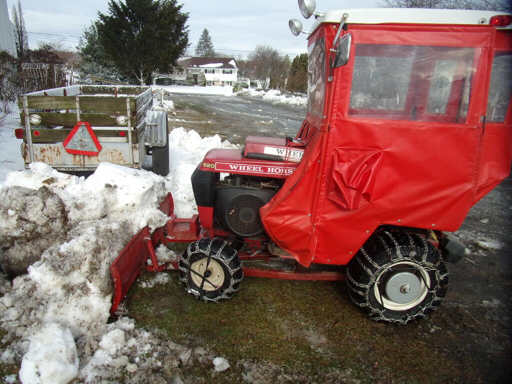

Ed Kennell 43,783 #2 Posted February 11, 2022 (edited) For me, the two link Vee Bar chains on turf tires work best on packed or loose snow, ice, mud, grass, and gravel. Basiccly any surface they can penetrate to get a bite. On my steep paved driveway, the rubber chains on turfs work best. Steel has poor traction on a smooth hard paved surface. Just my experience. I have never used them, but I hear the X type cross chains are very good and ride better than the = cross chains. Edited February 11, 2022 by Ed Kennell 6 Share this post Link to post Share on other sites

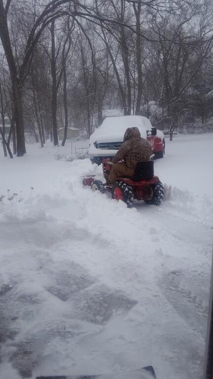

DougC 2,643 #4 Posted February 11, 2022 Iowa gets ice and then snow and normally high wind forming large drifts. I use a 520H with turf tires and rear tire chains and an Original Snow Cab to stay warm and cozy. I just moved 14.5 inches of snow last snow event without any problems. Just my 2 cents. 1 2 Share this post Link to post Share on other sites

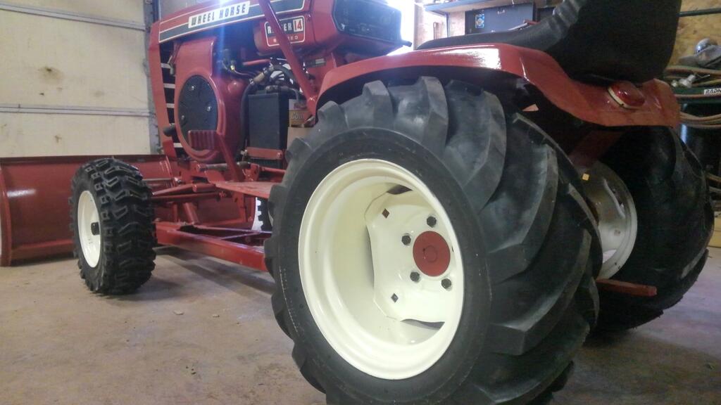

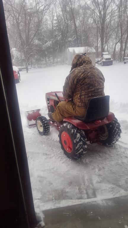

Rusty Tinsnips 477 #15 Posted February 18, 2022 These worked really good a few days ago and again today with no slipping. The ride is terrible but I like the way they look. 1 Share this post Link to post Share on other sites
TJ5208 1,841 #16 Posted February 18, 2022 6 minutes ago, Rusty Tinsnips said: These worked really good a few days ago and again today with no slipping. The ride is terrible but I like the way they look. What brand of tires are those? 1 Share this post Link to post Share on other sites
Rusty Tinsnips 477 #17 Posted February 18, 2022 3 minutes ago, TJ Salyers said: What brand of tires are those? Deestone 100A4 "Super Extra Grip" "Flota Tire" 23x10.5 6pr 1 Share this post Link to post Share on other sites

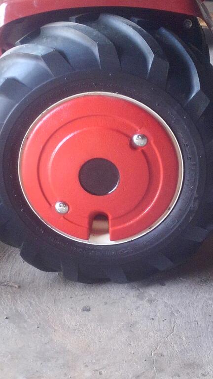

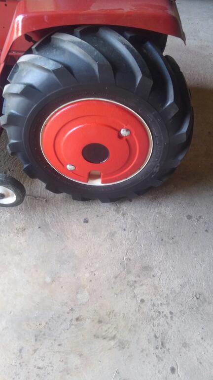

TJ5208 1,841 #18 Posted February 18, 2022 Just now, Rusty Tinsnips said: Deestone 100A4 "Super Extra Grip" "Flota Tire" 23x10.5 6pr Do you have any more pictures of them? 1 Share this post Link to post Share on other sites
Rusty Tinsnips 477 #19 Posted February 18, 2022 Just now, TJ Salyers said: more pictures 2 1 Share this post Link to post Share on other sites
TJ5208 1,841 #20 Posted February 18, 2022 Just now, Rusty Tinsnips said: Those look like some deep lugs. 1 Share this post Link to post Share on other sites
