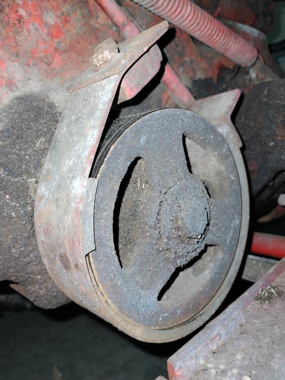

Achto 28,802 #2 Posted February 10, 2022 Is there any pad left on the brake band? Can you get a picture from the side? 1 Share this post Link to post Share on other sites
TJ5208 1,824 #3 Posted February 10, 2022 Just now, Achto said: Is there any pad left on the brake band? Can you get a picture from the side? Just give me a sec I'll go get one. Share this post Link to post Share on other sites
TJ5208 1,824 #4 Posted February 10, 2022 Here you go. 1 Share this post Link to post Share on other sites
Achto 28,802 #5 Posted February 10, 2022 Looks like there is pad yet. Set the parking brake and try pushing the tractor. Watch the brake hub and see if it is tuning. If it's not turning but the tractor moves, then you may have a sheared key on the brake hub. 3 Share this post Link to post Share on other sites

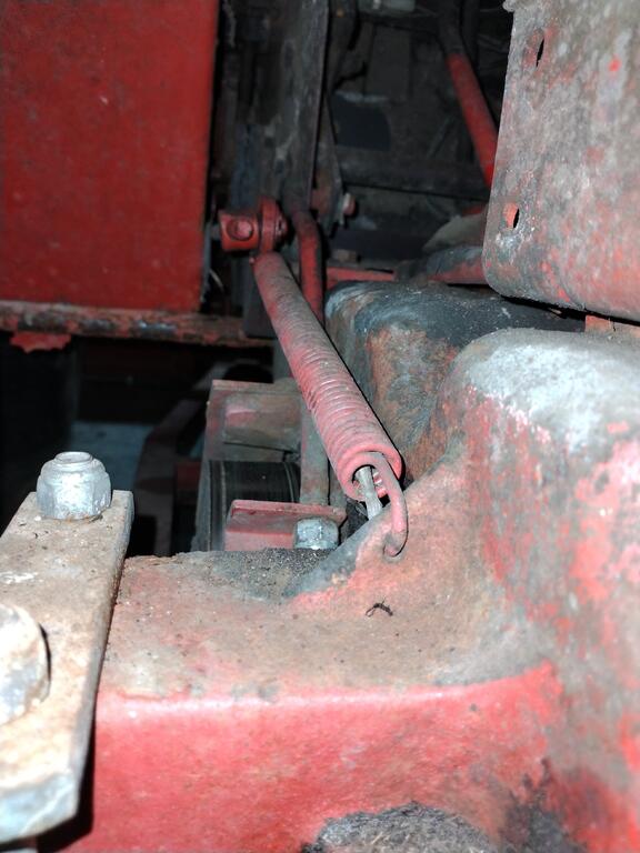

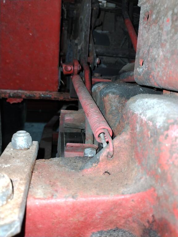

Achto 28,802 #8 Posted February 10, 2022 Is the band opening and closing with the brake peddle? 2 Share this post Link to post Share on other sites
TJ5208 1,824 #9 Posted February 10, 2022 Yes the band seem to tighten on the drum. 1 Share this post Link to post Share on other sites
TJ5208 1,824 #10 Posted February 10, 2022 VID_20220210_070731.mp4 1 1 Share this post Link to post Share on other sites
TJ5208 1,824 #11 Posted February 10, 2022 (edited) But the tractor won't stop. Edited February 10, 2022 by TJ Salyers Share this post Link to post Share on other sites
Achto 28,802 #12 Posted February 10, 2022 Seems to be operating correctly. The pad may be warn down too far for the stock adjustments. Remove the adjustment nut and place a larger nut on that will slide over the rod. Put the original adjuster nut on and adjust it again. The larger nut will just be there to take up some space. 4 Share this post Link to post Share on other sites

Achto 28,802 #16 Posted February 10, 2022 1 minute ago, TJ Salyers said: Could I leave that nut there if it stopped the tractor Yes, the nut will be used as a spacer. The original nut will not thread on any further. Right? Put a larger nut in front of it as a spacer. 2 Share this post Link to post Share on other sites

Achto 28,802 #20 Posted February 10, 2022 Just now, TJ Salyers said: Just didn't know if it's going to hurt anything. Will be just fine. Just know that some where down the line you will want to get a new brake lining. It's a temporary fix that will buy you a lot of time. 2 Share this post Link to post Share on other sites
